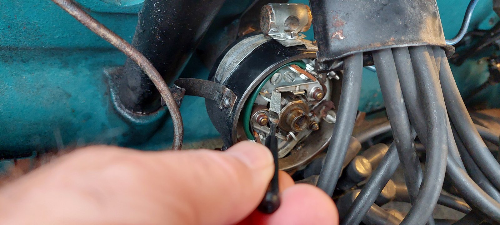

    Lumpy bumpy bad connection has returned!
    I hate fault finding intermittent problems.

    Found it.
    The trailing points had come slightly undone at the bolt that holds the spring on to the insulator.
    Ignition stays where I put it now.
    Needs a bit of a tune-up now, having taken it apart the fine adjustment is all out, but unsurprisingly, it runs much better now.

    I got a decent fine file (no idea where my old one went, it was on my workbench before the storm, probably in Kansas now).
    Carefully filing the points so the faces meet at the same angle and make better contact. Cleaning them on the bench left them at a slight angle which made for a poorer connection.
    Reset the gaps, pulled the plugs and correctly gapped them (think they'd been bouncing about in the boxes), set the timing and idle mix.
    It's a satisfying engine to get dialed in right.
