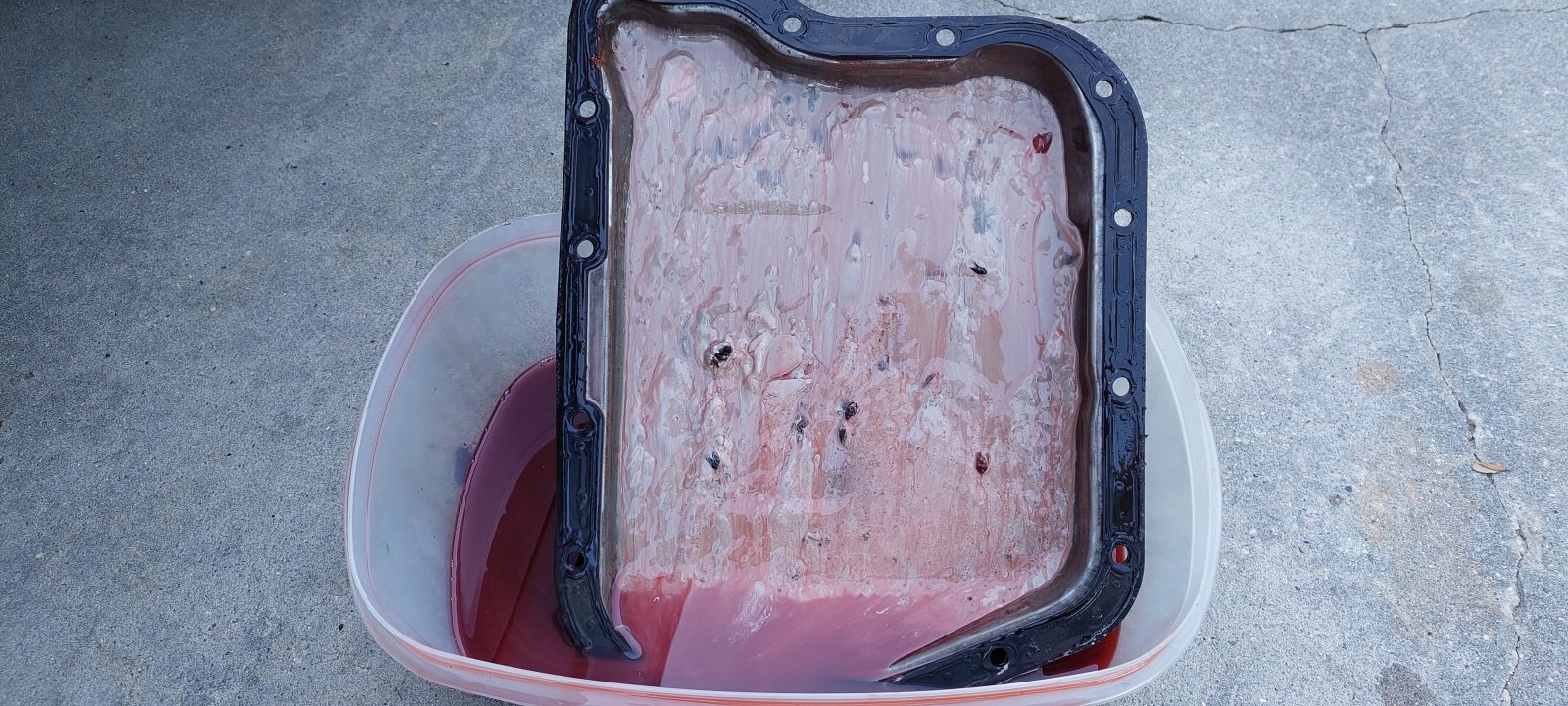

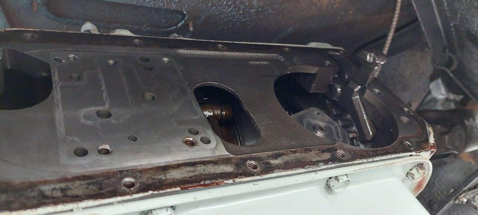

  7. PhilA
    Joined: Sep 6, 2018
    Posts: 2,104
    PhilA
    The valves themselves are steel, within an aluminum body. Pretty normal, however that doesn't appear to have really been the problem. The issue was the oil I had was too light a weight, getting too thin with too little heat in the transmission.

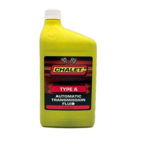

  8. Crusty Chevy
    Joined: Aug 28, 2007
    Posts: 1,322
    Crusty Chevy
    This is what I have been using in our 56 Pontiac Hydro, much better than the synthetic ATF we had in before that caused all sorts of terrible shifting issues. It literally shifts like a new old car now. $92 a case on Amazon.

  9. PhilA
    Joined: Sep 6, 2018
    Posts: 2,104
    PhilA
    My only concern is that says "top up only, not for fill".

  10. Crusty Chevy
    Posts: 1,322
    Crusty Chevy
    and the Mercron said "backwards compatible". I had issues with it too so was willing to try anything.

  11. PhilA
    Joined: Sep 6, 2018
    Posts: 2,104
    PhilA
    Yeah, DEXRON also.
    This new oil I have makes it better, but it still needs to go up a grade because it's going to be too thin in summer.
