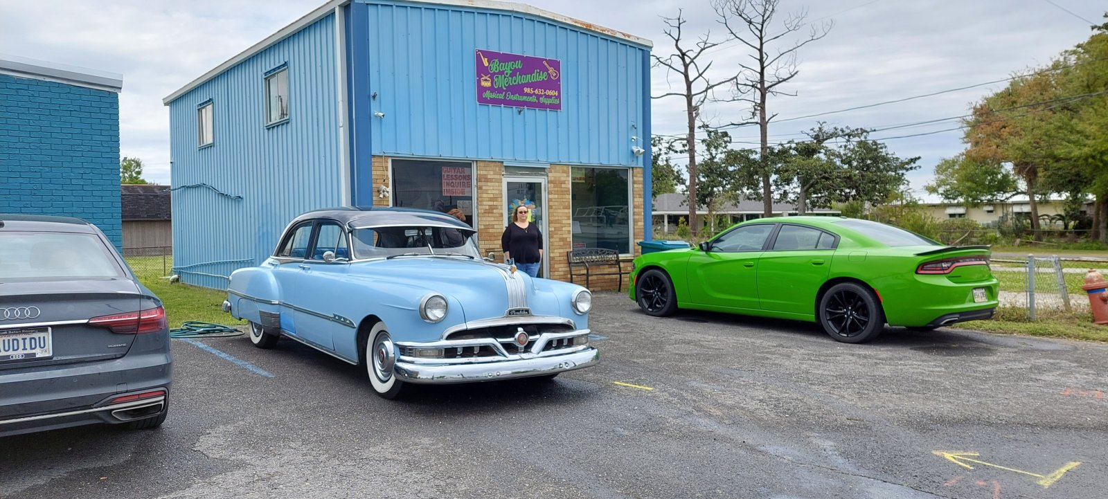

    Was out and about again today. Walmart trip, on the way home had people slowing down as they passed to take photos.
    Still getting used to that, even today.
    Car's definitely running better for having the timing adjusted and the economy is a little better.
    Can just about keep up with modern traffic on the highway. Just about.
    Phil
