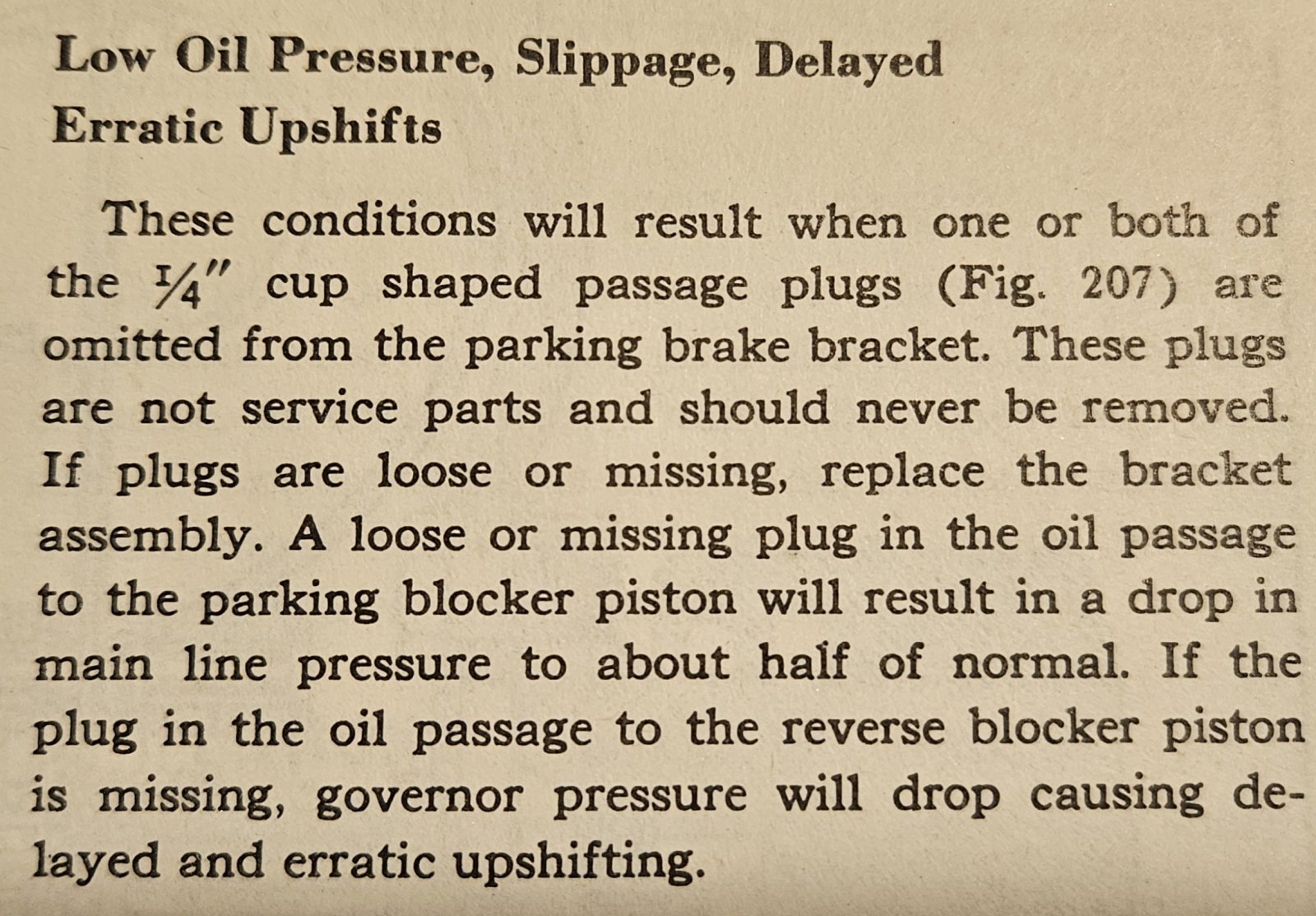

    I had another gearbox thought tonight; this morning was real cool and the gears changed ratio beautifully.
    Tonight the weather is warm and it's acting the fool. Occasionally shifts perfectly, sometimes not. Same pattern as before (1-3 then delayed 3-4) so I decided to rule out the TV sticking. I set the throttle linkage to gearbox tighter so the TV would never bottom out.
    No joy, but the up changes were later, as expected.
    So I revisited the diagnosis portion of the manual again, reread.
    I read a paragraph I had previously skipped over, for reasons unknown.
    I think the "low oil pressure" part made me ignore it, my line pressure is excellent.
    The governor plug may be leaking though. I did replace the rings on the governor shaft, and the governor itself, the valve block but never the parking blocker ***embly.
    I'm going to pull it apart and check that little 1/4" bung isn't leaking or missing.
    Phil

    Went digging through old photos to see if the plugs look intact.
    Best picture I have and it looks inconclusive.
    Dis***embly to follow.

    I checked the plugs, and they're both good.
    The governor transfer sleeve less so.
    So I got happy with my hones.
    It's it better? Uh. Kinda? Not really? Hard to tell.
    I might not have it completely central either. It's not binding though, that I checked.
    Reverse lockout doesn't work. That's a clue though. The thing might just be leaking, it's hard to tell because there's a double crimped pin holding it in which I cannot remove.
    Phil

    Cooler day today (74°), went for a drive this morning and it changed smooth like ****er until the oil warmed up and then it went back to normal.
    So it's definitely a control system leak down problem. Just a case of where from.
    Pretty sure the reverse lockout on this not working has something to do with it.
