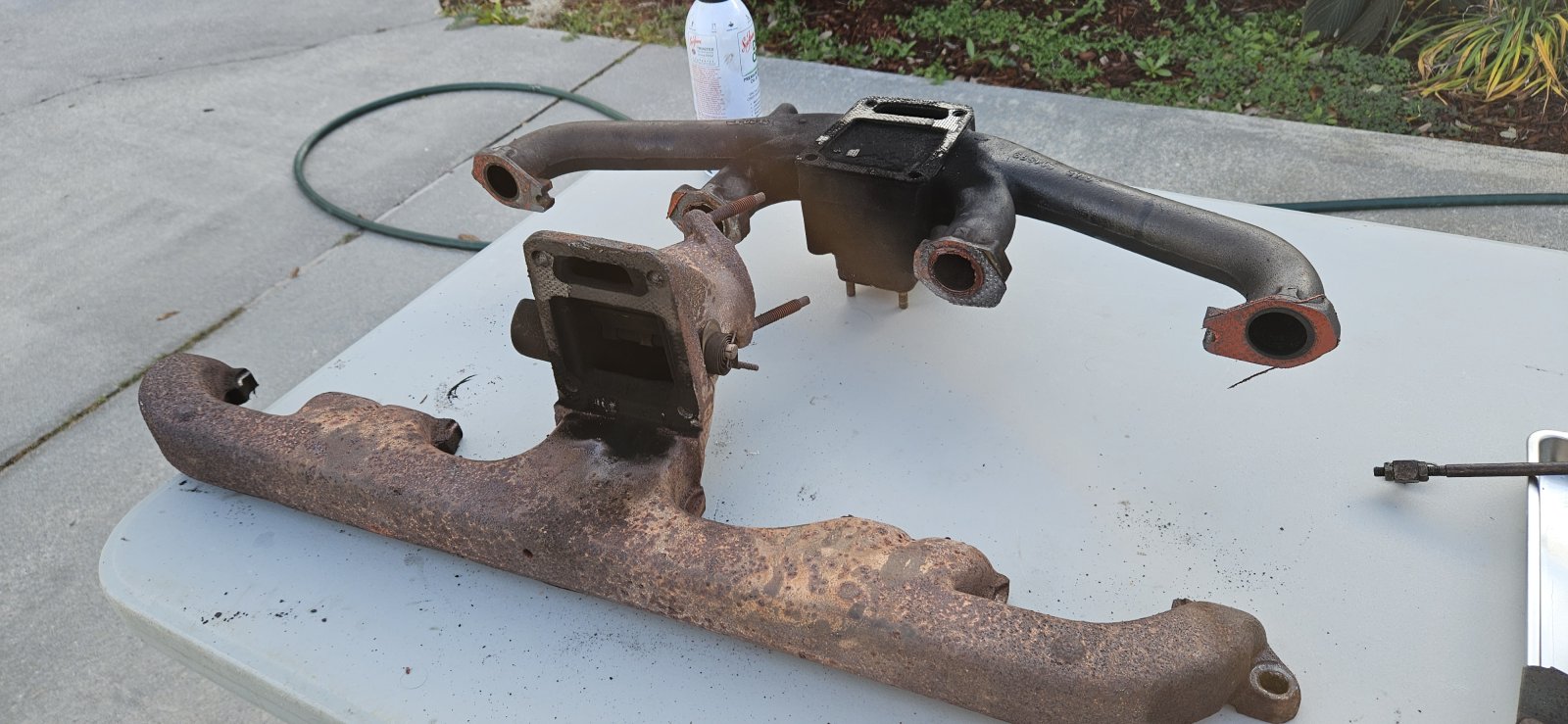

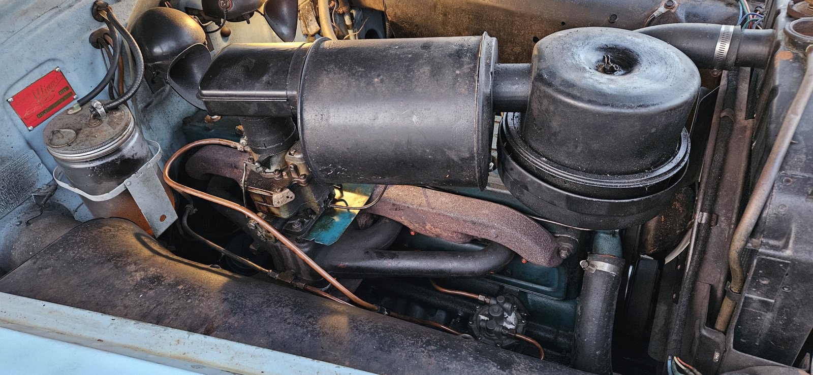

    Actual work on the car today. Exhaust had been getting chattery, the weather was pleasant enough today to actually attempt to accomplish something.
    Set the table up and started placing parts of the car on it.
    Pulled the manifolds off. Still looking pretty clean, but the culprit was visible.
    Yup. That'll have been leaking, then.
    Split everything down, cleaned it up, made new gaskets and re***embled.
    Got it all put back together just as the light was fading.
    A quick drive shows it's nice and quiet again, and running more smoothly now the exhaust is scavenging better at idle.

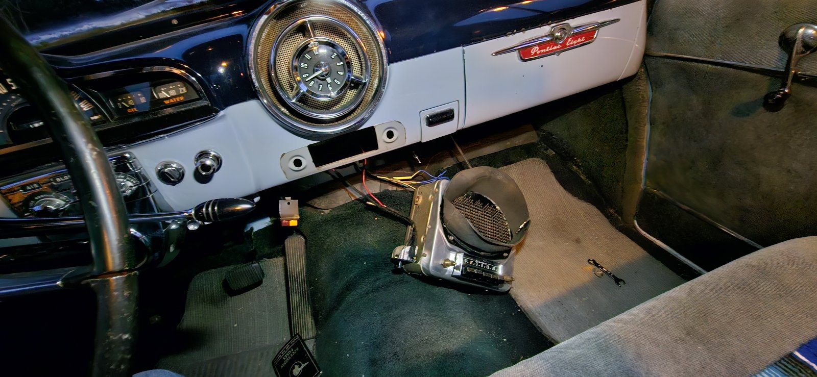

    The radio had become all pops, crackles and distortion. So, I wrangled it out from under the dash. Always an enjoyable* experience.
    Took it apart and checked the output tubes. I think the damp had gotten in and corroded the connections, a typical problem with Loktal tubes.
    That brought the sound back so I sat it on the bench for an hour to test.
    Played well enough, which was good.
    I do think I'll get a solid state ******** for it though, and I'm looking for a replacement loudspeaker that can actually cope with the full output of the amplifier. This one's terrible.
    Phil

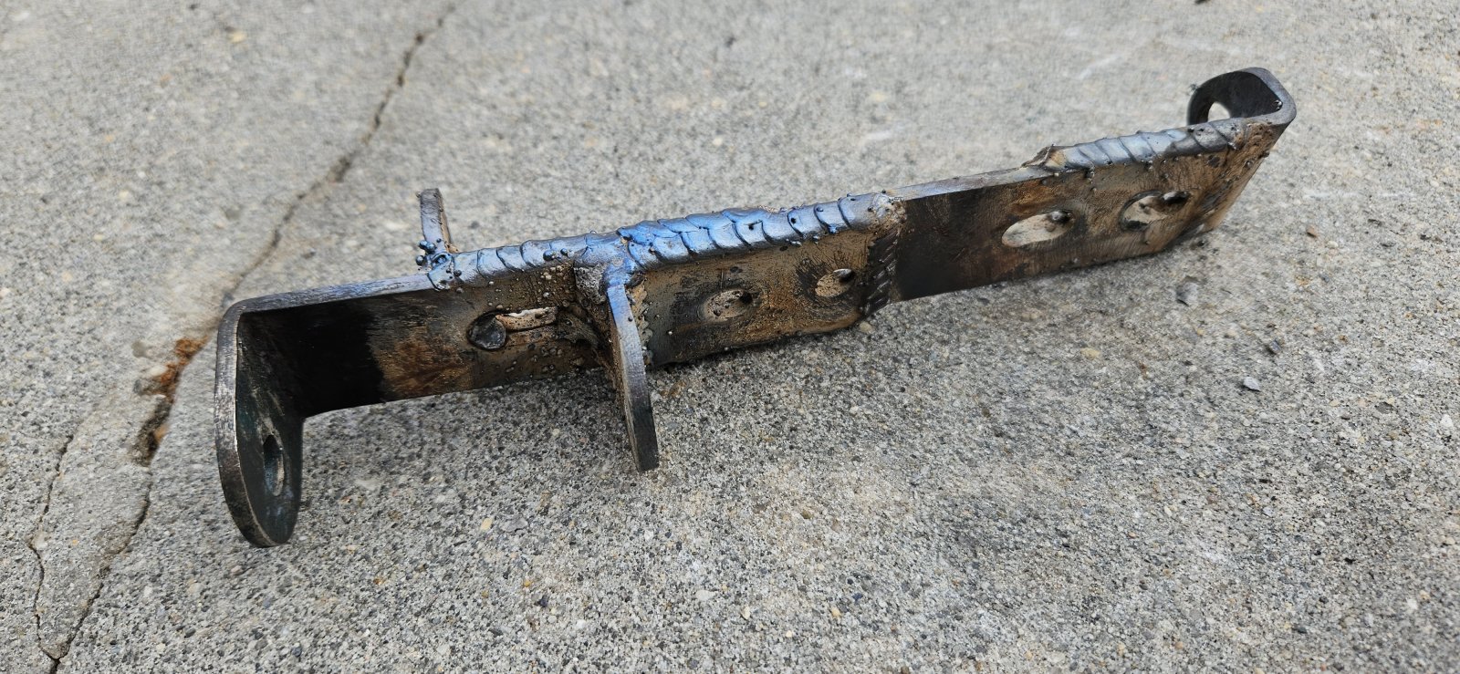

    Fan belt started making a noise today. Went take a look and the generator mount has cracked.
    Guess I didn't anneal it right.
    Need to pull that all out and weld it up but not today.
    bchctybob, loudbang and Woogeroo like this.
  28. PhilA
    Joined: Sep 6, 2018
    Posts: 2,107
    PhilA
    Yup, that was definitely broken.
    I didn't have a welding machine when I made it hence the bolts. That and I wanted to adjust it.
    Well, now it's welded.
    Splash of paint and started to re***emble.
    All back together and working properly. Also did oil and grease because it needed doing.
    Just enjoying adding the miles.
