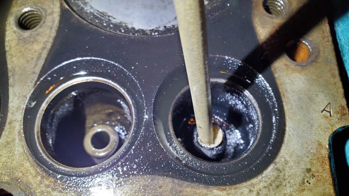

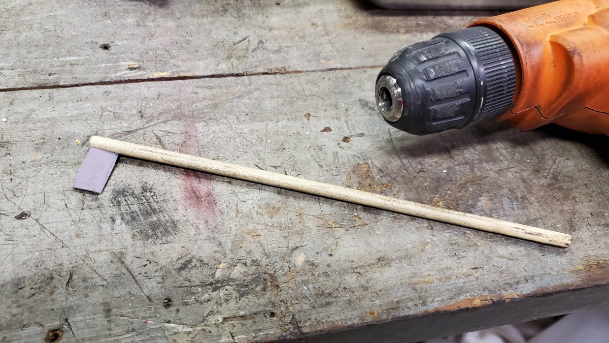

    In a sudden bout of creativity, I ***embled a piece of fairly worn 220 grit abrasive paper into a piece of poplar dowel.
    Fits nicely into the guide; spun round a little like a hone it appears to have cleared any rust or debris.
    I need a small bottle brush and a can of carburetor cleaner to finish up, I think.
