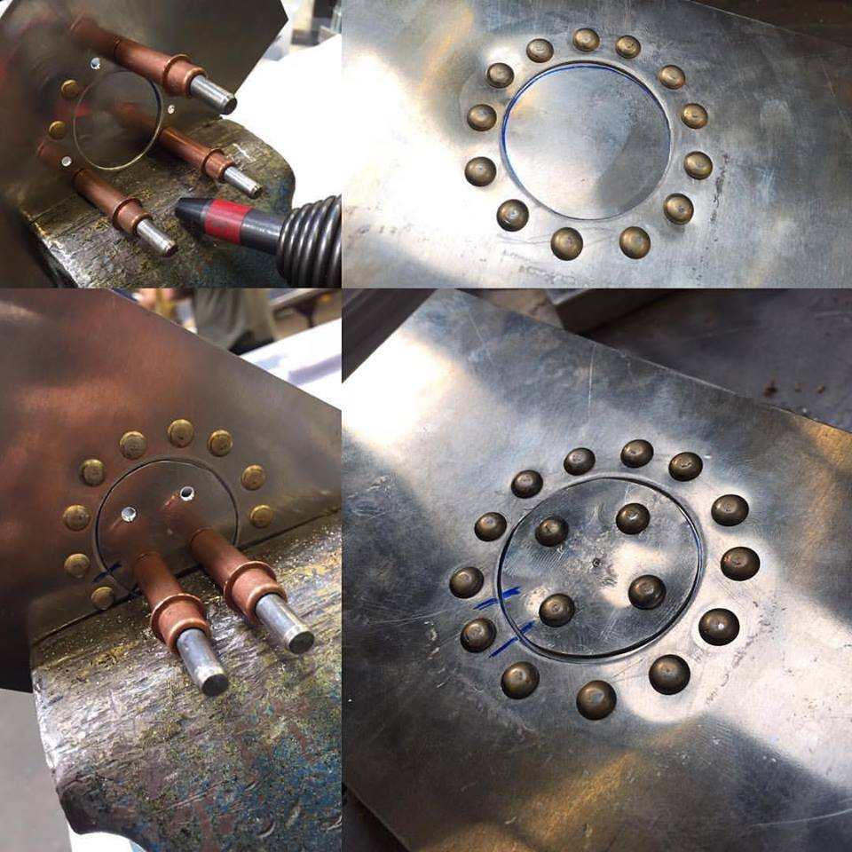

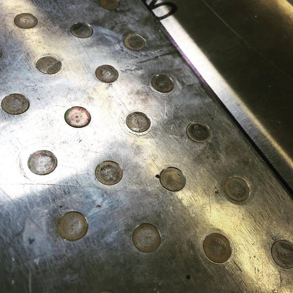

    The ease of the repair will depend on whether you want it perfect, or are okay with a patch. If you want it factory perfect, there's no real other option than replacing the whole panel or panels. If it were an aircraft, 90% of the time a fairly simple repair would be done with a few flush patches and doublers. Making patches is kinda the****utic...
    Sample patch with plain rivets:
    Doubled repair with flush rivets:

    Uh yeah... You need to get your *** to Texas. I'm not going for perfect really... I'm going for a warbird look to match the rest of the patches on the thing.
