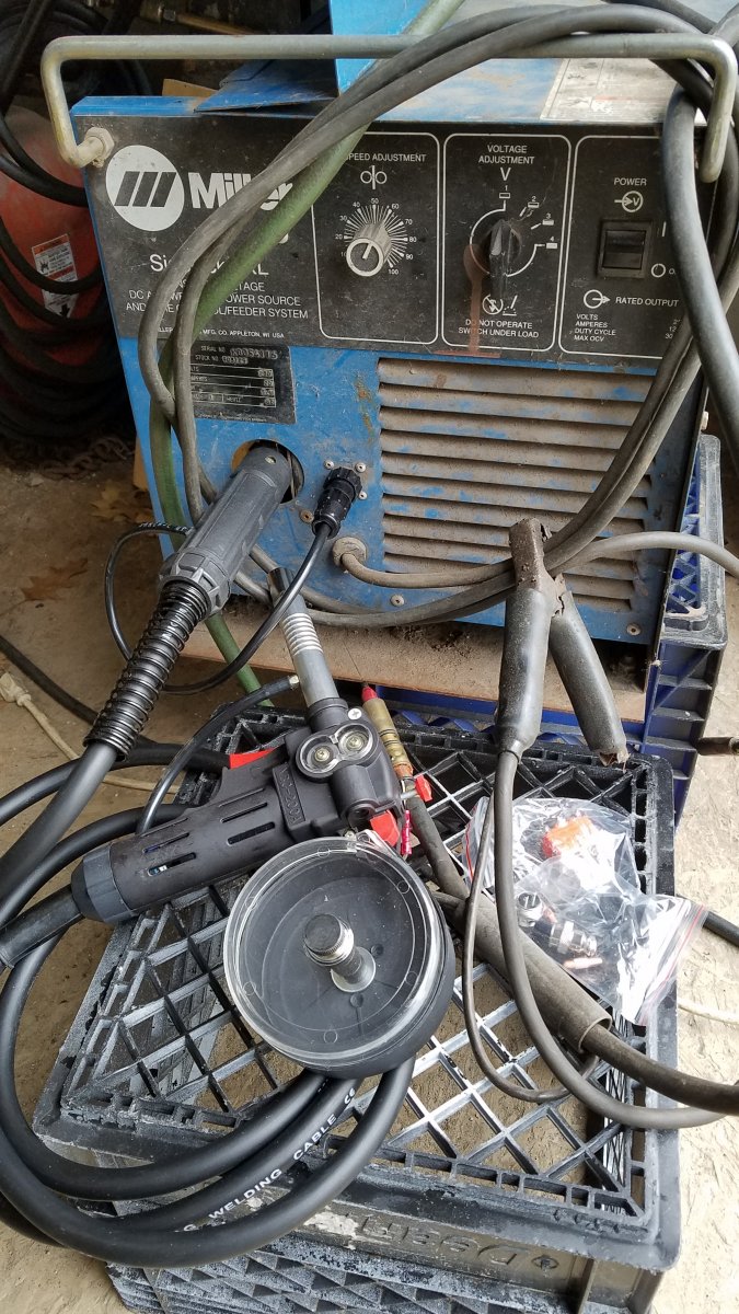

  6. Lakeshadow
    Joined: Sep 4, 2008
    Posts: 55
    Lakeshadow
    Is it possible to hook up a spool gun to one of these Sidekick welders?

  11. Lakeshadow
    Joined: Sep 4, 2008
    Posts: 55
    Lakeshadow
    My Sidekick is 220V...

  14. Lakeshadow
    Joined: Sep 4, 2008
    Posts: 55
    Lakeshadow
    Miller wants to know the serial number of my machine. Considering the polarity can be reversed and there is aluminum welding guidelines on the paper that was stuck on the inside cover, I believe there is a chance Miller may have the components available. If not I bet I can figure out how to fit a spool to this myself....

  20. Lakeshadow
    Joined: Sep 4, 2008
    Posts: 55
    Lakeshadow
    Looks good so far... 220V. Spool gun compatible.....
