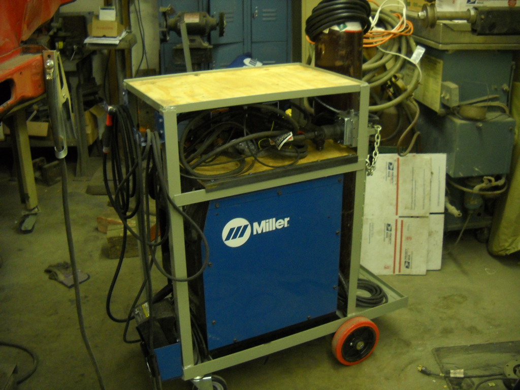

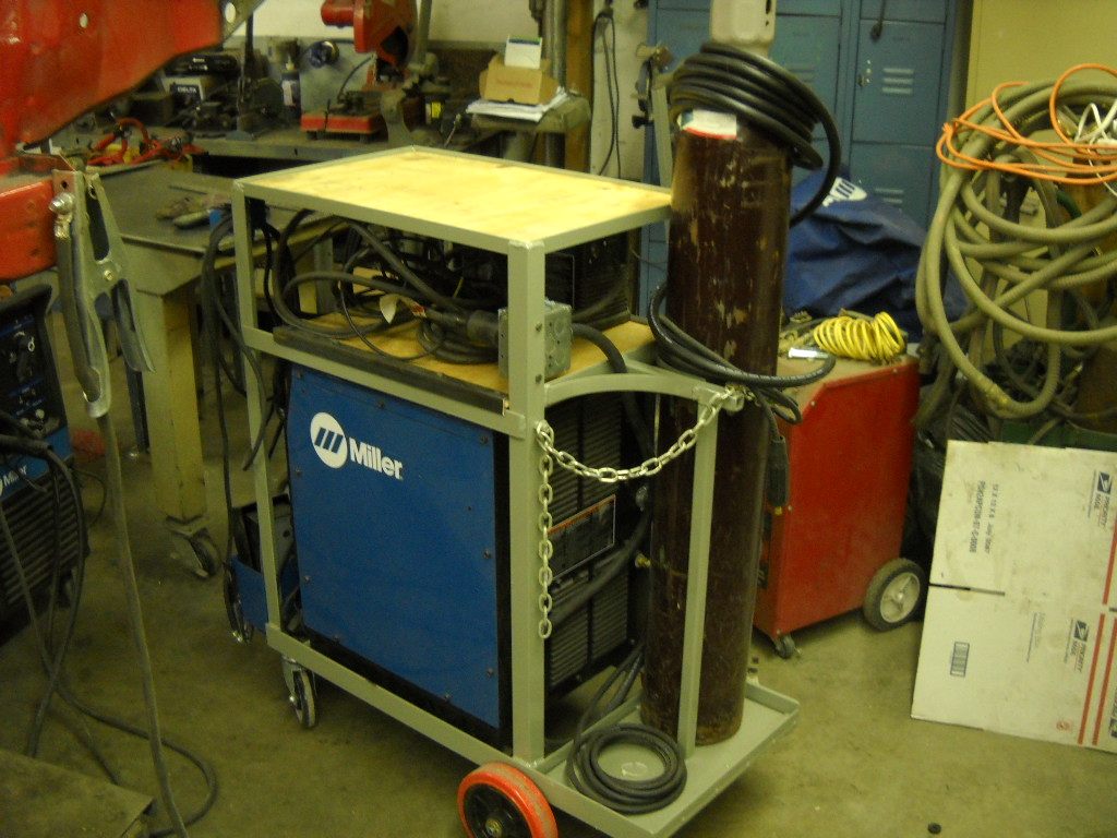

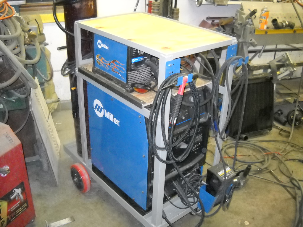

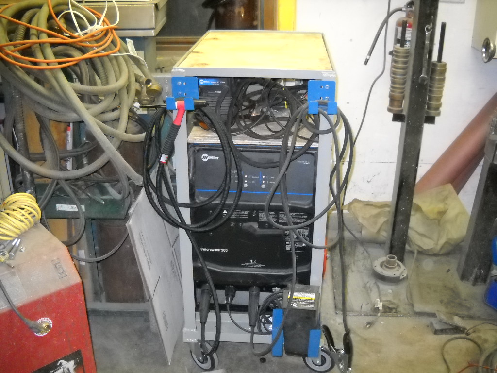

    Here is my cart. A little thought went into it. I wanted a shelf for my Miller Spectrum 375 plasma cutter, that would plug into a common 220V cord. A longer cord, 20', was then added. I wanted a top surface to set ****. My Miller 210 TIG ends up as a shelf, and I hate that. Since the welder was so wide, I made it capable of holding two bottles. I probably will put my spare MIG bottle there or bunch of 2 inch PVC to hold welding rod. I wanted the cabling accessible on the front, rather than the side as it is normally. It was constructed out of a 1/4" x 2" angle iron as a base and 1/4" plate for the base of the tanks. I painted it with epoxy paint to last my lifetime. Like everything I build, it's overkill :)

    great machine and by the way nice cart

    damn thats pretty nice thanks for the pics
