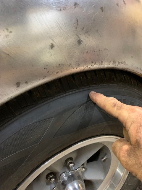

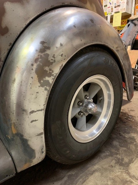

    IF - The new gen wheels were offered in a 6" wide, this thread wouldn't be needed. The rear is a 9" out of a '69 Cougar. It's been in there forever, so not really wanting to go through all that for 2".
    Ideally I'd like to have the "original" wheels straightened and trued, but...?
    Attached is what I've got, and the finger indicated where everything wants to share real estate. Yes, it's in the air, but the rear is on jack stands, so that is ride height. Plenty of clearance 95% of the time, but just enough to kiss. It actually was one of two reasons that made me fail NSRA safety inspection; the other being a double throttle return spring.

  9. What I see there is plenty space between tire and fender opening for normal travel as you said. I'd look into a different fix. What's stopping you from installing a rubber bump stop that makes contact with the housing 1/4" before the Tire gets to the Fender? Wouldn't that end your rubbing issue? Why does it look like the Fender isn't bolted completely in place? Looks like more than a 1/4" gap there.

    Rear fender in the pic is tight to the body; not the best pic so it looks like it's hanging. Bump stop may be the answer; not sure if there even is one there; never looked.
