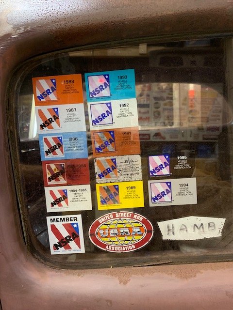

    That is not an option for him. That's half of the reason that he failed NSRA safety inspection.

    stop getting NSRA inspections. problem solved.

    I will again go back to my original "issue" - If the new wheel was available in 15 x 6, this thread wouldn't exist. Milling the wheel is simply not worth the risk of wheel failure to me. I'm entertaining E/T wheels all around (they have to match) - problem solved. All of the other solutions / remedies might apply if this was a new build.
    NSRA inspection isn't that big of a concern to me as it is carrying on the tradition of it p***ing since the 80s, safety 23 and all. I guess it's more of a tribute - "it's still got it" sort of thing. (Yes, i'm aware it needs a new H.A.M.B. decal...). At the end of the day, I'm just trying to stay true to the car.

  14. Screw the NSRA inspection. It was founded in good ideals but has become nothing more than virtue signalling. My OT AWD daily ski hill commuter gets wheel rub any time it snows and the snow builds up, in fact, EVERY late model I have owned in the last 30 years did the same, some times so bad you can smell the rubber melting on the ice. A little tire rub is the LEAST of your worries.
