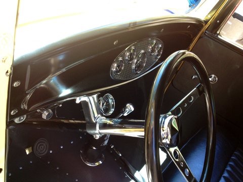

    I appreciate your honest opinion. I can't say that I'm really sure about the steering wheel change either. I do like the feel and even the quality of the limeworks forty wheel. The grip being thinner and the 16" wheel just has a nice feel in the car but the look might not be right. It may change again. One thing everyone will find out as this thread progresses is I'm not afraid to change it all more than once! I'm on my third set of headers and my third set of headlights. They all have their pros and cons.

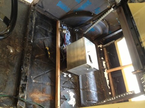

    Since I don't have any new progress to show I'll add some old pictures I have of the car from when I was working on it originally. As I said before I put a quick home made interior in the car a few years back. I took a number of pictures with the interior out to show the mods and condition of the car.
    These are pictures of the car as I'm disassembling it originally. I removed the majority of the sound deadening material. The steering column was a temporary change before being put at the correct location and angle. The original rear window wood was already trimmed down to remove the package tray and crank when I got it. The rest of the original wood is all in place including the roof.
    The front floor is done in plate steel. Who ever did this changed the angle that it meets the fire wall. Makes the floor very flat the trans tunnel is more of a bump.

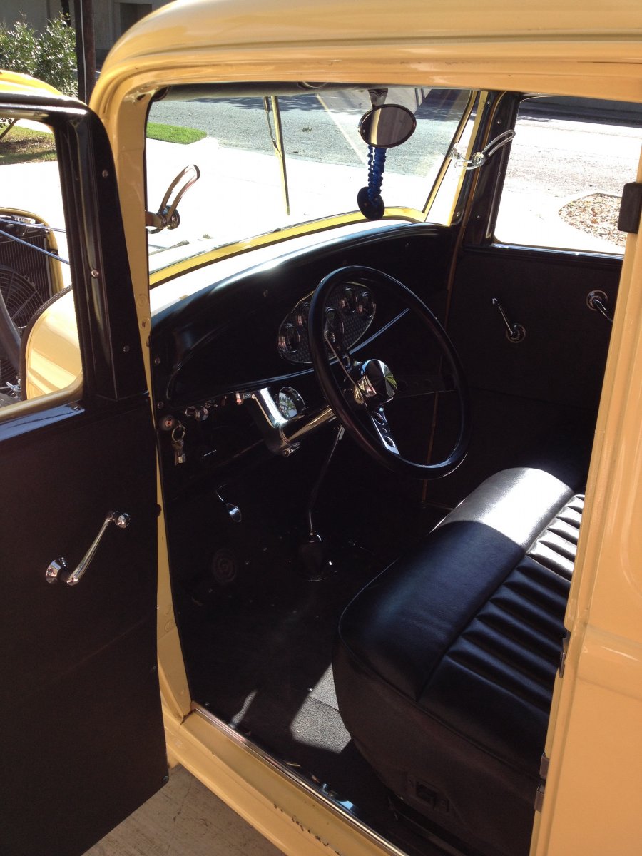

    actually let me show you what the interior looked like the day I got it...
    This picture makes it look way better than it was! The column was an old GM tilt unit. It was short! Shorter than the dash by 3-4"! It had an 8" drop on the dash and was only able to clear your legs when set flat. Like a t bucket steering wheel. All the excess wire is wrapped around the column. The seat is a glide unit. It's nice but at this point set on risers and back and forth adjusters. Your head was touching the roof. Chopped feel with out the chop!
    The black panels are literally plastic cardboard from a craft store cover in vinyl. With speakers mounted in them for good measure!
    Since then fixed most of it. Lowered and mounted the seat in a fixed position. Re wired the majority or the cars interior. Made the interior panels out of actual backer board. Ditched the stereo stuff. Put the tilt windshield in it. Installed an emergency/hand brake the car had no kind of emergency/parking brake when I got it. Put the moon tach. Etc etc.

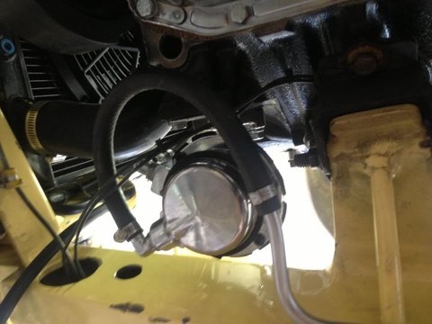

    I need to move a few things around under the car if I decide to run the exhaust through the frame and out the back . I've spent a lot of time putting together my own exhaust for various cars I've had. I too just buy bends and pieces and stick em all together. In my normal quest to do things multiple times on the same car. The exhaust currently on here is also temporary. I'll use some of the elements and correct all of the things I don't like if I run it under the car in the end. I really prefer to run a crossover/balance pipe on my exhaust I prefer the sound. I have one on it now that goes under the torque converter cover. I even notched the cover to run the pipe tighter. I have a small converter so there was plenty of room. Made a heat shield and wrapped the pipe. But like every thing I learned from this set up and will improve it next go around.

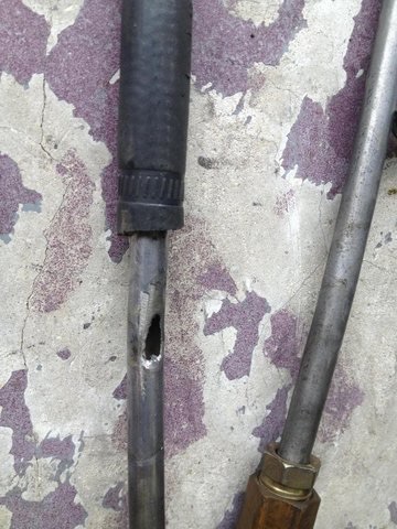

    When I first got the car I ran all new stainless fuel line and the correct edelbrock pump. Mounted it inside the frame rail above the double insulated batter cable. The old set up had 5 separate pieces of various material line with holes rubbed in them. A pump that made too much pressure and a twist regulator that did not work consistently.
    Old line..
