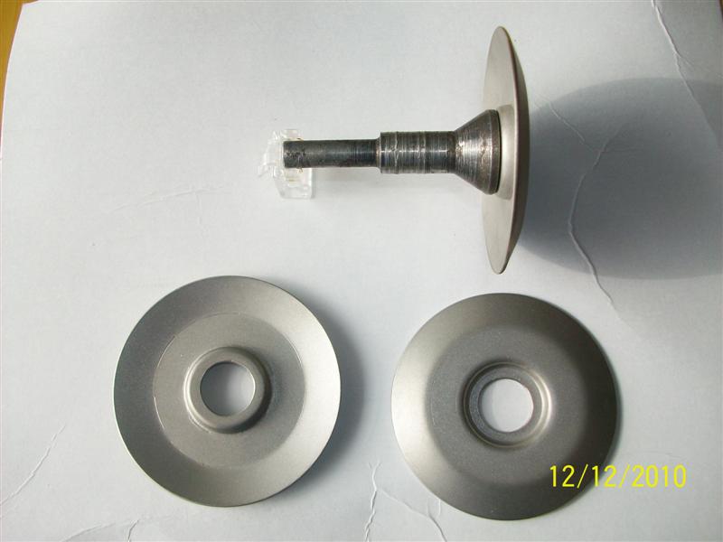

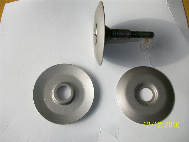

    I have a friend that was in the need to fix some stretched louvers. They were on a dash covering the speaker. I suggested a shrinking disk for use on a air powered 90 degree hand grinder. He was not sure what I was talking about so I took some 16 Gauge 304 stainless steel and quickly made a flat 2.125" diameter disk. It worked well but there was room for improvement. The first thing was to crown the outer edge and the second was to in set the mount. The inset mount was the trickiest. I am using a PFR 419-69027 3/8" Die grinder mandrel with a 1/4" shank. http://www.pferdusa.com/products/206/20602/206020903P.html I might be able to offer them for a small sum if any one is interested.

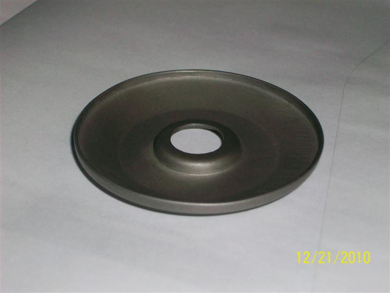

    without a 90 degree lip around the outside they will fail. stress fractures form along the outer edge and they will explode.
    nobody manufactures them without the lip anymore.
    yes, I had one without the lip and I got a nice scar on my arm to remind me of it. that was at 3600 rpm on a buffer. not sure what would have happened if it was at the 20 million rpm of a diegrinder.

    Warning points taken: I will work on rolling the edge back on its self.
    My little 90 degree grinder can spin up to 18000 RPM, but when I was using it with my shrinking disk I did not operate it that high. It was slow enough that I could get heat on the work area. Air tools don't have the ass like electric ones have. You should Start the rotation of the disk and Stop the disk on the work for your own safety.

    convx4
    I was able to add a 90 degree lip to the outer edge. That really stiffened it up. What do you think now?
