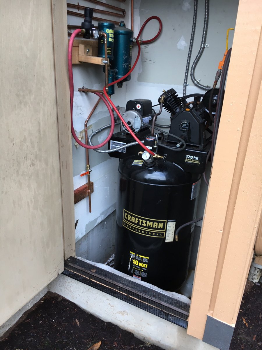

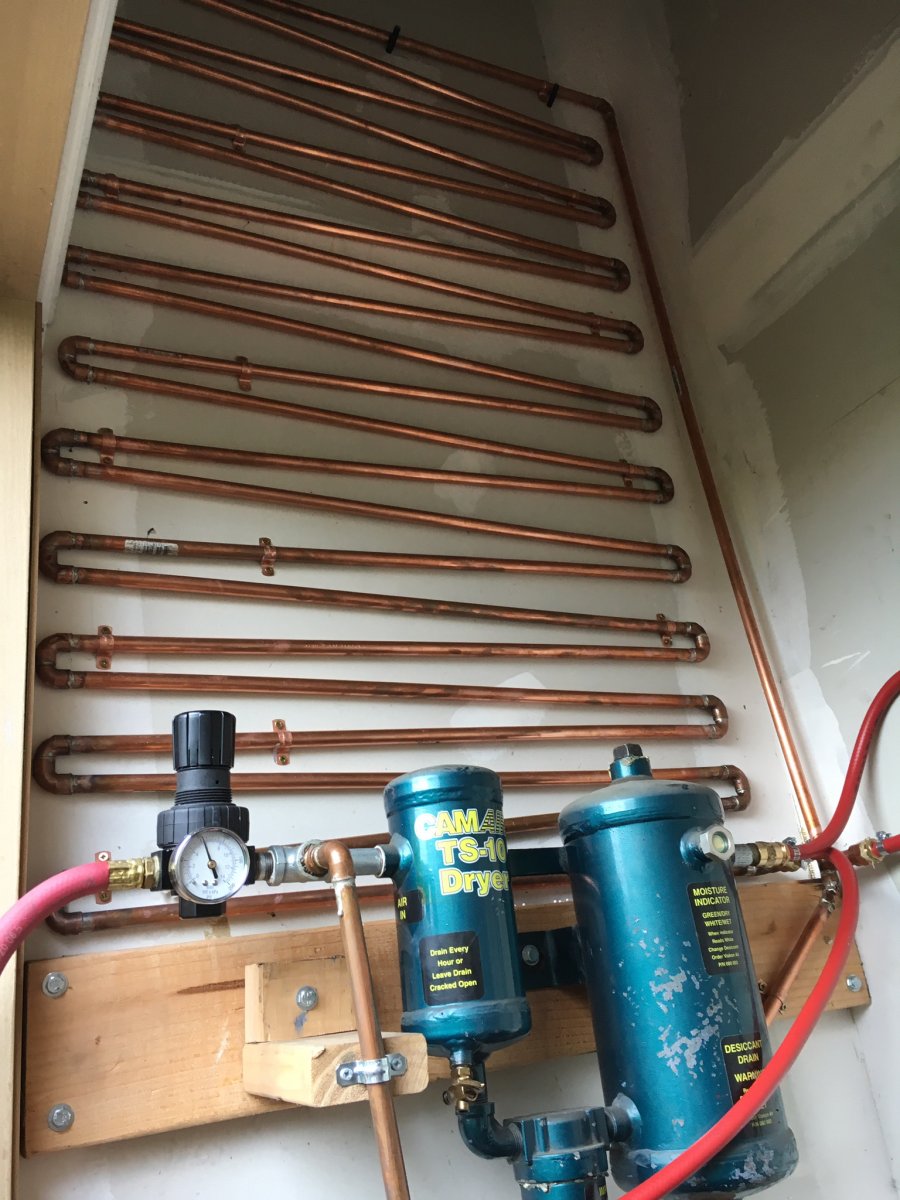

    Bought my craftsman comp about 15 years ago.
    Like I said earlier, replaced the 5 hp motor once, added an automatic drawn to the tank,. Built a cooling tower, added a dryer, works perfect. Looks short cuz it's sitting in a hole (contractor error) but easier to change the motor this way)

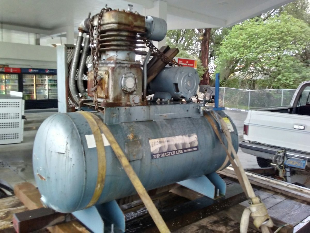

    I had an old 60 gallon 1 horse 2 stage horizontal out of a gas station that closed. Chugged along just fine but strained to keep up with my Barrel Blaster. Bought an upright 80 gallon 5 horse 2 stage IR on sale at Tractor Supply. Very satisfied.
