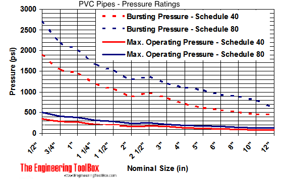

    Maximum operating and required minimum bursting pressures at 73oF (23oC) for PVC pipe fittings according ASTM D1785 "Standard Specification for Poly Vinyl Chloride (PVC) Plastic Pipes Schedules 40 and 80 are indicated in the diagram and table below:
    PVC
    Nominal Pipe Size
    (inches)
    Required Minimum Burst Pressure
    (psi)
    Maximum Operating Pressure
    (psi)
    Schedule 401)
    Schedule 802) Schedule 40 Schedule 80
    1/2 1910 2720 358 509
    3/4 1540 2200 289 413
    1 1440 2020 270 378
    1 1/4 1180 1660 221 312
    Pat

    Please spend some time on the hamb, garage journal or the internet reading about the dangers of using pvc for air lines. Max operating psi and burst strength is not the issue. The issue is that if it gets damaged like being bumped or hit, it will burst and send shrapnel all over you shop. The shrapnel will be sharp, pointed shards flying around your shop. It happened to a friend of mine, he was lucky and the shrapnel missed him.

    Those pressure test listed above are when manufactured. Not when it`s a few tears old. Try those tests on your pipe now. Would you feel safe. If so build up pressure and report your results.

    Chief and stanlow thank you for your suggestions. I mentioned serving an apprenticeship in the service in the plumbing field gaining a journeymen card in half the time of civilians. I had to run air lines in a B47 hanger for changing tires, (witnessed a fatality when a rim exploded, very sad). The tire changing machines by regulation had to be in a cinder block enclosure with the air supply coming to them fed from over head for obvious reasons. I did the same with my compressor when plumbing it, running the lines next to the wall over head though the apex of the truss and rafter to the reel, thus protecting them from potential unintended damage resulting from any shop work or damage from most shop work.
    Of course this does not stop a blow out because of material age/time fatigue which of course is an issue to consider. I appreciate your concern a lot. I suppose I should look into that but being on a ladder with tare out and replacement at (81) I think would be more hazardless than risking a explosive accident. Thanks again for your concern.

    PVC is rated for water pressure not air pressure. BIG difference. Water doesn't compress, air does so if the pipe fails with air in it it goes off like a bomb. No plumbing PVC is rated for air use and there is not a manufacturer out there that doesn't state not for use with air.
    https://www.lascofittings.com/compressed-air-and-pvc
    https://www.slpipe.com/wp-content/uploads/2017/04/PVC-Compressed-Air.pdf

    Google definition;
    Compressed air is stated as pounds per square inch gauge (psig). These plants or systems are cl***ified as low- pressure (0 to 125 psig), medium-pressure (126 to 399 psig), or high-pressure (400 to 6,000 psig) systems.
    (Info) gained off the innerweb. I searched google for, " what is considered high pressure compressed air"
    Very confusing info being p***ed here.
    Bursting pressure for 3/4 sch. 40 on the graph chart shows something just under 2000 PSI.
    As defined above then, because I only run 125 PSI I'm running low pressure.
    I'm not disputing any ones opinion with this just doing my best to understand all my options.
    Am I to ***ume all who had explosions ran greater than 125 PSI?
    I do also appreciate the concern being expressed, and I'm just trying to avoid removing the PVC and replacing with black pipe or copper.
    K13 You said in your post, "PVC is rated for water pressure not air pressure". Is there a difference in pressure whether its air or water? I always understood pressure to be pressure no matter the medium being transferred.
