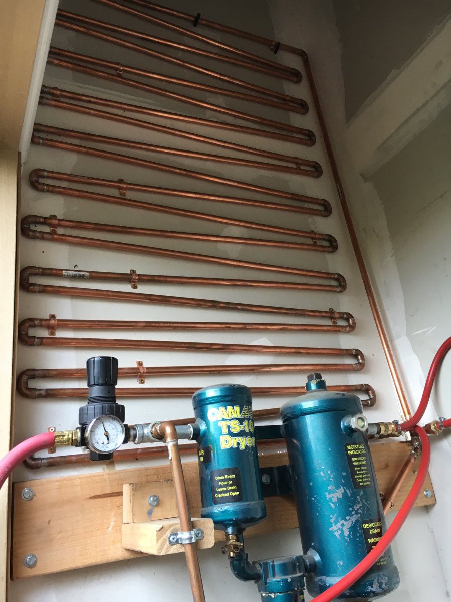

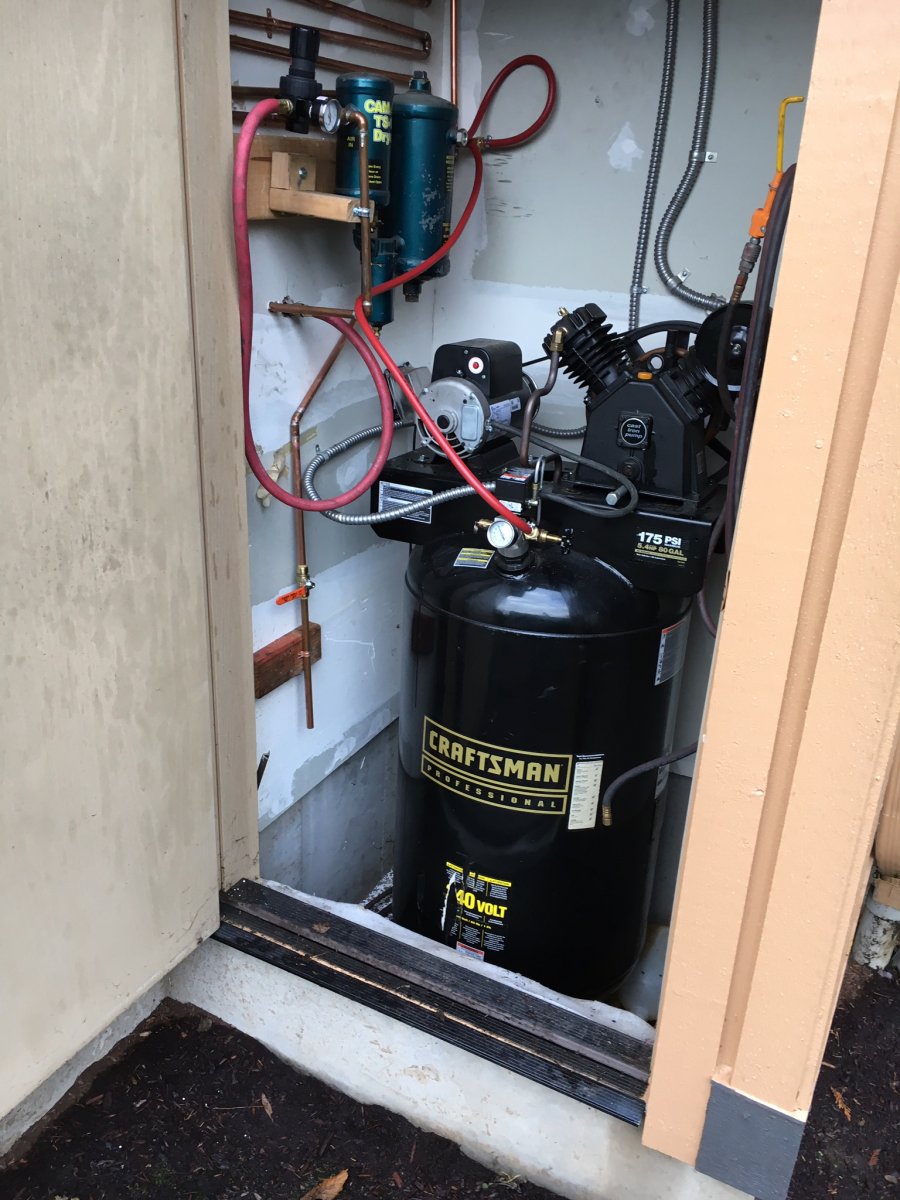

    You can get away with something like this... 80 gallon IR 15 cfm unit... Good enough for a one person shop, not good enough to run two tools on. Less than $1300 when I bought it. 20200310_172759.jpg
  24. dan c
    Joined: Jan 30, 2012
    Posts: 2,680
    dan c
    great idea putting it in a closet; my sears makes me jump every time it kicks on!
    Bandit Billy likes this.

    i've been happy with my craftsman, 6.5 hp, 60 gallon vertical tank. i've had it at least 25 years. as i previously stated, it is loud. i checked out eastwood's "quiet" compressor, but it's something like two grand! the only real mod i did to mine was to run some pipe to a ball valve from the drain--located in the bottom middle of the tank. always hated having to reach under the unit to drain it; we have brown recluse spiders in missouri!

  27. Bandit Billy
    Joined: Sep 16, 2014
    Posts: 17,198
    Bandit Billy
    I hate being near it when it comes on. I like the closet but I should have made it accessible from inside the garage. It is kind of a pain to walk out there in the rain to service the desiccant dryer. But it does make my shop a lot quieter.
