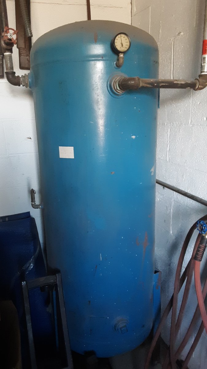

    120 gal addl tank, now plumbed into the shop.

    That's 2 tanks, 80 + the 120 for a total of 200gal. I can run a pressure pot sand blaster with it, no issues. And actually it's not all that loud. I can converse without really yelling when we're in the room, but I keep the doors closed during work days.
