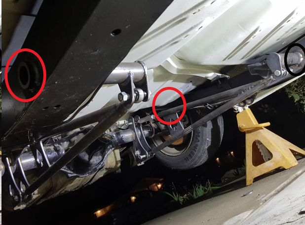

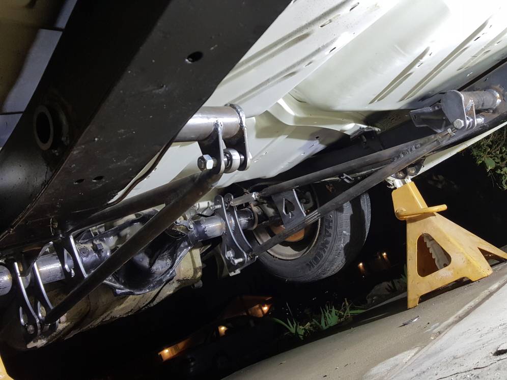

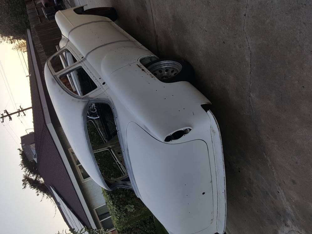

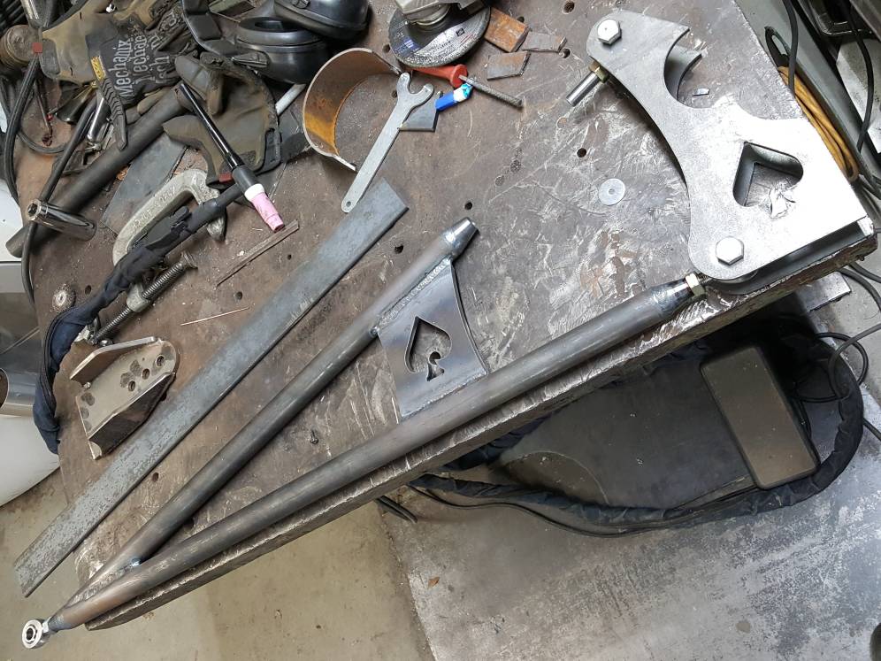

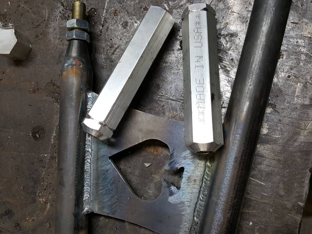

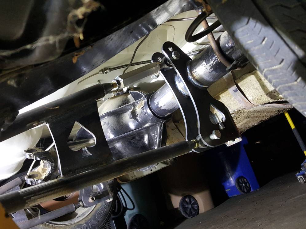

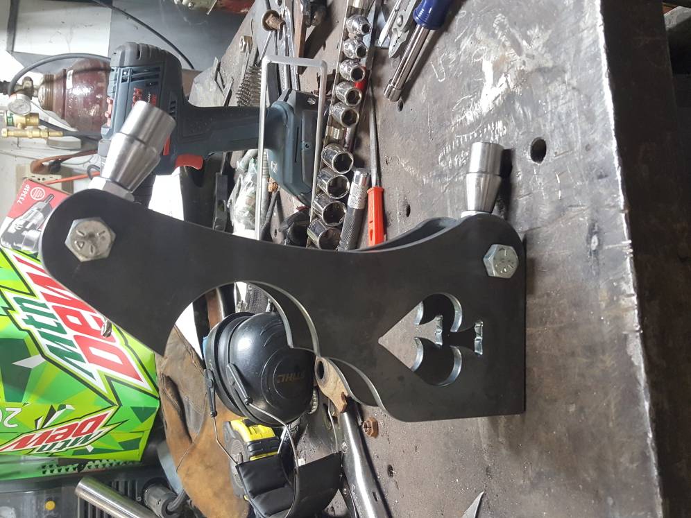

    Had a couple smaller projects come in I thought I'd share some pictures and info.
    Got a '54 Moore door that the owner Jose wanted a 2 link and run coil overs. Things changed and ended up doing ladder bars for him.
    Sent from my SM-G925V using The H.A.M.B. mobile app

    Parallel?

  6. royalflushcustoms
    Joined: Sep 3, 2013
    Posts: 140
    royalflushcustoms
    I'm not sure what's with the pictures they were upright when I selected them.

  8. Never2old
    Joined: Oct 14, 2010
    Posts: 743
    Never2old
    from so cal
    Im not used to seeing ladder bars installed parallel.

  9. fiftyv8
    Joined: Mar 11, 2007
    Posts: 5,401
    fiftyv8
    from CO & WA
    Nice ladder bars, just need to learn how to rotate pic's before posting.
    You may need a Panhard bar if your bars are parallel!!!

  10. gimpyshotrods
    Joined: May 20, 2009
    Posts: 24,561
    gimpyshotrods
    Drag only car?
    VANDENPLAS likes this.
  11. royalflushcustoms
    Joined: Sep 3, 2013
    Posts: 140
    royalflushcustoms
    It's odd the pictures are right side up on my phone and when I add them in the post but when it posts it's wrong side up.

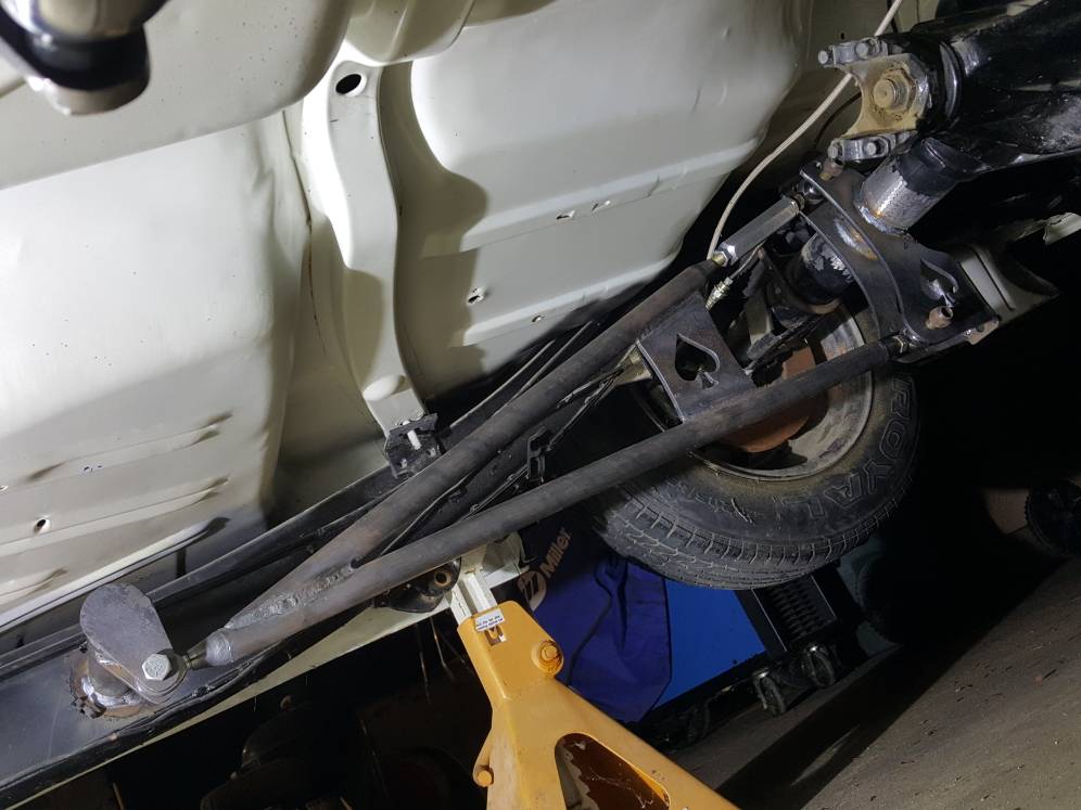

  14. gimpyshotrods
    Posts: 24,561
    gimpyshotrods
    Really? If you have never seen nonparallel ladder bars, then why are you doing suspension work?
    I asked about this being a drag-only car for a reason.
    Parallel ladder bars will lead to uncontrollable oversteer on the street, when cornering.
    Whether or not this causes you to lose control of the vehicle is up to traction, and speed (and NOT driver skill).
    Parallel ladder bars turn the bars, and the axle housing into a giant anti-roll-bar. Front suspension body roll will result in the unloading of the inside rear tire in a corner. This will break the rear end lose (oversteer).
    This puts immense stress on all of the involved components, which can, and has led to catastrophic failure.
    If you are building this car for yourself, you are putting your life at risk.
    If you are building this for someone else, and something goes wrong, a cursory accident investigation and reconstruction will put the law, lawyers, and insurance companies at your front door.
    Porsche didn't win this lawsuit, and neither will you.

  18. Triangulated 4 link is a better set up, holds the rear end in place “firmer” for lack of a better word
    Less to no side to side movement of the axle
    No Panhard bar required
    A parallel 4 link is easier to install
    Is not as “firm” as a triangulated set up
    DOES require a Panhard bar

  22. Drag cars are set up that way because it promotes more even weight transfer, not because of any 'strength' issues. And they're driven on nice flat race tracks in a straight line; any cornering involved is at slow speeds at the beginning and end of runs.
    Gimpy is giving you the straight sh!t; that set-up on the street is dangerous. It will have sudden and m***ive oversteer with little or no warning when you reach the 'limit', swapping ends on you. This is one piece of race-car tech that doesn't transfer to the street worth a damn...

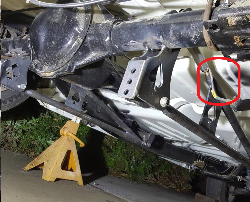

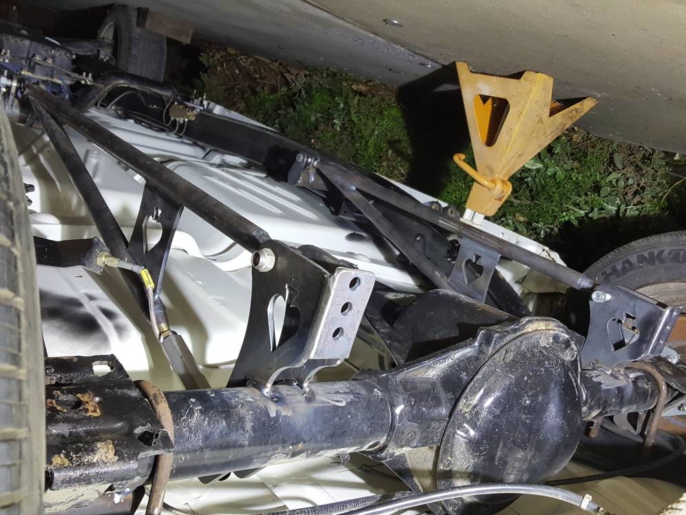

    It appears that there is not a lot of suspension travel to the floor pan with that set up. In saying that I had a friend who had a parallel 4-bar installed, by a local rod-shop, to a similar top hat style '46 Chevy frame and it wasn't gusseted sufficiently which I brought it to his attention. It was rectified before the car hit the road, last thing he wanted was a sudden failure at speed.
    The top hat frame rails aren't as thick when compared to open 'C' channel or closed channel frames. In addition there were no reinforcing plates where his mounts were welded to the frame. The loads when being driven were not being spread out sufficiently over a larger area and were concentrated at attachment points.
    I note that the through tubing is double sheered (Welded both sides) however I envisage that the frame will eventually fail in these areas with stress cracks developing from the forces generated during suspension cycling. The car is being street driven and not 400 yards at a time.
    A continuous tube cross-member is inherently stronger. Also I don't see how that setup without a panhard (Locating) bar prevents lateral movement. Rod ends have specific uses are not street car friendly. The adjusters are there to adjust pinion angle and pre-load.

  25. royalflushcustoms
    Joined: Sep 3, 2013
    Posts: 140
    royalflushcustoms
    It's not done. It will have a track bar. Also it is sitting at lowest point of travel.

  27. Ned Ludd
    Joined: May 15, 2009
    Posts: 5,534
    Ned Ludd
    Gimpys has the principle right, if not the mechanism. What happens is that elastic roll moment loads the outside rear tyre. That is what causes the tendency to oversteer.
    Have you ever seen a dump truck being loaded? Have you seen how the rear tyres start to look like they don't have enough air in them, as the load increases? The same thing happens in a car tyre when cornering.
    The greater the load on a tyre, the greater the air pressure needed to maintain the tyre's shape. If the tyre loses its shape, it becomes possible for the contact patch at the bottom of the tyre to twist, so it is pointing in a different direction to where the wheel is rolling. The contact patch sits at an angle to the wheel, and that angle is called slip angle. It's not a very good term, because at this stage there isn't any actual slipping happening, but that's what it's called.
    Now, we don't have the option of quickly increasing the air pressure in a tyre in real time, nor do I think we'd want to. It's this knack tyres have of running slip angles which makes ch***is tunable at all. That is the basis of the central principle of ch***is tuning: adding load to the better-performing outside tyre will add grip at the other end of the car.
    Let's take a look at what you're doing with your ladder bars. You turn left, so the car rolls right. Relative to the car, the left side of the axle goes down, and the right side comes up. Because the ladder bars are bolted to the axle the way they are, this means that there is now compression in top chord of the left bar and the bottom chord of the right bar, and tension in the bottom chord of the left bar and the top chord of the right bar. What does this do?
    Yes, it increases roll stiffness at the back, which will tend to increase oversteer. Though the axle housing is hugely stiff – tell me the diameter, wall thickness, and distance between ladder bar brackets and I'll tell you how stiff – the long ladder bars represent long moment arms and hence a small angle of twist. If that were all there were to it you'd be able to tune that out with a moderately chunky anti-roll bar on the front suspension. But that isn't all there is to it.
    Those same long moment arms multiply the forces parallel to the ladder bar chords enormously. Are the fasteners to the axle brackets up to the job? The failure mode I see here is not the entire car going sideways into the woods but either the bolts eating the holes in the axle bracket oval or the axle brackets forging the bolts into little crankshafts. Either way the rear suspension eventually becomes sloppy and unpredictable because everything can move ¼" in its holes and you end up sideways in the woods anyways.
    If you beef up the bolts and brackets it just means that something else is going to fail instead. You want to get rid of those tensions and compressions. That's how light truck suspensions are done: plenty of compliance is built in. The downside is rather vague suspension. The other way is to build in some elasticity. Make the ladder bars springy is some way. There are a million ways to do that but you'll have to do it yourself, because the cats are wanting to be fed and I have to go.

    Ladder's, a Pan hard bar, and a FULL cross member..... The RIGHT WAY. That big gap in between those bars is making me a lil nervous.........Not my *** riding in the seat though....... AND, not signing my name on it....
    If your's= good luck....... If a customer, well, GOOD LUCK with that too.......
    Heed words of wisdom from previous posters....... There's always a way, then there is the correct way......:oops:
  30. gimpyshotrods
    Posts: 24,561
    gimpyshotrods
    The failure to fail is not the same thing as success.
    The fact that you are not sure where everyone is trying to go with their lectures is concerning. Many people commenting here are actual engineers, at actual automobile companies, where they design actual cars. Others are long time racers, ch***is designers, and suspension tuners. If that, alone, is not enough for you to gain an understanding of where they are going with the lectures, the failure to understand may be intentional, on your part.
    Ladder bars do exist, and they have a place. That place is not on a street vehicle. Just because you have seen them, and the 2-link kits that resemble them, does not make them right, or safe.
    I see drug deals frequently. That does not make them right, or safe.
    As for mounting two triangulated links, that absolutely does not increase the chance of failure.
    Have you ever watched a NASCAR race? Have you seen those cars maintain 200+ mph on a high-banked oval, or road-race course? Have you seen a crash? Go ahead, Google NASCAR crashes. Tell me how many include tearing the rear suspension out.
    What do all of those cars have in common? Triangulated 2-link, with flexible links, that can twist.
