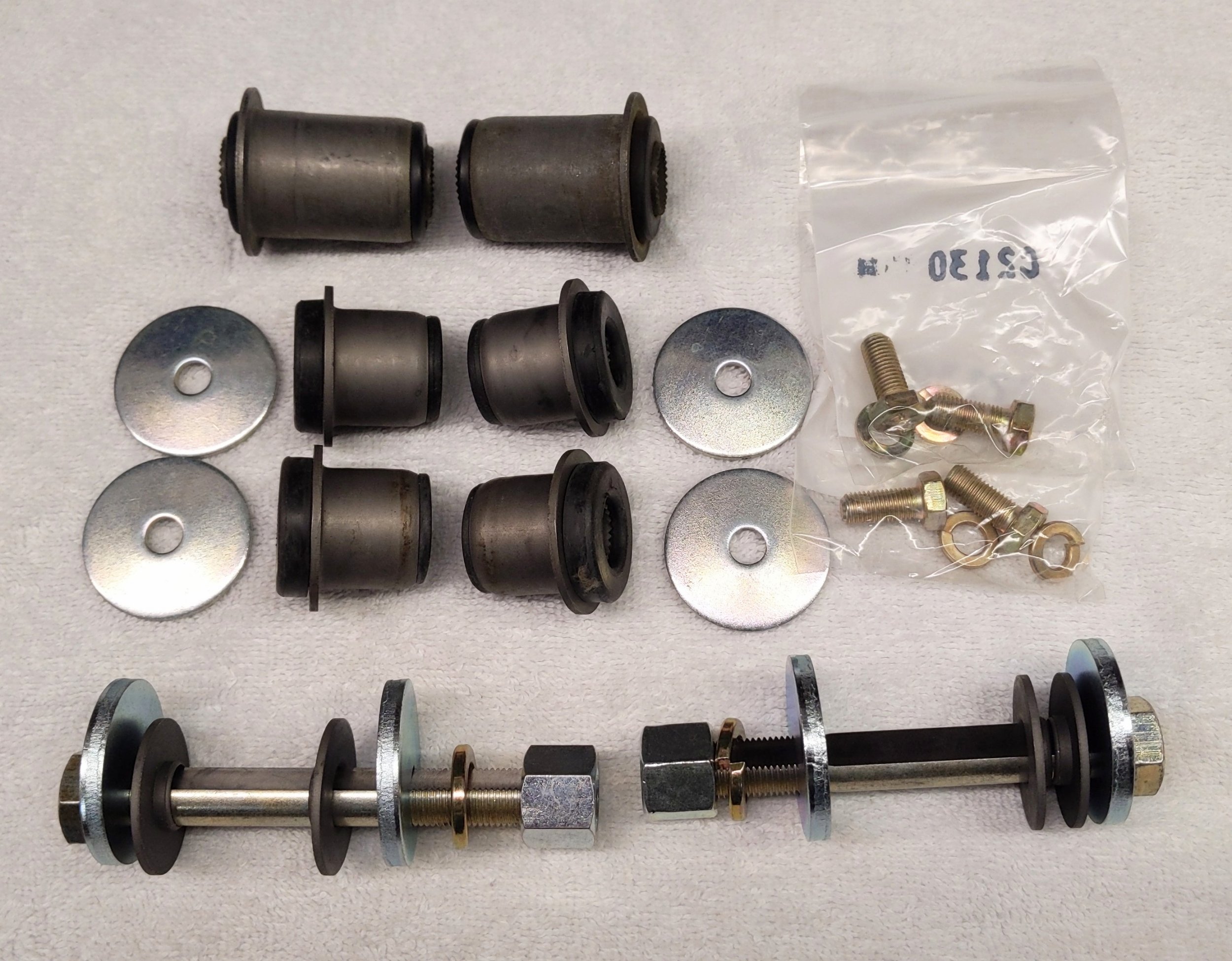

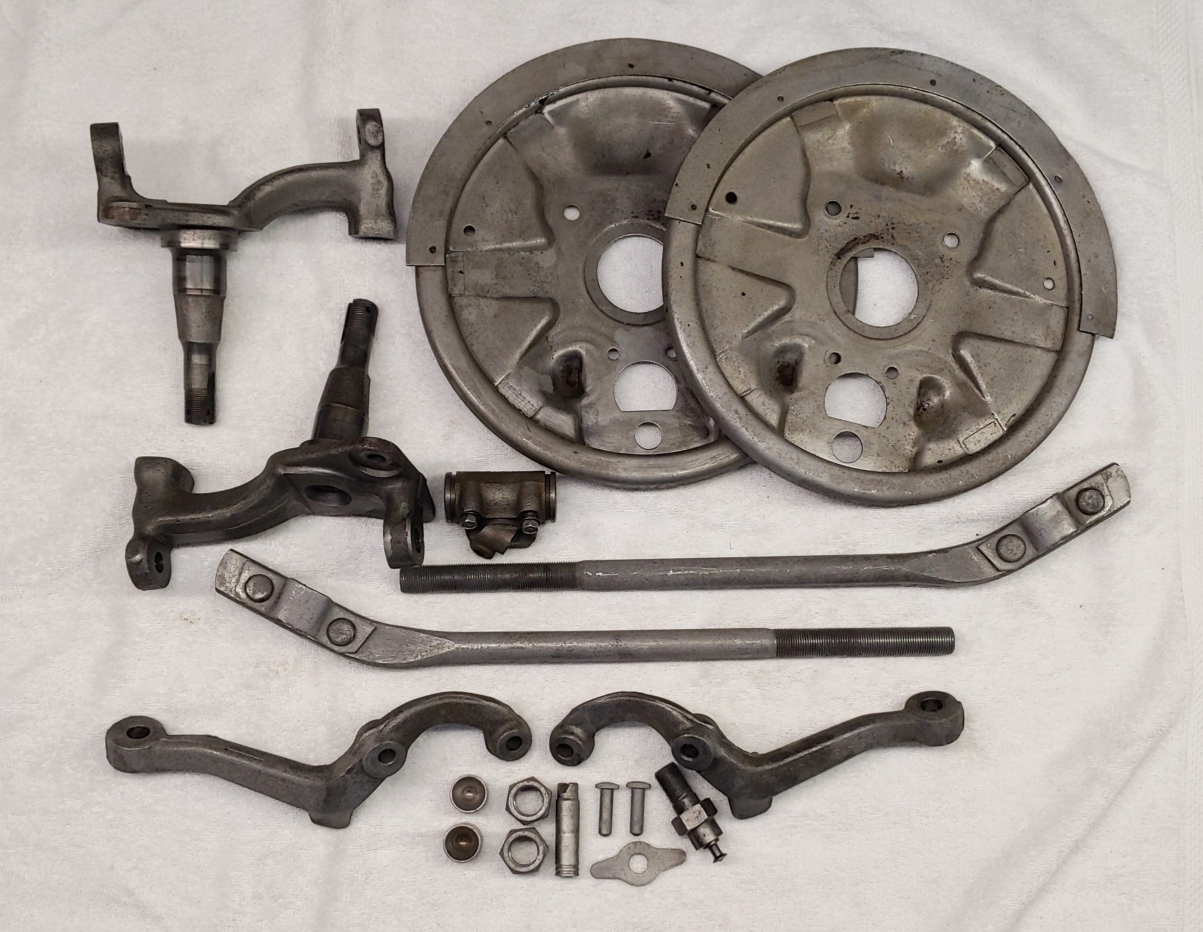

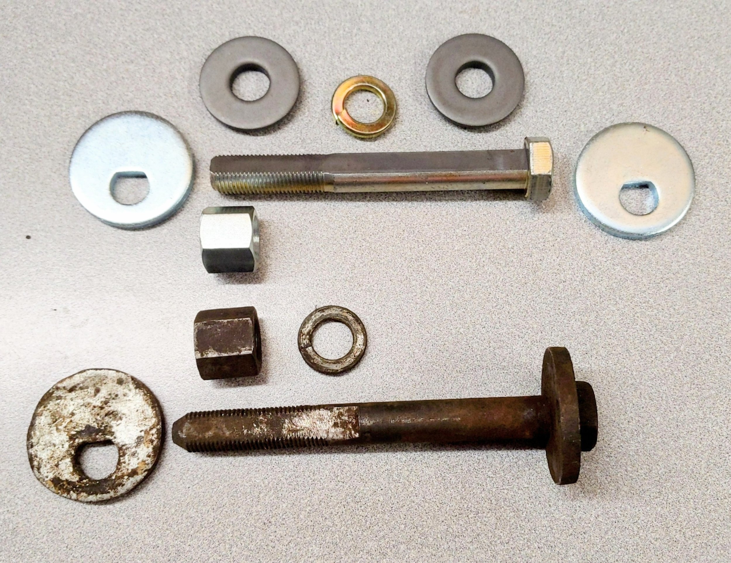

    I figured replacing the old upper and lower Corvair control arm bushings would make a good winter project, and it needed to be done eventually, so, here we go. I started by cutting some 1.25" 90* angle channel to use as spacers inside the upper control arms, which prevent the legs(?) of the A-arms from being pressed toward each other during bushing removal, per a tip at the Corvair Center forum: https://corvaircenter.com/forum/ I also cut a short length of steel tube, split it in half, then used that as the spacer for the lower control arms, too. I have a 12-ton hydraulic press that did the job just fine, but I did clean and soak the steel bushing flanges a few times before pressing them out, just to give myself a good a chance of getting them out on the first try. Fortunately, the only damage during the entire process was a broken off bolt which holds the end cap washer to the cross shaft, so I drilled out the remaining bolt piece and cleaned/re-tapped the blind hole, and good as new.
    Today I media blasted all four control arms to bare metal (yes, I protected the lower ball joints very well, and removed/unbolted the upper ball joints), so I will get them primed as soon as I can, then press in the new upper bushings I got from Clark's Corvair Parts and the pair of vintage Moog lower bushings I bought a few months ago. While I was ordering from Clark's, I bought some new lower control arm camber adjusting bolts and hardware, too, though the original ones I have are probably good enough to clean up and re-use-- I needed the special inner washers, so I figured I should just get the complete set now. The new pivot bolt and washers are slightly different than the original parts, but should function just the same:
    I had to check to see if I had the correct speedo cable drive dust cap, and luckily, I do, though it's not the prettiest:
    The backside of the LF spindle, with the hole through which the speedo cable p***es visible at center-- the two smaller holes retain the cable bracket to the spindle:
    While I had the front suspension parts out, I took a look at the brake parts, and they were a bit better than I remembered, especially the contact surface of the drums. Not sure I will retain the front drum brakes, but it's always an option, especially after new brake cylinders, hoses, and shoes.

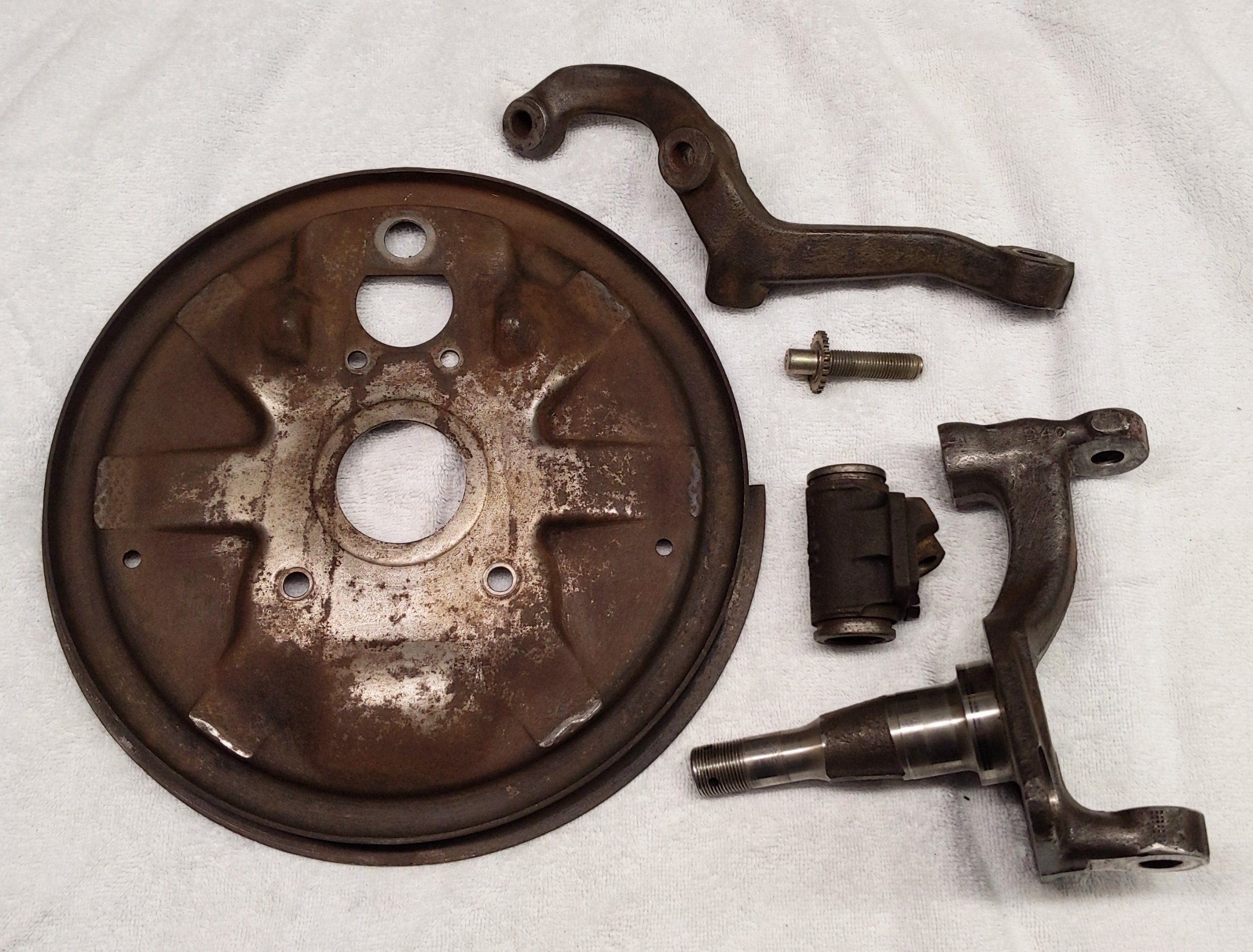

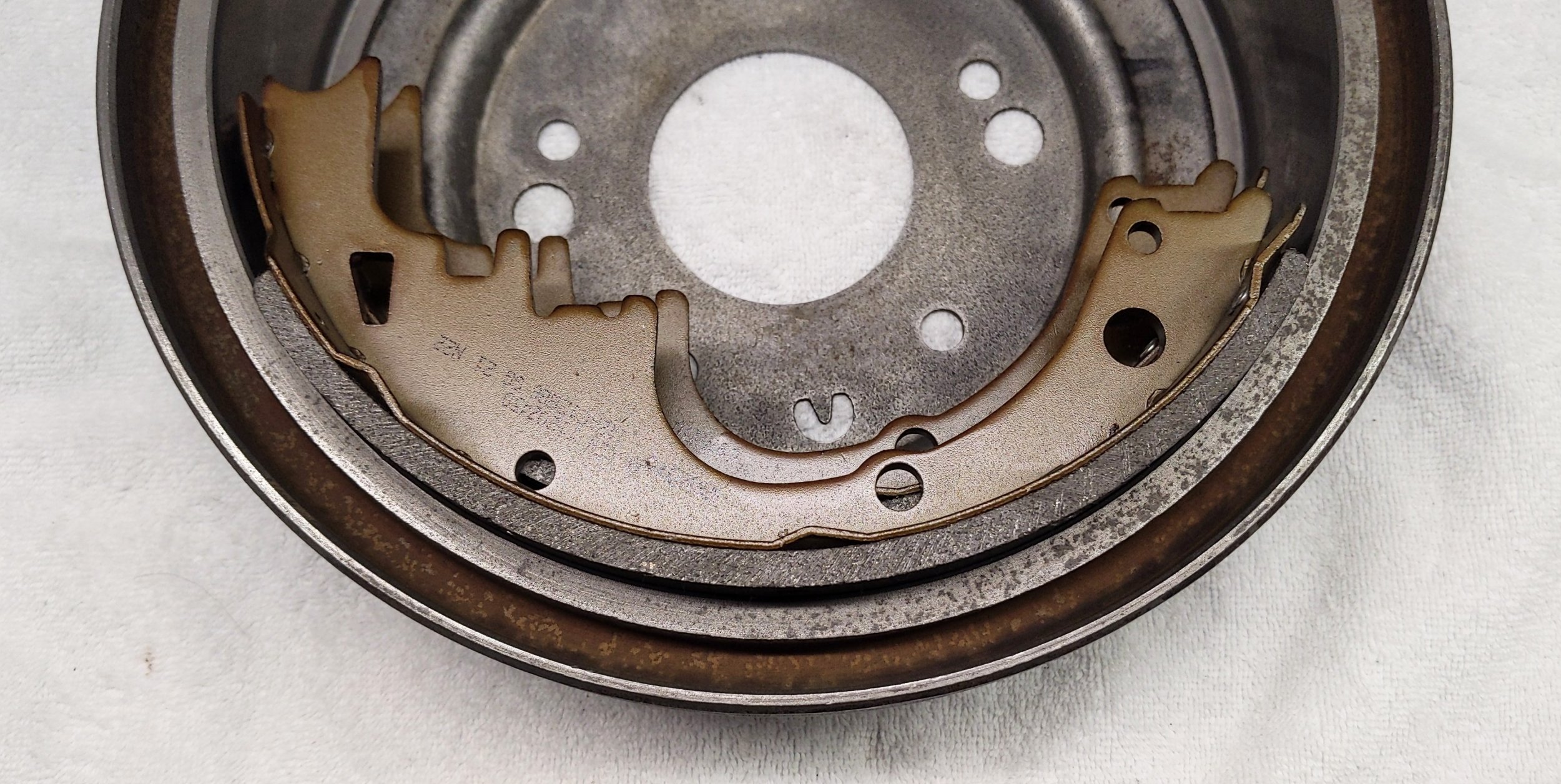

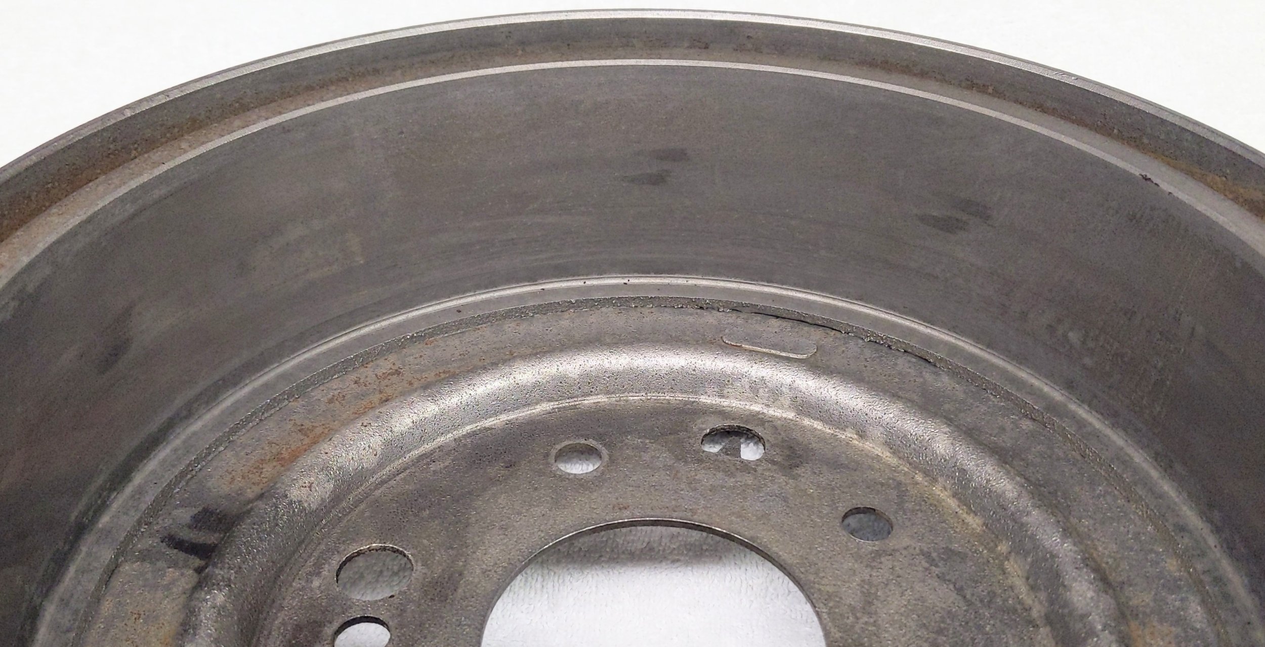

    I started dis***embling and cleaning the front brakes, hubs, backing plates, etc. yesterday, and there were no surprises. I filed off some sharp edges from past hammer blows and casting seams, scrubbed off all the caked on grease, and got one backing plate, spindle, and steering arm grease free, at least:
    The brake cylinders were in great shape, with no rust inside, so they will be reused-- even the bleeder screws backed out easily. I ordered a bunch of small brake parts, shoes, hub seals and bearings, and a new dual reservoir GM four-wheel drum brake master cylinder, too.
    Both drums have some very light rust in one area, so I will break out the fine emory cloth this weekend and see how they clean up. New drums are available if I need to go that route, but I'd prefer to use the drums I have.
    I see an Evaporust or similar bath in the near future for most of these parts as I don't need them to be 100% bare metal, and I don't want to risk damaging the machined surfaces of the spindles.

    I gave both brake drums a room temperature Evapo-Rust bath, and both came out looking very nice. The minimal rust I felt on the friction surfaces was just that, very minimal. No need to have the drums turned-- a light sanding with fine emery cloth should suffice. I should be able to use the old, glazed brake shoes to get good contact with the drums while sanding, too.

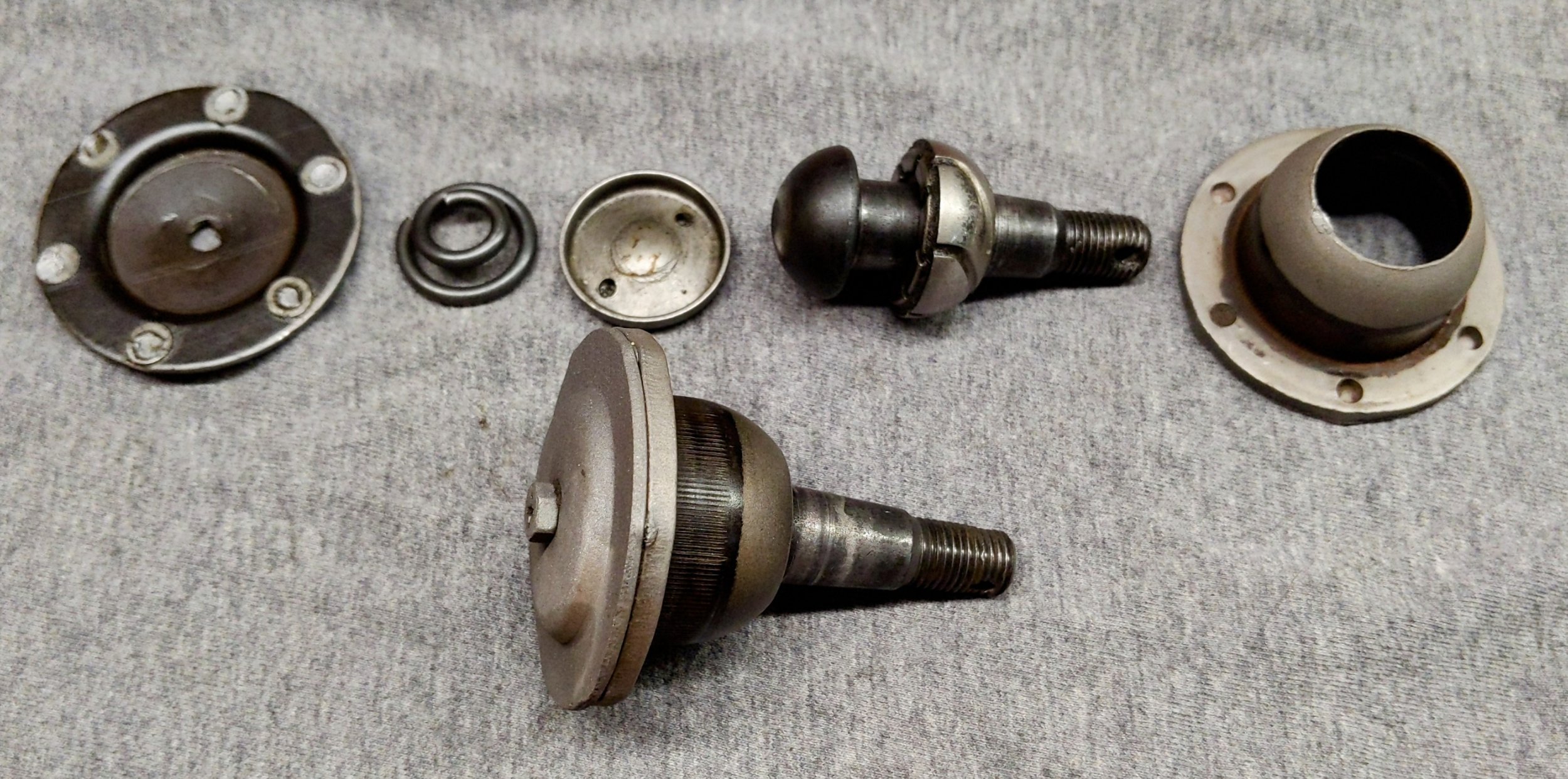

    I also made the decision to remove both lower ball joints, as I had no boots for either one, and generic boots I looked at weren't all that appealing, especially for a part/location which would easily get wet while driving. New ball joints are available for about $50 each, but I will see if I can find a set of NOS ball joints first. There were no issues with the ball joint sockets in either lower control arm, so I just need to clean that area up and they are ready for new ones.
    I did manage to blow one ball joint apart while pressing it out, as the old socket I was using bottomed out on the top of the stud, so here's the exploded view of a vintage NAPA Corvair lower ball joint:

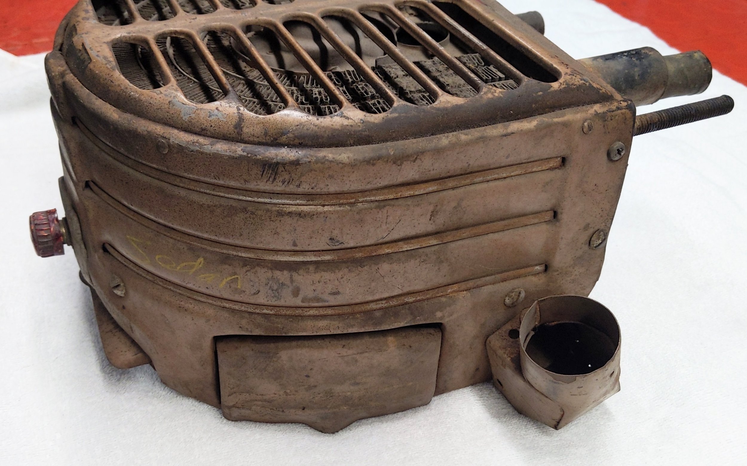

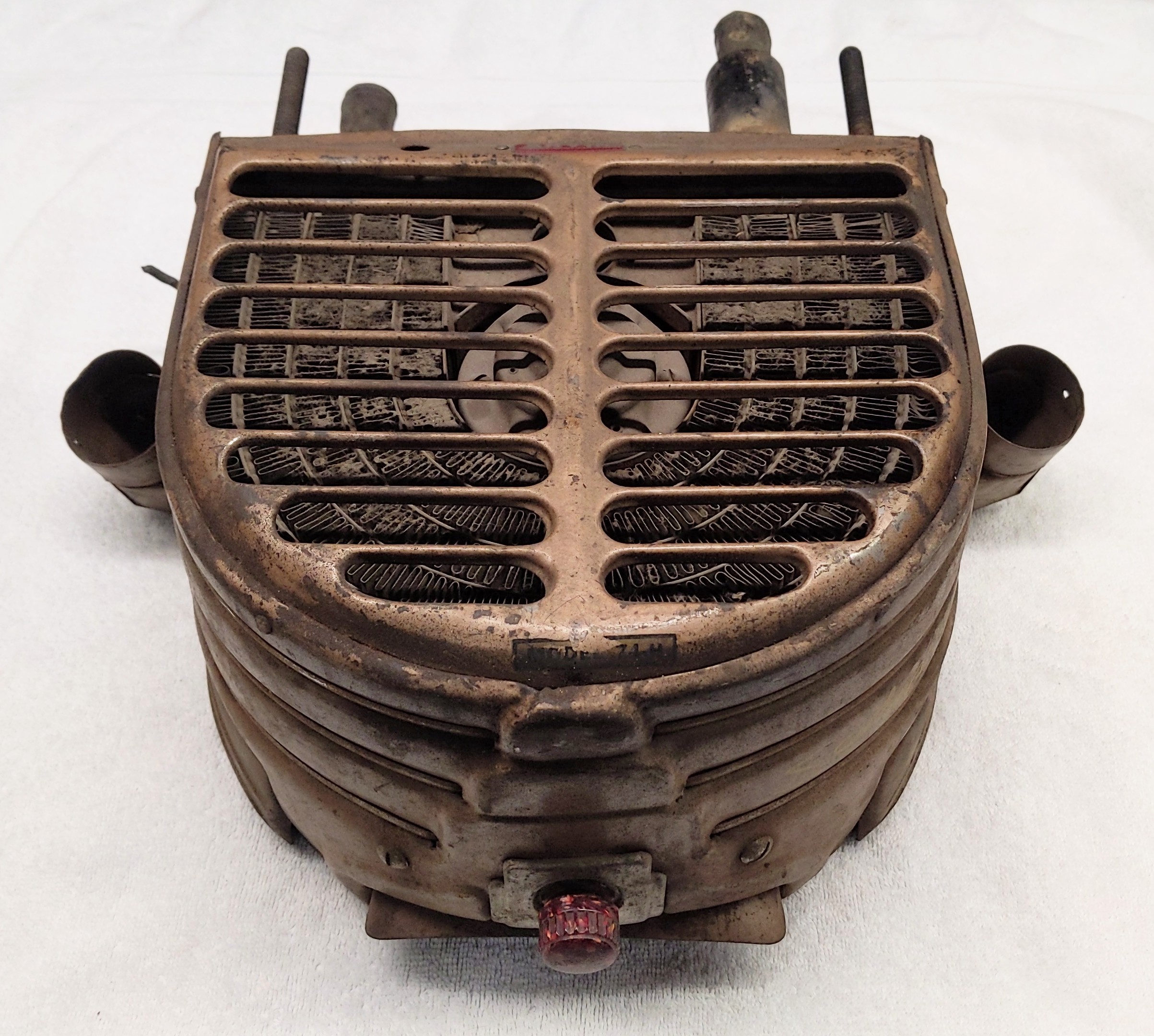

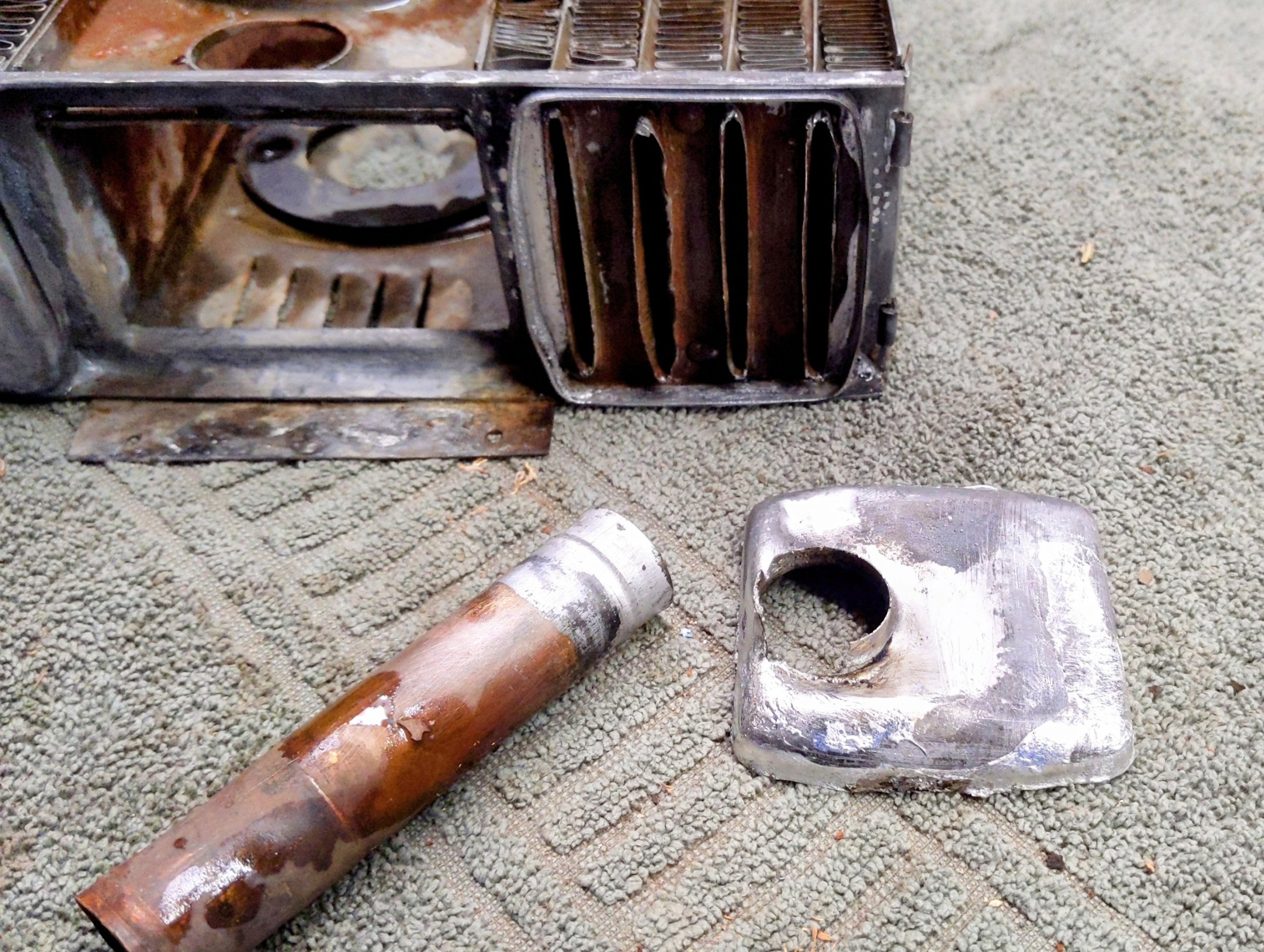

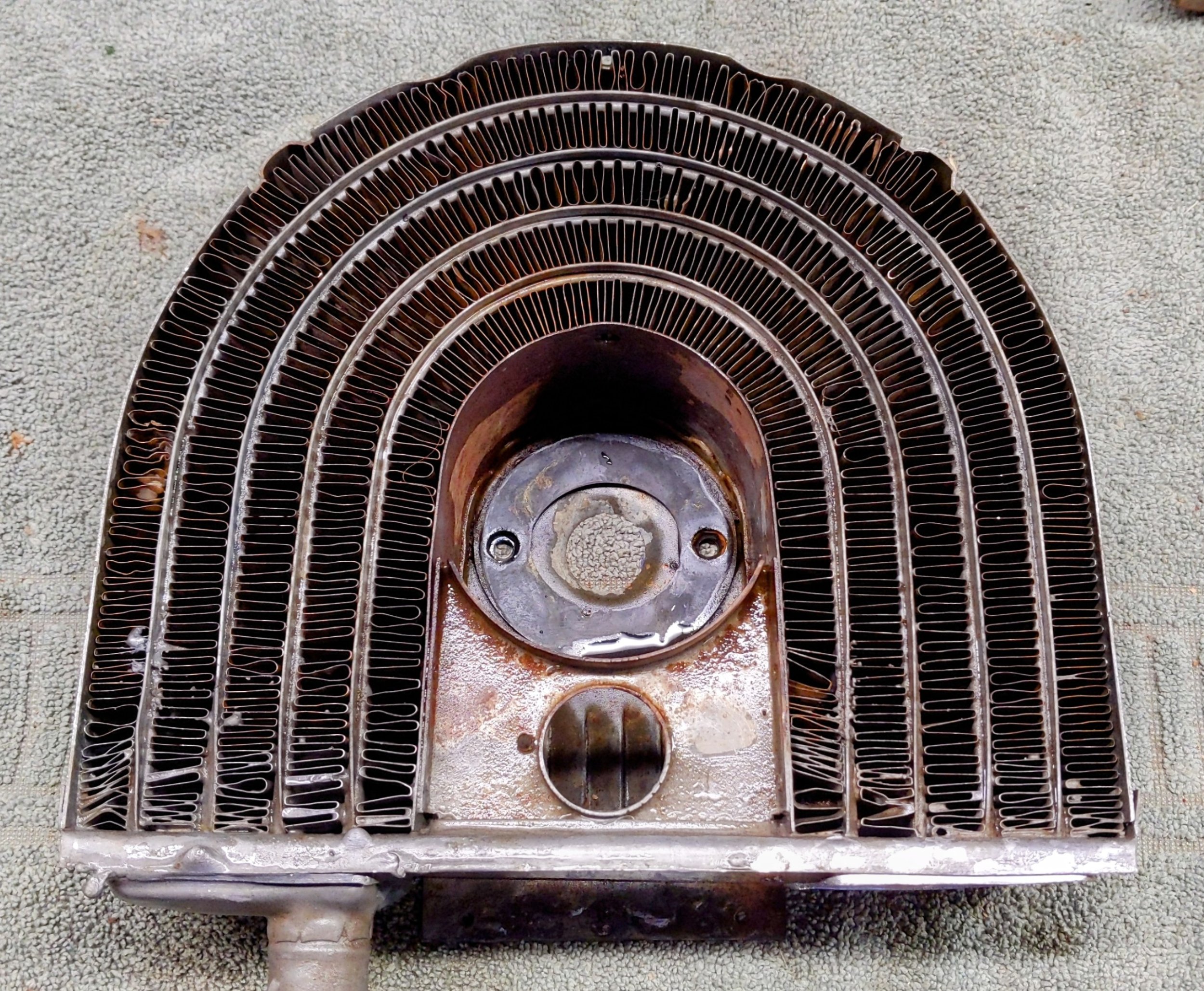

    I spotted this Arvin Model 74-H heater at a local indoor swap meet last weekend, which I felt was a better option than the other smaller heaters I already had, so, I bought it. It has built in left and right defroster ducts and is more flat/horizontal in shape, which I think will work better space-wise.
    Once home, I dis***embled it to inspect everything, and found one of the inlet/outlet tubes was previously repaired, but needed a new repair. Not ideal, but not unexpected for something used and old. The core looks good overall, and the only leak I found was the cracked solder joint, so I melted out the soldered-on end cap and removed it, as the flange was mangled and torn, hence the leak:
    I will get a new 12V fan motor to replace the 6V motor, which doesn't spin at all. Not sure if the illuminated red plastic knob at the front can be saved, but it does rotate, and the bulb socket behind it wasn't corroded. This should keep me busy until it warms up enough to head back out into the garage.

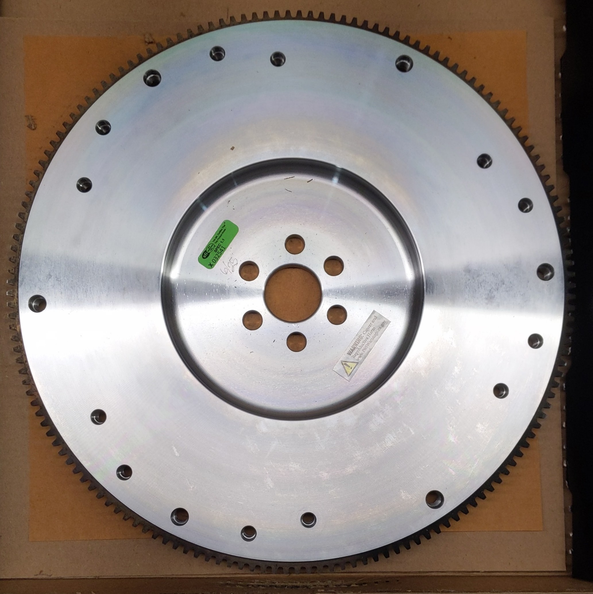

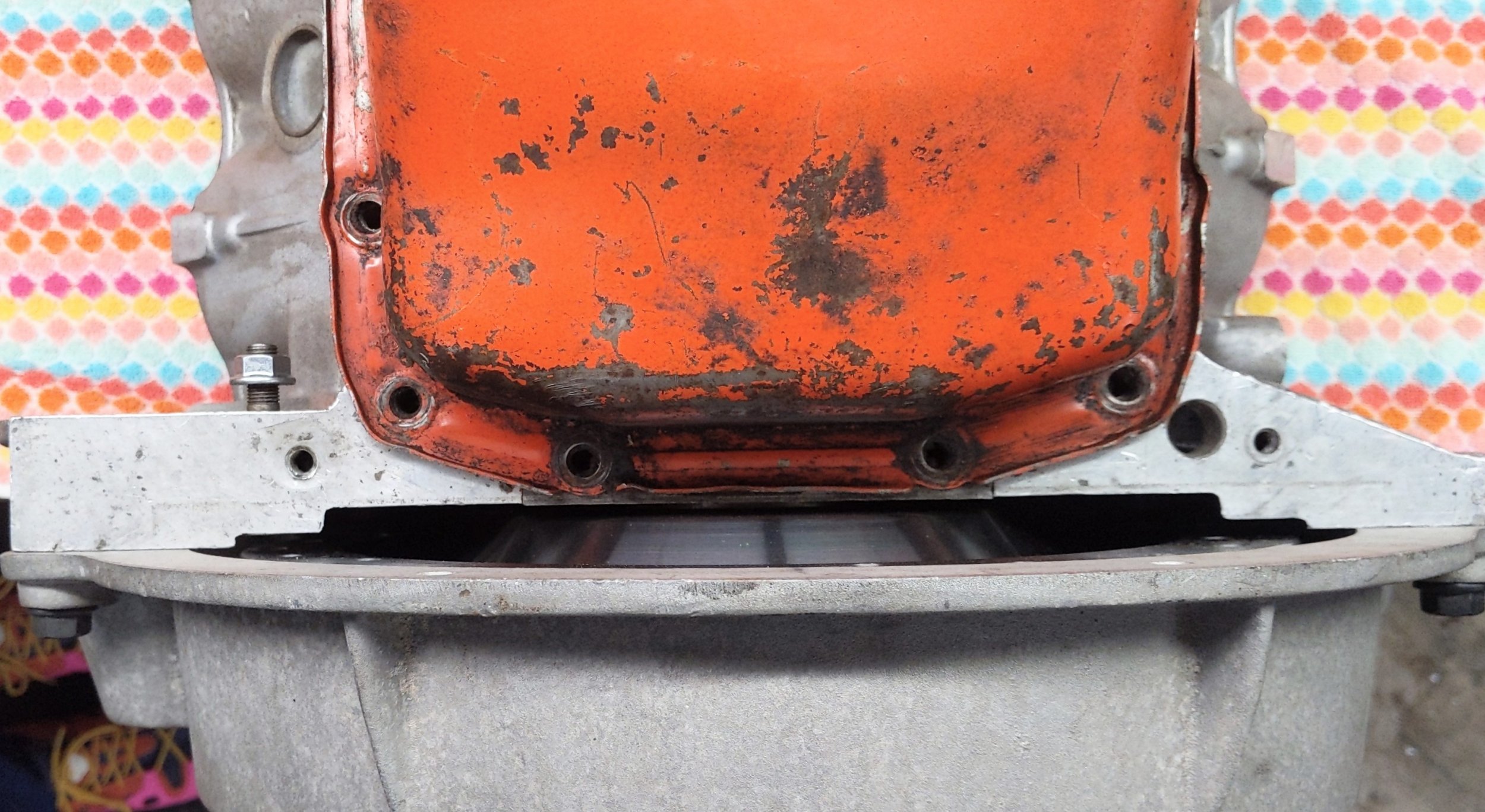

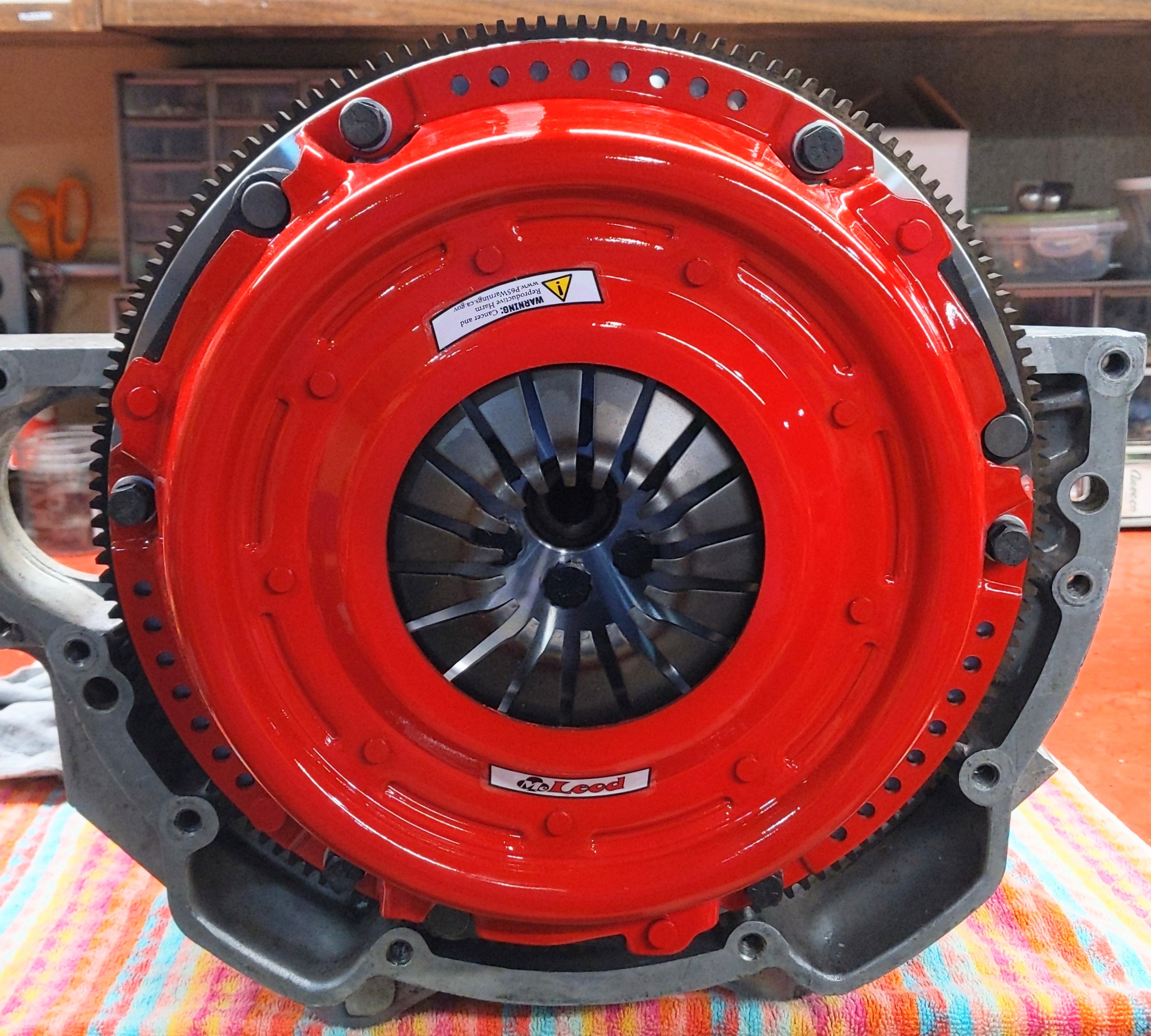

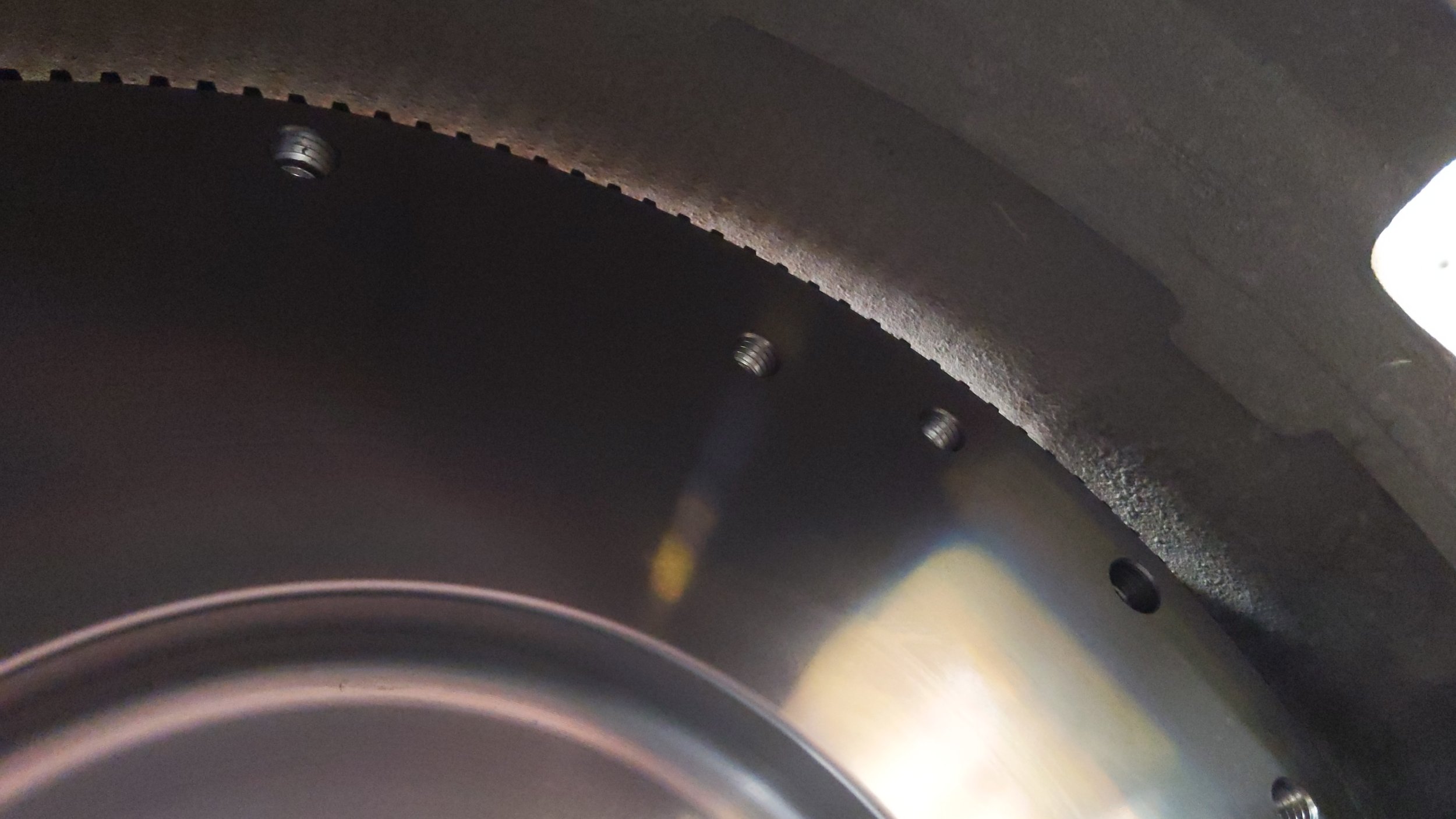

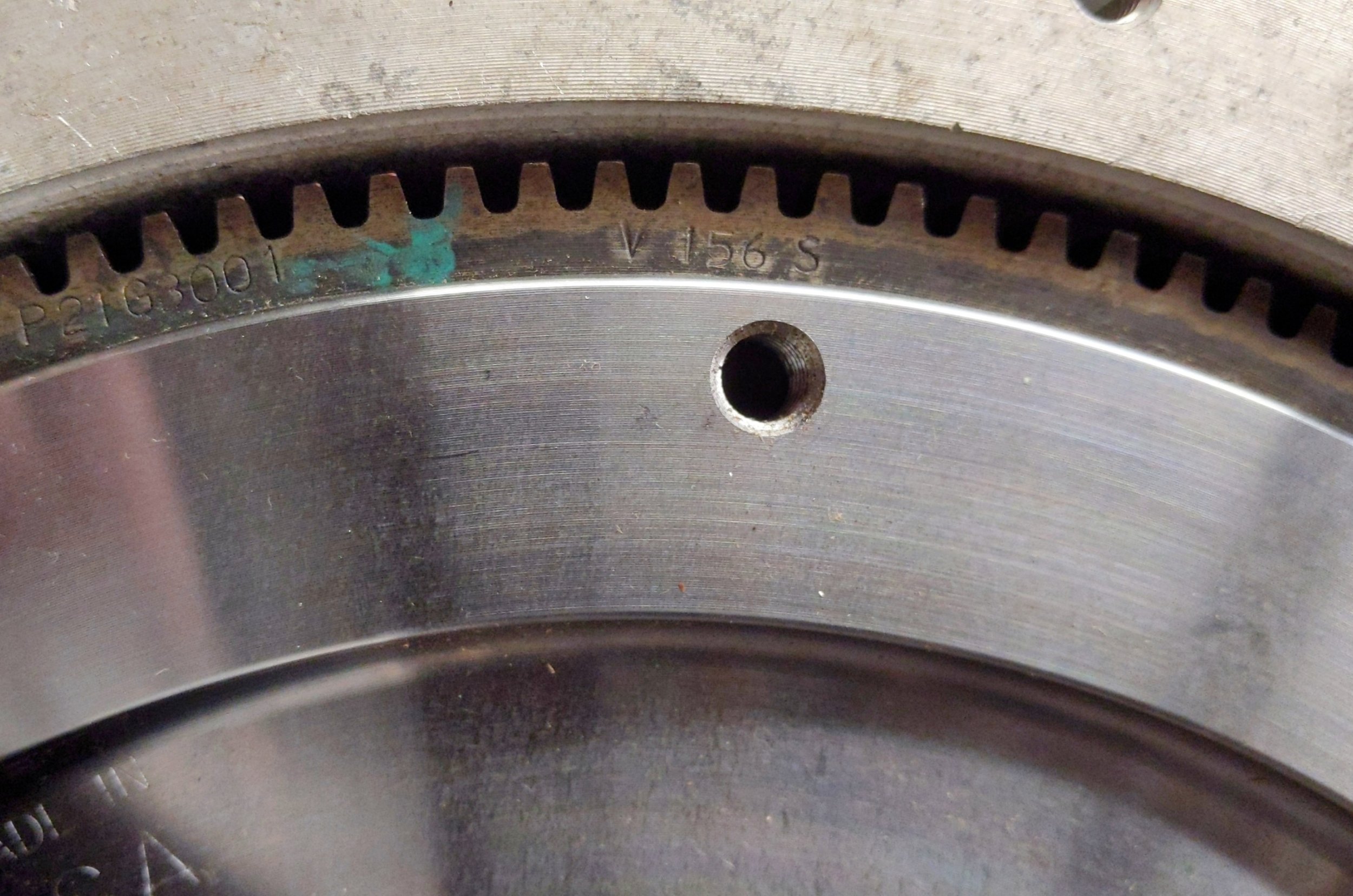

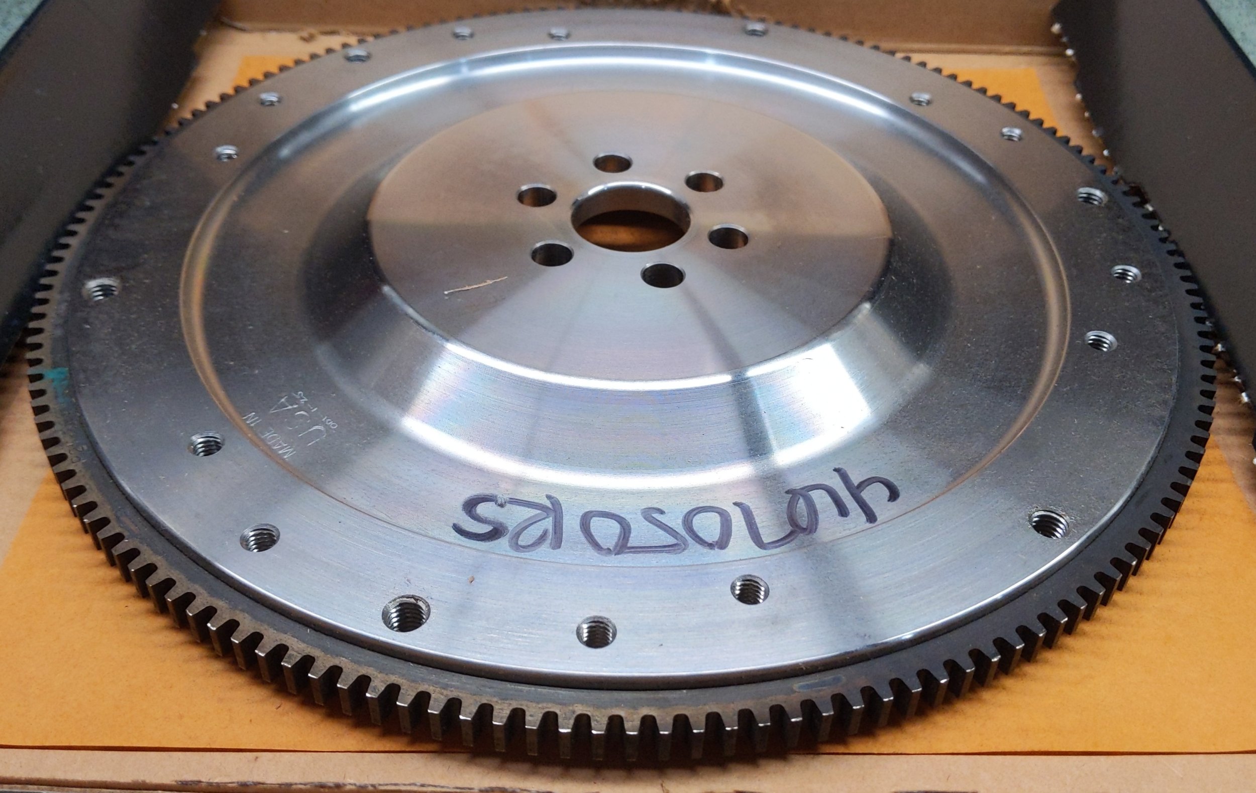

    I ordered a McLeod 215 flywheel through Jeg's on March 1st, and it arrived this Friday, so naturally I wasted no time test fitting it. Everything fits together, there's just enough flywheel-to-bellhousing clearance, and the starter appear to be in perfect alignment with the ring gear, too, though I have yet to apply power to the starter itself and check the pinion gear engagement.
    No complaints about the flywheel at all, it's a very nice piece. There are three pre-drilled pressure plate/clutch housing bolt patterns, so I ordered a 10.5" diameter clutch and matching diaphragm style pressure plate and will see how that fits when it arrives this coming Friday:

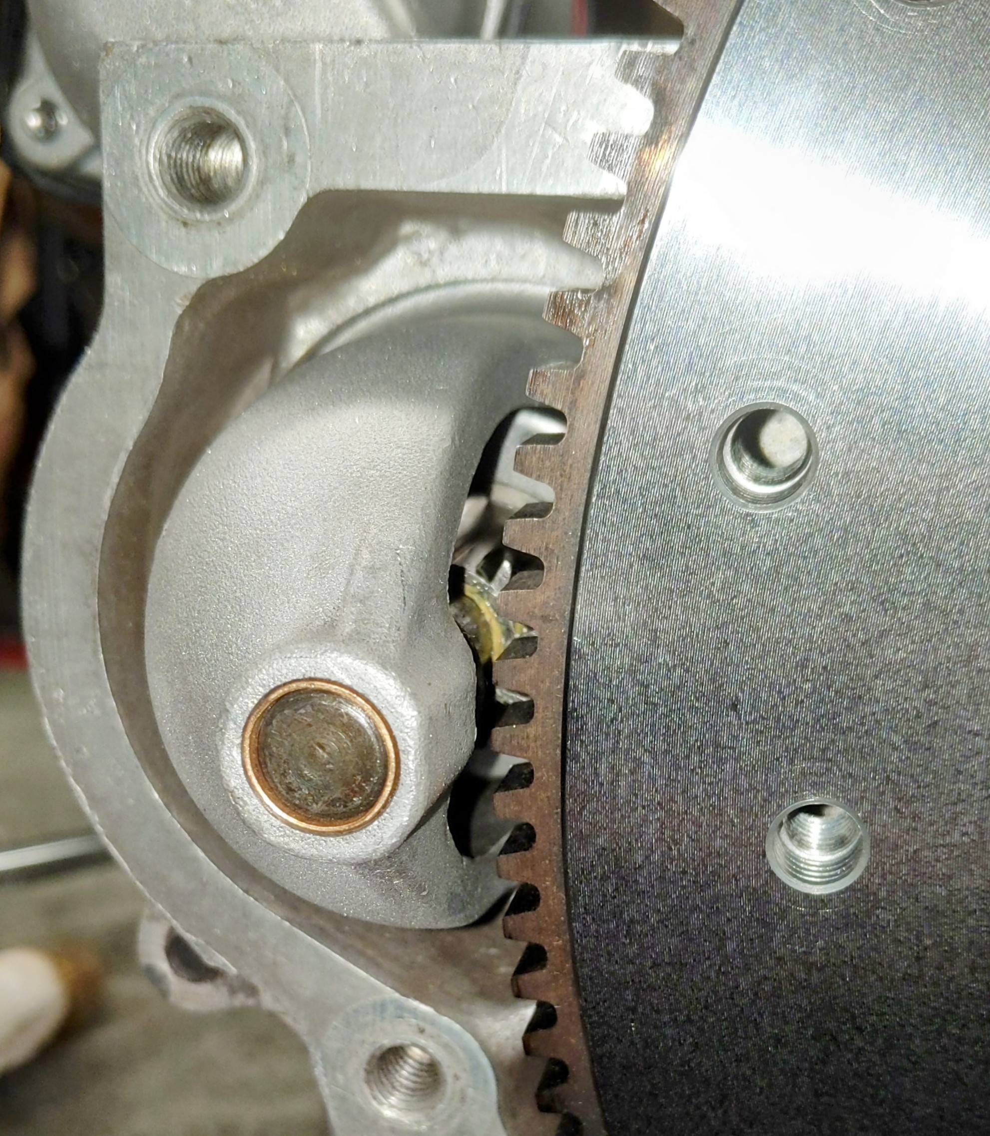

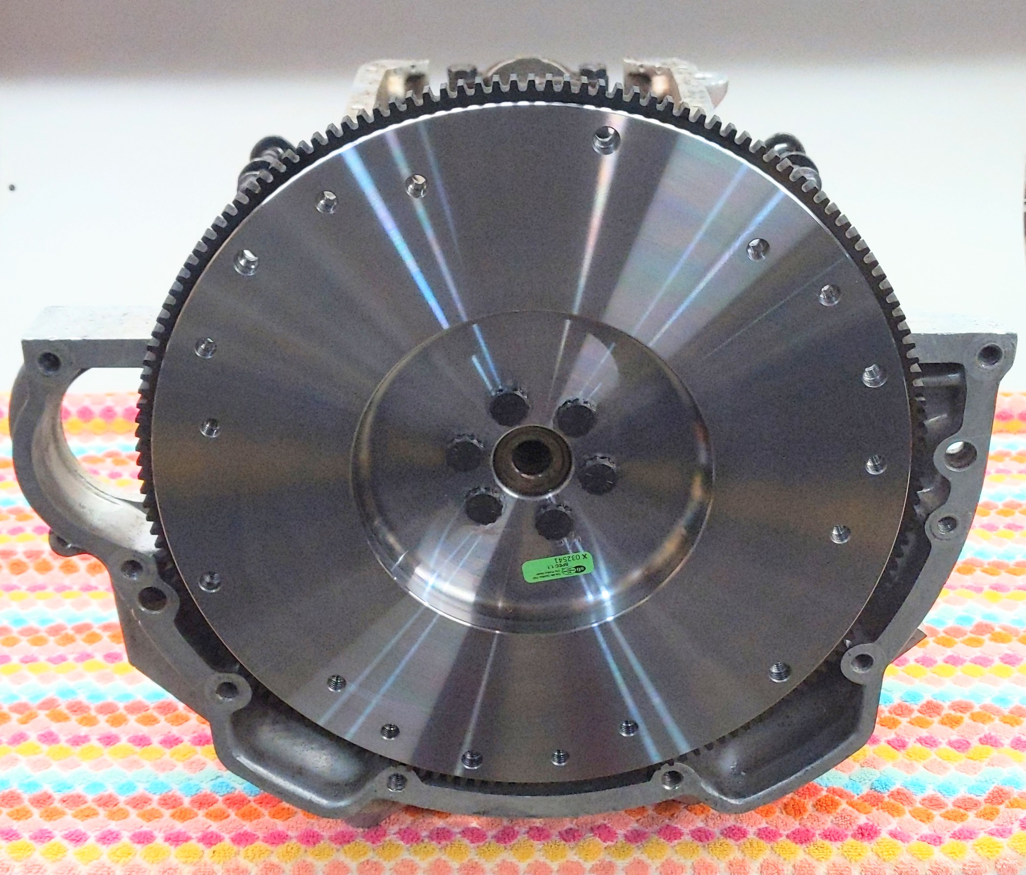

    Bolted up to the crank flange:
    Ring gear-t0-bellhousing clearance is tight, maybe 1/16" or less, but there's still room to adjust and align the bellhousing as needed:
    Starter pinion gear alignment looks good:
    I'm glad I didn't make a front shield for the bellhousing already, as it looks like I'll need to add a clearance bulge for the flared out flywheel center section:

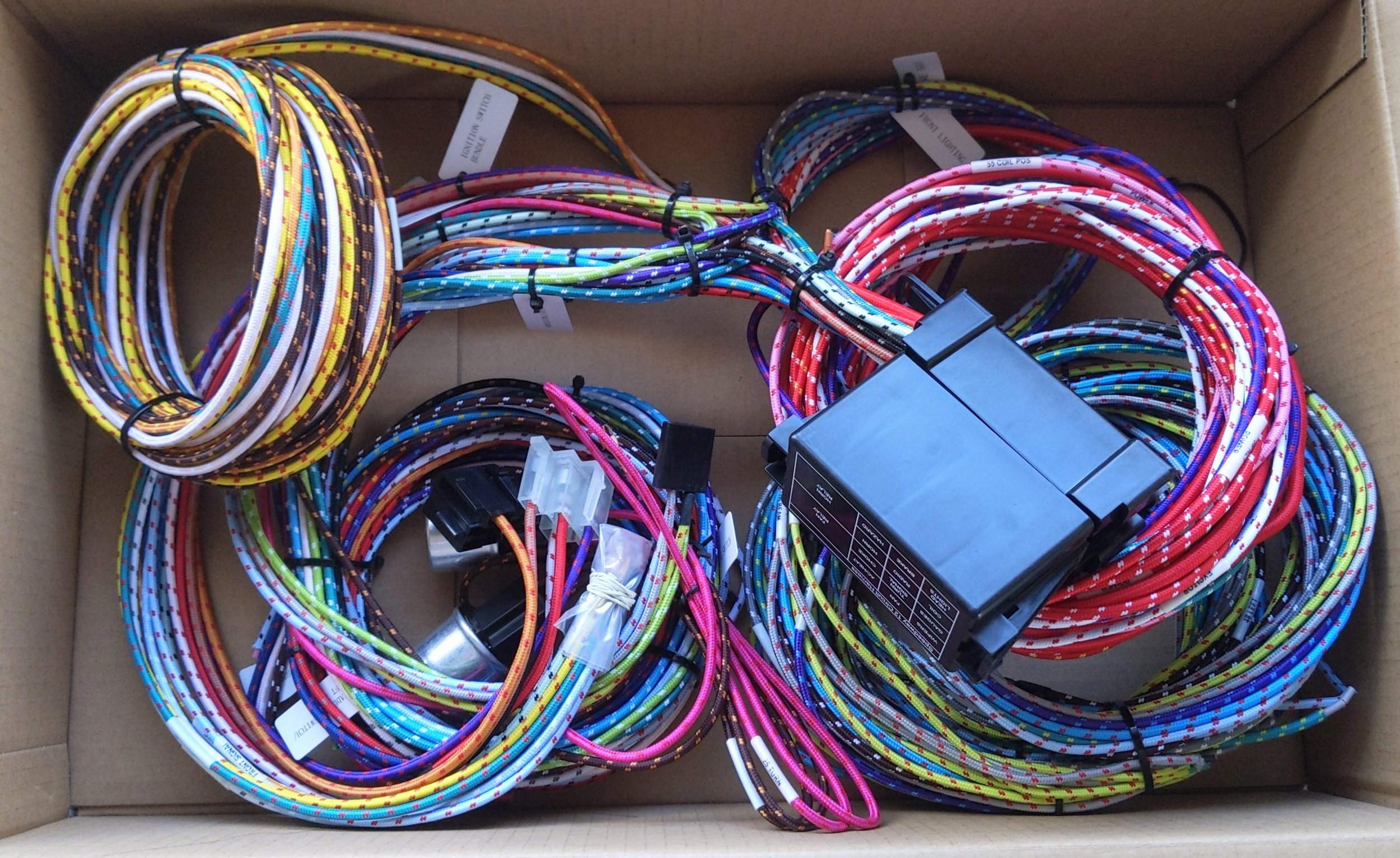

    I've had the link for this Speedway cloth wrapped wiring harness saved for at least a year, and Saturday I noticed it was steeply discounted, so I did not hesitate. :D It arrived today, and after a quick look over, appears to be just what I wanted for the most part. I will make some changes and toss out the cheap crimp on terminals provided, but for a basic wiring harness with a (mostly) vintage (maybe retro is a better description?) look, I'm pleased:
    The hot pink and lime green wires don't p*** the eye test for anything truly vintage, but they might be hidden on the interior side?:
    The more organic colors would be fine in an engine compartment, I think:

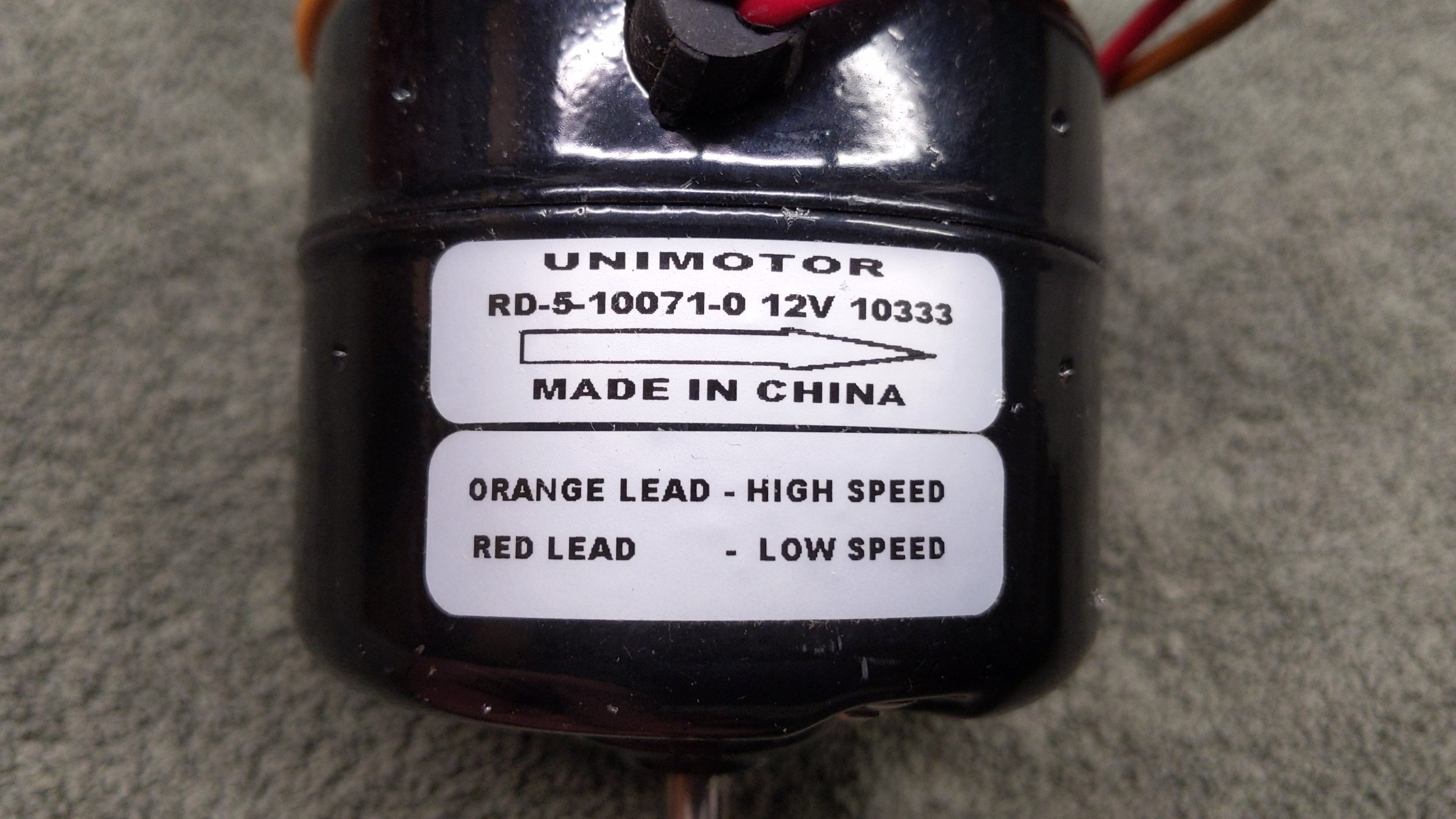

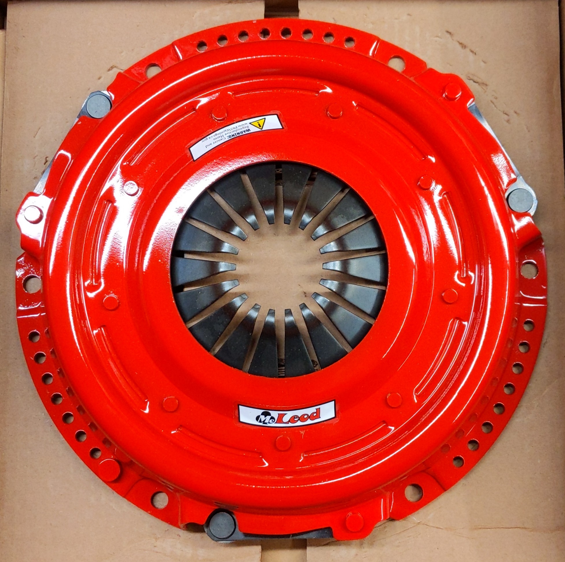

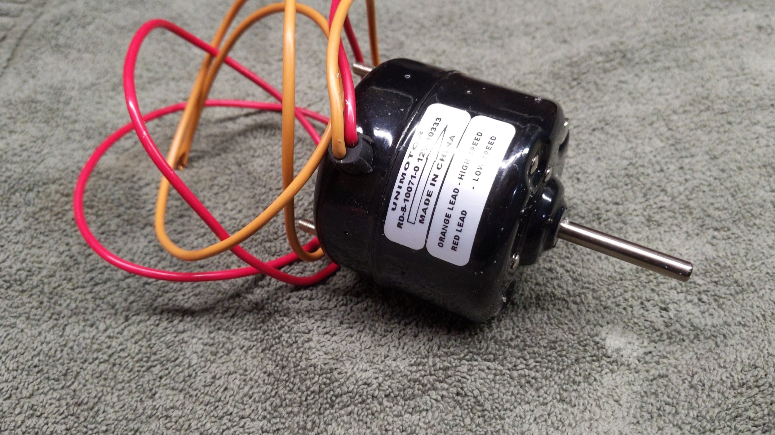

    A replacement 12V fan motor for the Arvin heater arrived a few days ago, and after a few modifications, a test fit revealed no issues. I now have both low and high speeds with no need for a separate resistor, which should work just fine. I still need to repair the heater core end cap, clean up the housing, figure out the switch...

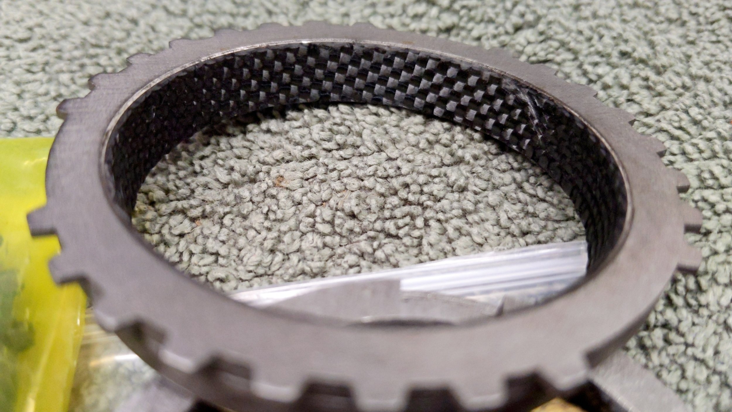

    I also ordered a new McLeod clutch set Thursday, which arrived today, and with the test fit complete, I am moving on to figuring out which clutch fork I need to order:

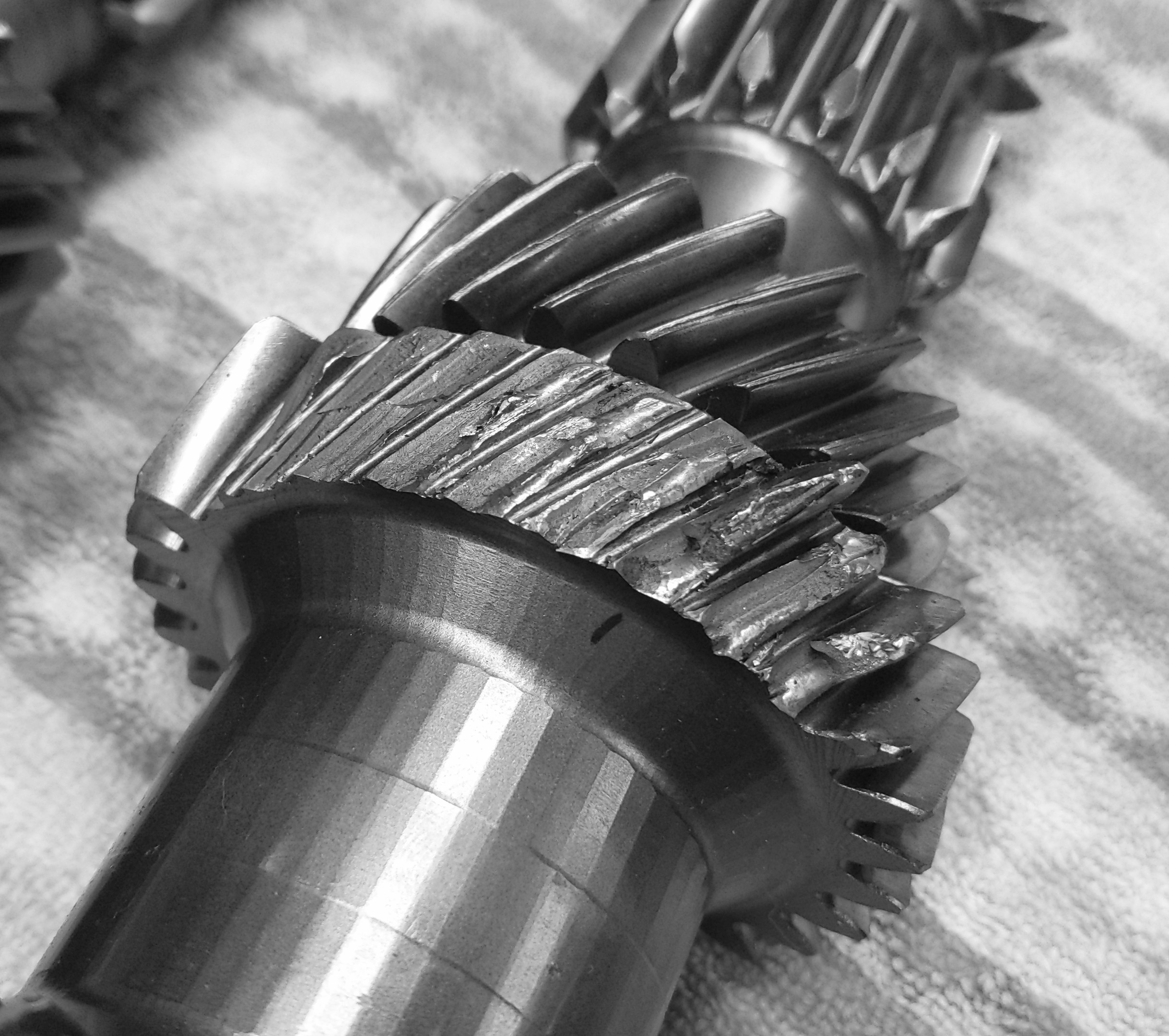

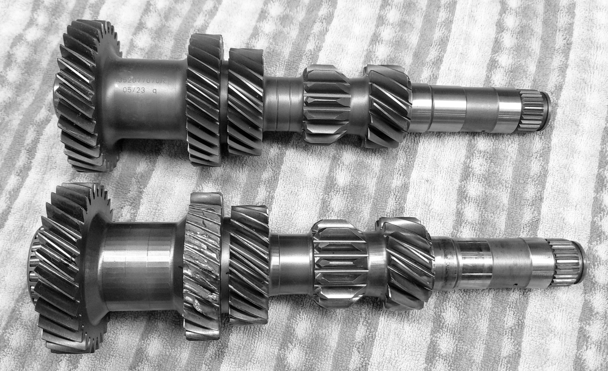

    I also picked up a new T5 countershaft, as the old one is, um, not good:

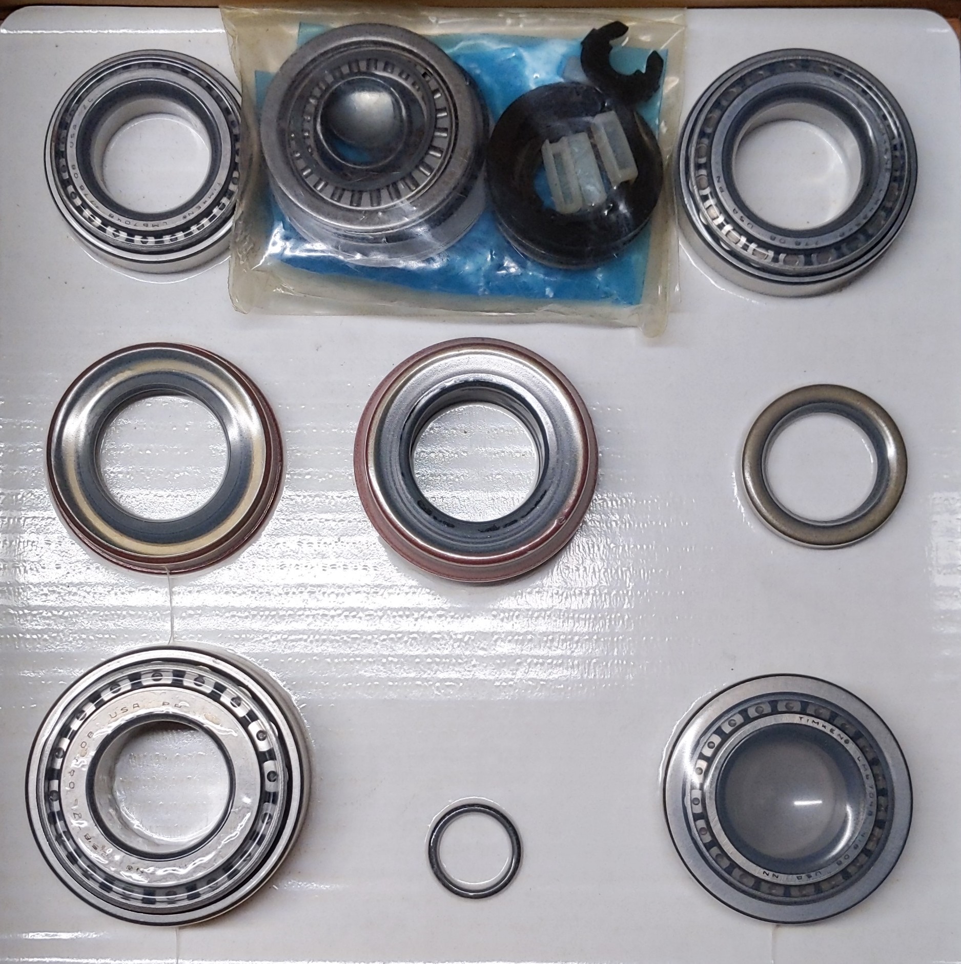

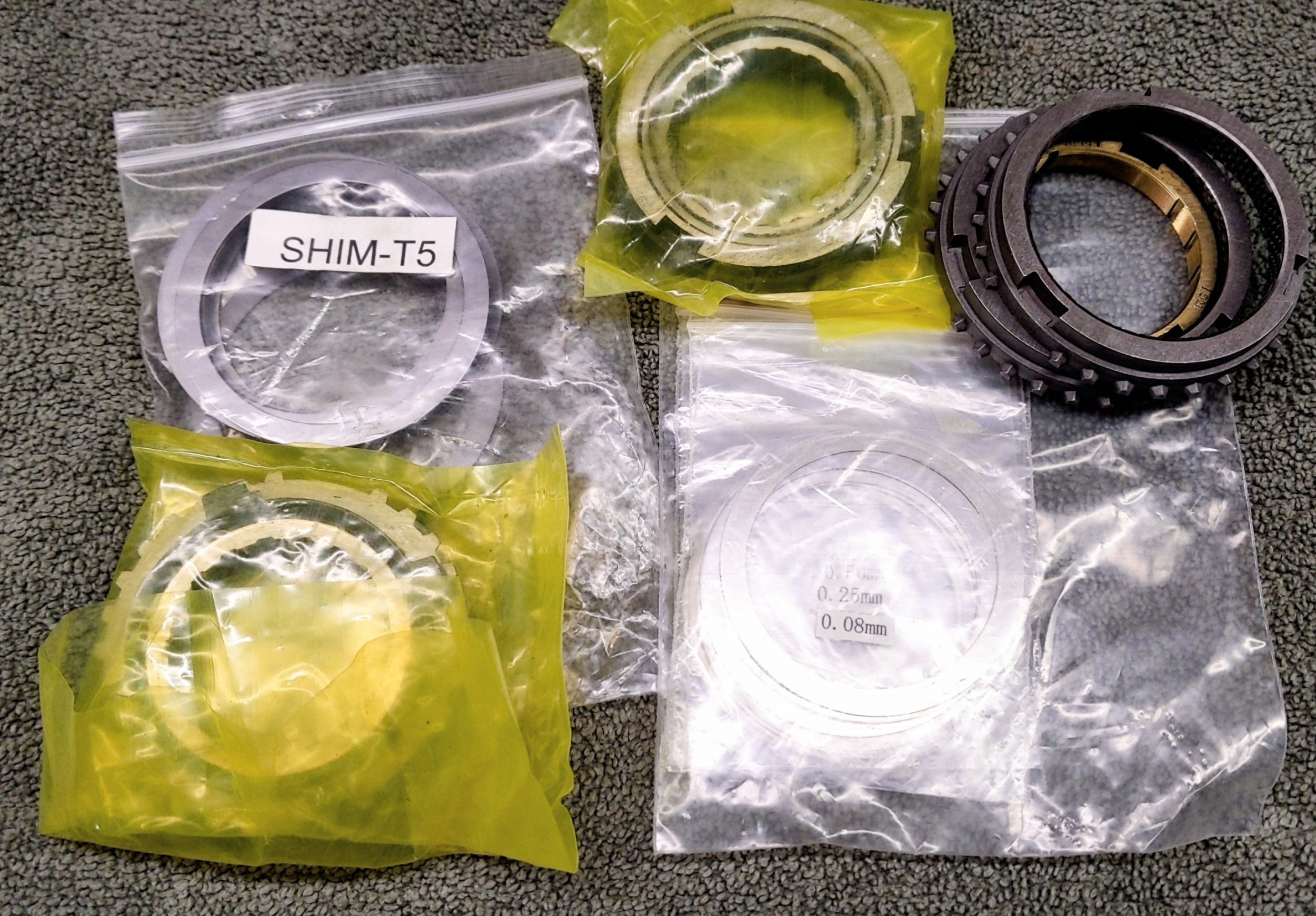

    I purchased a few more needed items recently, starting with a Motive Gear 3.55 ring and pinion gear set for the 8" Ford rear...:
    ...bearings, shims, blocking rings, and small parts for the T5 from Allstate Gear...:

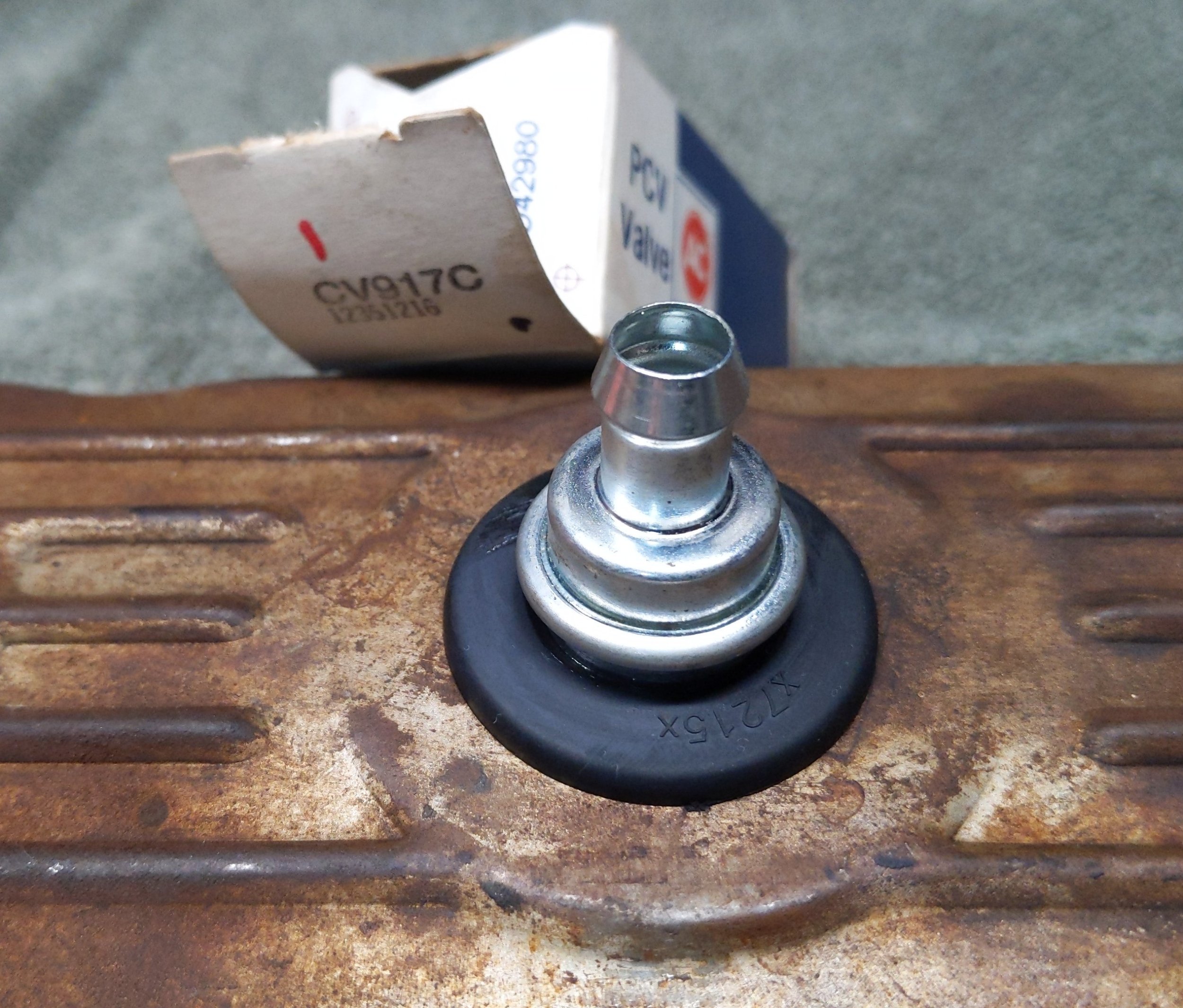

    ...a NOS AC Delco PCV valve I discovered under a shelf at work, and some matching PCV grommets from ebay which are surprisingly nice:

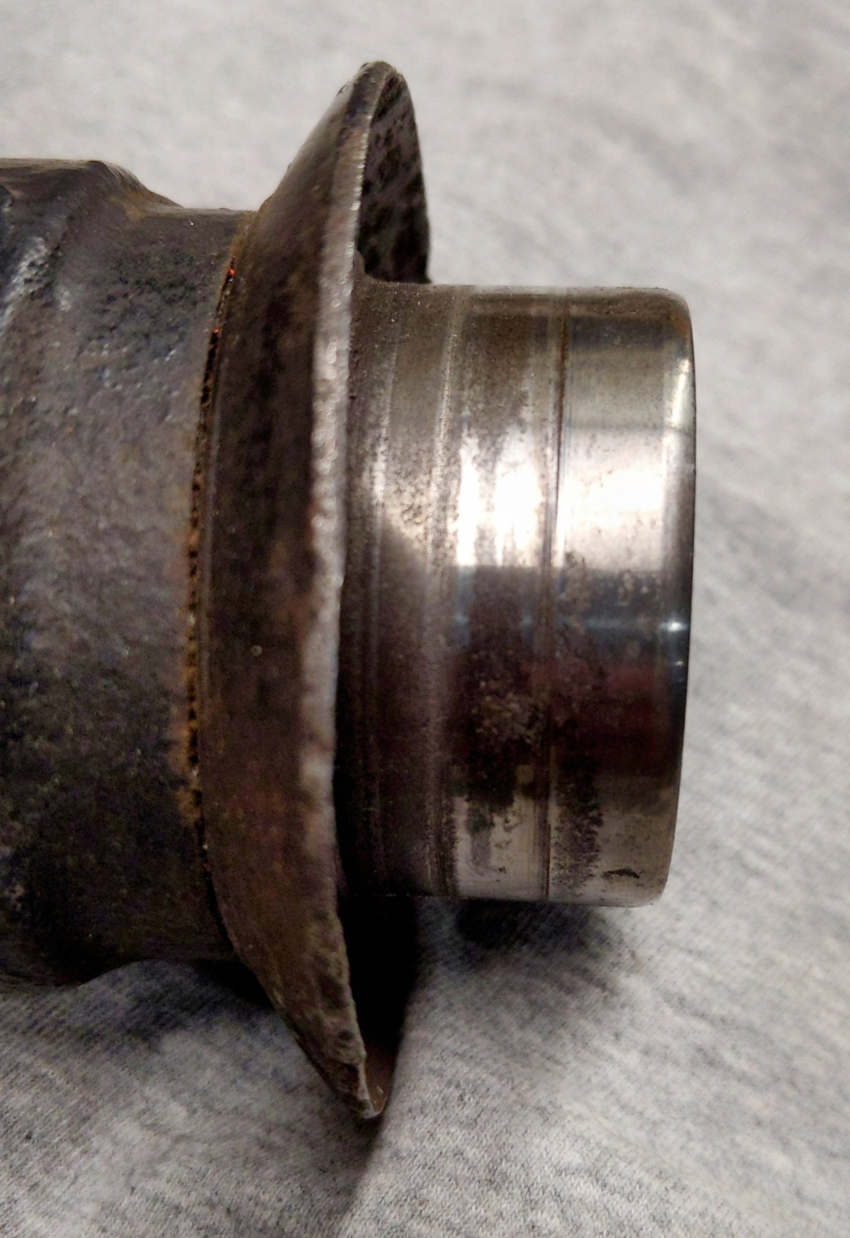

    The only bummer was looking at the differential related parts again and noticing the pinion yoke is scored/grooved in two places, so I either I try a repair sleeve or buy a new yoke instead:
    I won't start rebuilding the T5 until I know for sure I'm done using the empty case and tail housing for mock up purposes, but I have 95% of what I need to rebuild it on hand- seems like a good winter of '25/'26 project.
    Toms Dogs, brEad, Squablow and 5 others like this.
