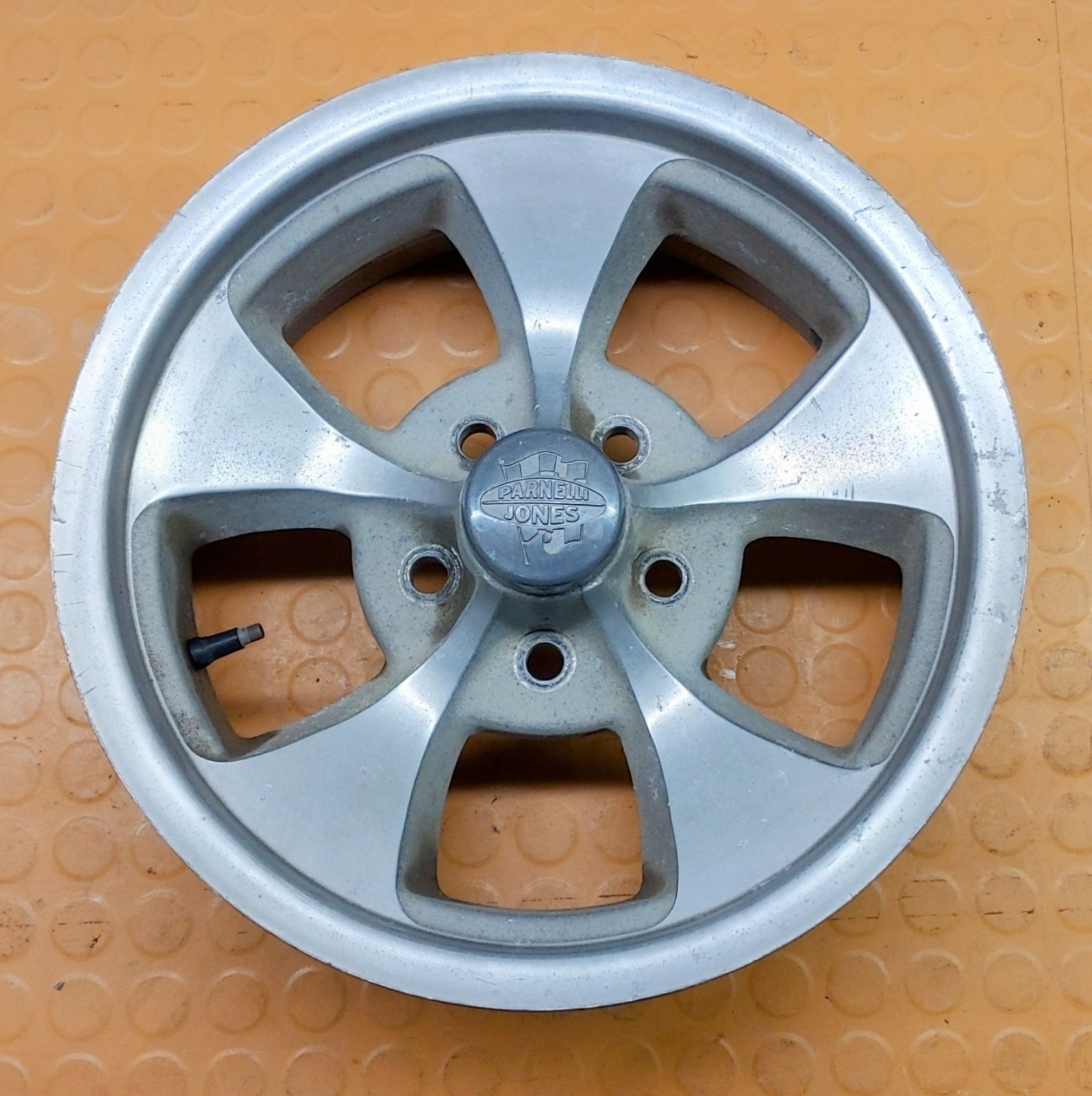

  12. 24riverview
    Joined: Jan 13, 2008
    Posts: 1,122
    24riverview
    I was reading through your build thread the other day and was surprised to see these wheels. I saw them at their "estate" sale a day or 2 before you got them. They were stacked up on the cement outside one of the buildings, looked like they'd been there quite a while. I asked one of the boys how much, $75, being a cheap *** (and not really needing them) I offered $50. Told me he'd need to discuss with a brother, took a while but before I left the price had gone up to $400. Probably the reason they ended up wherever you found them, hope you got them cheaper than that!
  13. In_The_Pink
    Joined: Jan 9, 2010
    Posts: 980
    In_The_Pink
    I saw them on fb Marketplace Saturday evening, then committed to driving the 8.5 hours round trip to get them Sunday morning, asking them to do me the favor of holding them for me. They did, which I appreciated, so I paid the $400 and drove home happy. The wheels were on their father's Studebaker previously, so I liked the idea that they might be used next on a Nash.
