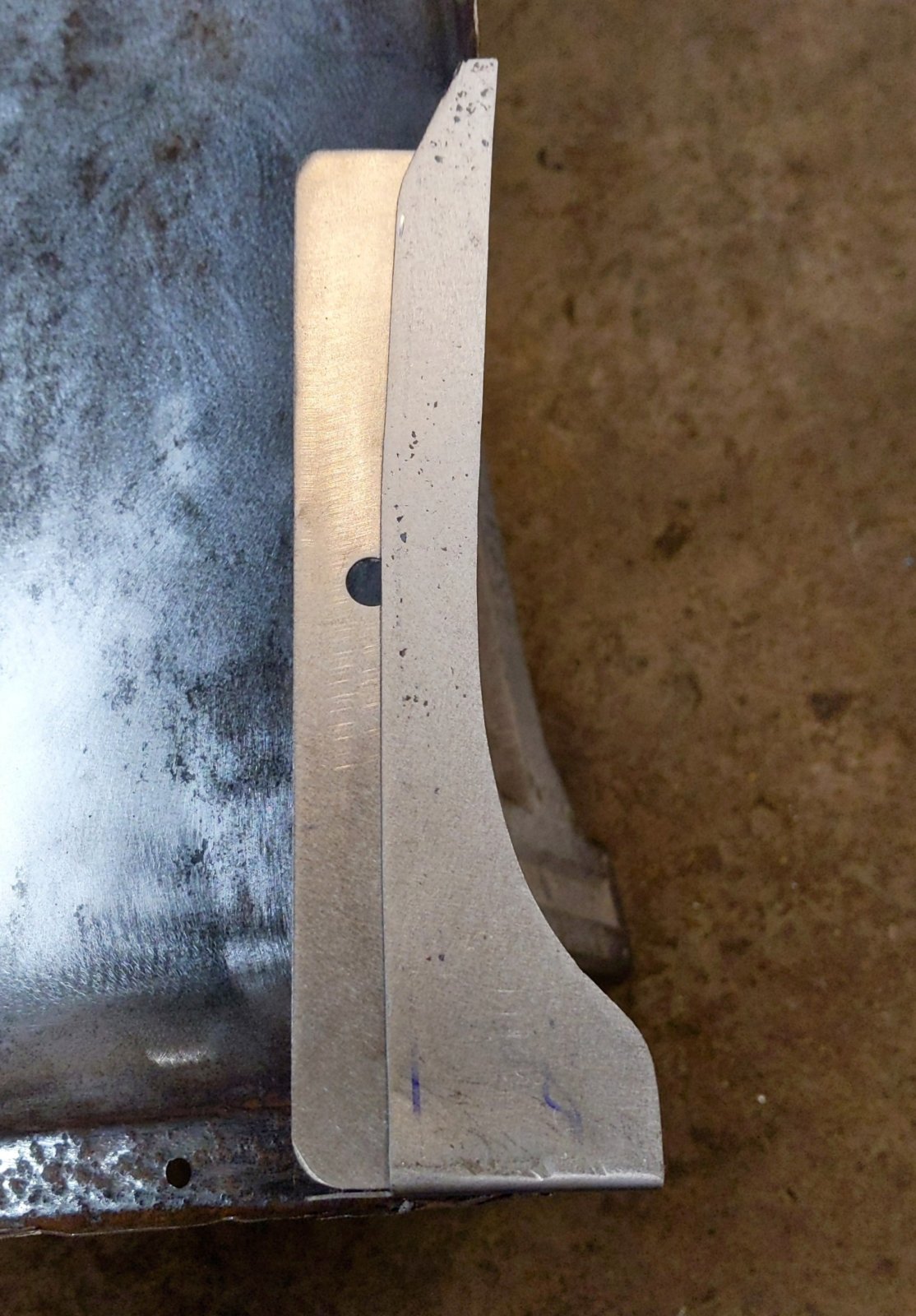

    In an ideal world, I would install a fully rebuilt Olds 215, but I have plenty of items to scratch off my to-do list and spend money on first, so the Buick 300 is the engine for now. I was waiting to see if the oil pressure and compression numbers in the '66 300 were acceptable before going any further, and now that I know both are, I can slowly collect the Olds 215 parts.
    I removed the RR quarter panel last night and started repairing the rusty areas and replacing the metal which was no longer present. The size of the panel makes things a bit ***bersome, but having a panel which can be taken off and put back to check the fit often is a wonderful thing.
    I had to remove the previous inner flange I made, and made it an inch wider, closer to the factory piece in width. The lower rear quarters, rear valance, and inner quarter have two bolts per side which, as far as I can tell, were used to hold everything in alignment before the final welding and brazing was done. The four bolts were not easy to access when I dis***embled everything, so I may only retain two, but the bolts (and their matching holes) are very helpful for aligning the panels now as I piece things back together.
    New inner flange welded in place, and inner face ground flat, in preparation for...:
    ... the new outer flange:
    I made the piece larger than necessary so I could weld, trim, and grind on some metal m***, creeping up slowly on the final rough shape. I still need to patch in the vertical and concave sections here, but I'm happy with the progress I made. At least now there is something string and positive to use for alignment:
    In the last image above, you can see the fender washer and flanged nut used to retain the bolt though the alignment hole. I still need to grind the plug welds flush, too, but it's now solid enough to work off of and continue making progress.

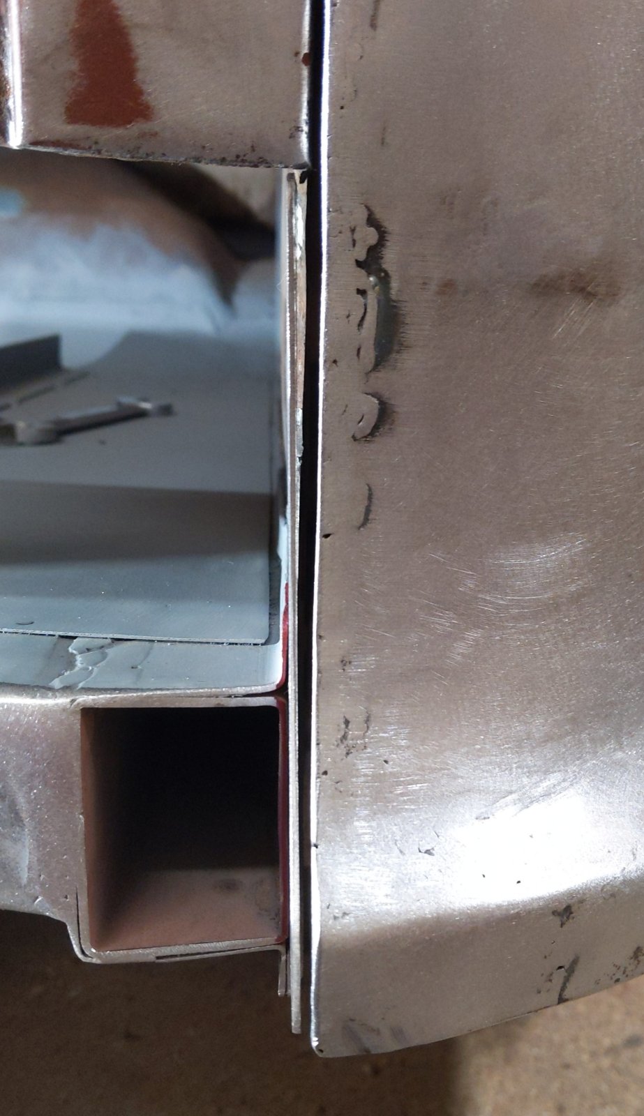

    Probably spent a bit too much time smoothing casting seams and rough spots on the intake manifold before I primed it, but I want to get it installed before I wrap the engine up for the winter, so at least it's primed. Next week when it warms up a bit I'll finish paint then install it.:
    Yeah, it's a 2-bbl. Not ***y, but the only other option is the one-year-only '65 4-bbl manifold, which is also cast iron and not very common, so this'll do for now.
    Also had some time this evening to do a bit more work on the right rear corner, welding and grinding the quarter panel's flared lower edge again, so it's in better shape now. Still have one low spot from a crease I couldn't quite reach from behind, but otherwise the metal in that corner is close to finished. Good thing, too, because I need something to use as a reference for repairing/remaking the valance panel which sits between the left and right quarter panel ends. As seen below, the last few inches of the valance panel (right side shown) are completely rusted away:
    The back (inner facing) side looks worse than it is, as the visibly rusty sections never received paint from the factory, so I am going to media blast the panel and hope for the best. I am not going to use the lower lip/flange, so that'll save me a bunch of work.
    Back on the body, I tack welded the rear edge of the quarter panel to the filler piece next to it, to keep things (mostly) aligned while working on the valance panel, then made a pattern for the new valence panel flange, and cut it to shape:
    More test fitting and adjusting, then adding the bolt hole so all three panels can be pulled together:
    Still a bit of fore-and-aft misalignment here, but I will m***age that when it's time to install the quarter panel permanently. The new flange matches the quarter panel contour well, and leaves a consistent gap which will be filled by the valance panel patch once in place.
    My plan is to fully weld the vertical seam where the quarter, filler, and valance panels all meet, instead of a combination of bolts, spotwelds, and brazing as was done from factory.

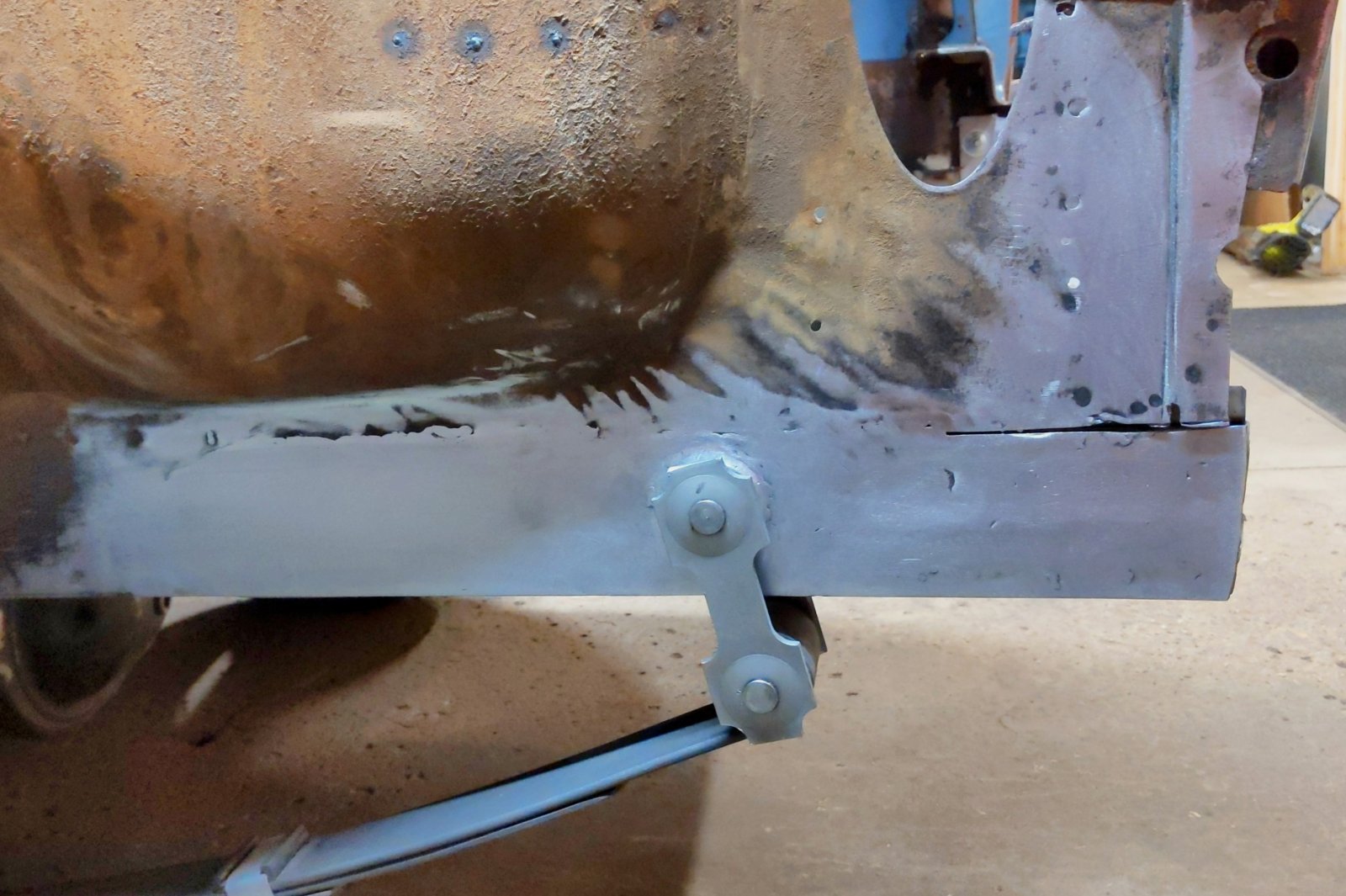

    I figured I should work on narrowing the rear axle while I have both quarter panels removed, so I mocked up a 15x7 and 15x6 wheel, checking the fit with the right quarter panel in place. I am thinking if removing 3" from each end of the housing, so that should still give me room for a 4" backspace wheel if needed. My main concern is if there will be enough space to remove a wheel and tire in case of a flat tire, due to the 'fixed' skirt section on the quarter panel. The stock wheels and tires weren't an issue, but 4.5" wide wheels... yeah, not happening.
    Clearance is better with the 6" wide wheels, as expected, though both wheels are still half an inch outboard of where they would be with 3" of housing length removed:
    A bit tight at the outer lip with the 7" wide wheel now:
    Still more measuring and checking to do before I cut the housing ends off. It does look like the emds were slipped into the axle tube (Ford 8", 2.875" O.D.), so I should be able to cut them free, and have the I.D. turned at a shop. I have a miniature Sherline lathe, but 3" is the max O.D. I can work with, so I'll have to find someone to do it for me.

    Not a bad idea for a pivoting suspension, provided the driveshaft, shocks, brake lines etc. were all factored in the final build, pulling the rear shackles, would be easy enough, maybe those following along have some creative ideas.

    Thinking about it a bit more, if a rear tire goes flat, that should make it a bit easier easier to remove compared to when fully inflated. I plan to carry a space-saver spare, so fitting that up inside the wheelweel shouldn't be a problem. I think I am in the clear with the 6" wide wheels after checking out tire section widths last night.

    That or delate a fullsize tire to get it in. My thinking is if you can get the old one out you should be able to get a new one in...The spacesaver is a good one as well...gets you back to the shop or somewhere you can take your time...
    Truth be told I can't remember the last time I had to change a flat...But when they have to come off it has too...
    Maybe you could make a plate on a solid point on the floor/frame area above the rear end and use a small scissor or hydraulic jack to push the rear end down enough to ease removal and install then release once in...
