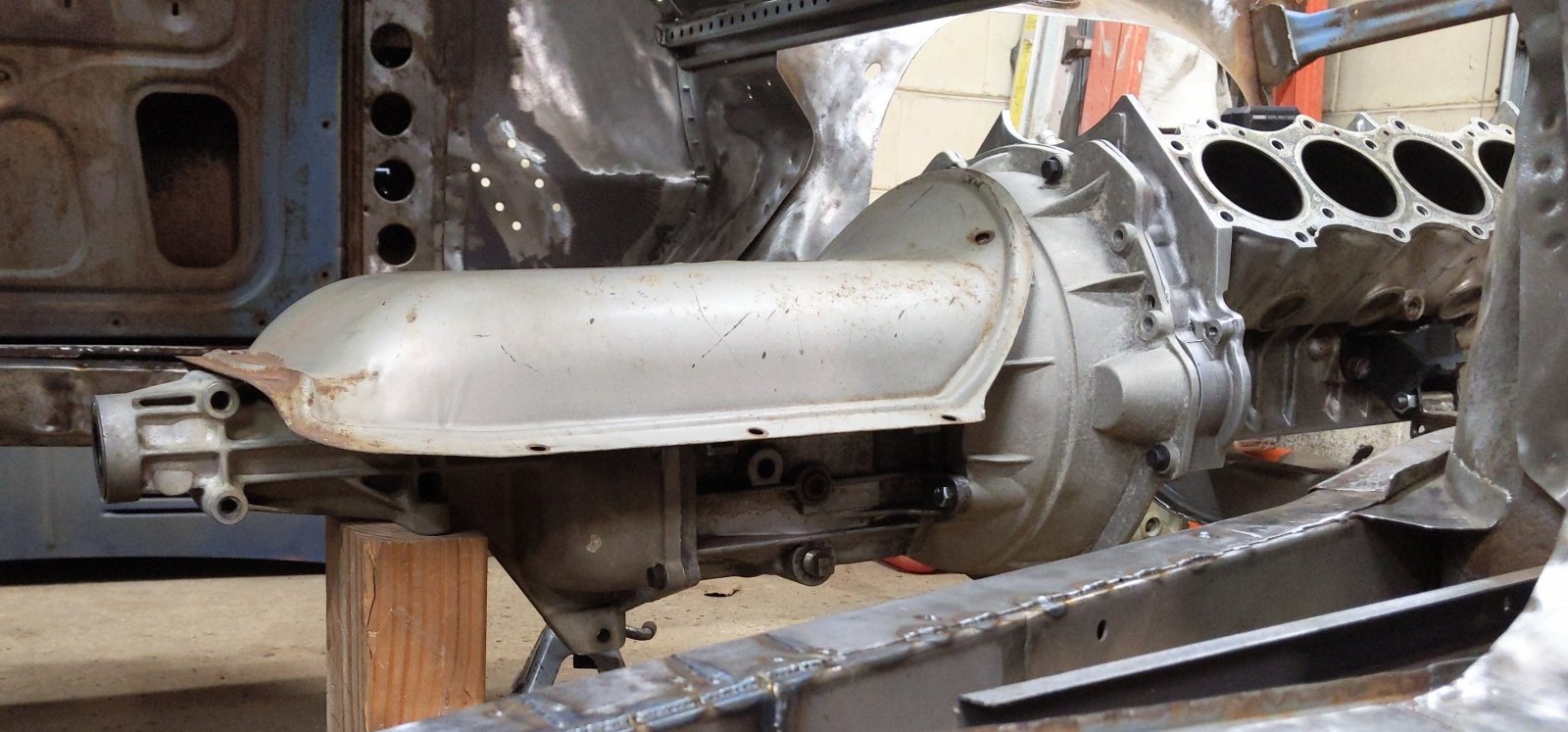

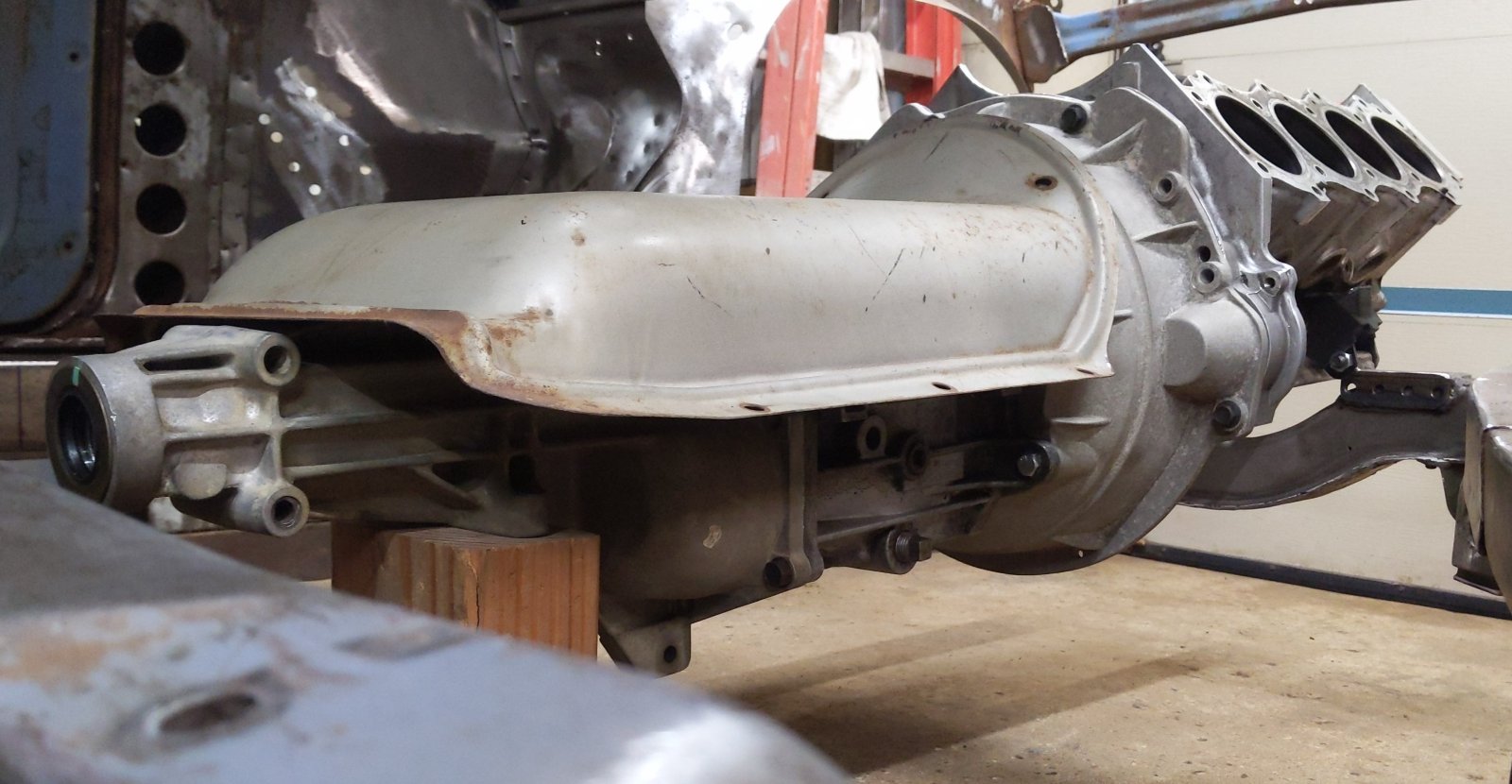

    I also placed the block, bellhousing, and transmission back in place, to confirm where the mounting points for the transmission line up. I knew I needed to make a new trans mount, but the rearmost brace holes (technically not the weight-bearing mounting point, but used to externally brace the tail housing and main case) line up directly on center with the forward channel brace which runs across the floorpan, connecting the two framerails:
    This channel brace (at extreme right in image above) was perfect when a bench seat was being used, as both it and the rear brace were covered by the seat once installed. If I want to use bucket seats, both braces will stick out like a sore thumb between the seats, but I could place a console between them and, problem solved...or, I could find another bench seat. I'm not a big fan of bench seats, but they do have a certain charm. I don't forsee any shifter interference with a bench seat, so maybe I should consider a bench seat more seriously.
    I have, up to this point, intentionally tried to avoid removing one or both of the factory channel braces, as they are an important part of keeping the unibody together, and both are in great shape. I think I can make a new mount for the trans, and tie it into the existing channel brace with some new steel, without needing to create and entirely new crossmember.
    The rear end of the driveshaft tunnel has a slit cut (maybe part of the stamping process?) into it for...well, I'm not sure what the purpose was honestly:
    The driveshaft tunnel is a bit narrow, as the original driveshaft was puny, so I'm hoping I don't need to widen the tunnel along its full length. There is plenty of vertical clearance, but I think side-to-side clearance is going to be very tight. I am already making a new tunnel section around the trans, so it wouldn't be a huge deal to make a new driveshaft tunnel, just a lot more work.

    Following along, you have taken great pains to select the best part for the job, and worked to integrate it well. I've got faith in that new heater!
    Could you porta-power the tunnel wider, or is the height too close too? The tail on the trans looks like it's below the plane of the floor.
    If it needs to be taller and wider, there is no way but replace.

    The entire floorpan and tunnel is funky in this car, so it could all end up being replaced... we shall see.

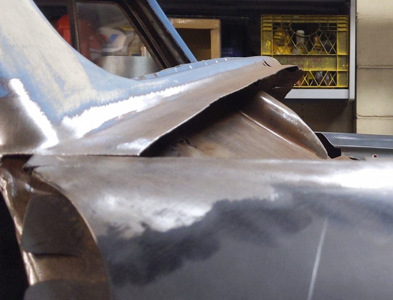

    Here is my biggest hangup at present, the upward arching windshield base:
    It looks a bit exaggerated above, as it's only raised three inches at the center, but it's a lot of vertical height to make up over six inches horizontally.
    The good news is there's plenty of space for a traditional type cowl air intake/flow path, clear down to the kick panel area. That seems like a reasonable way to introduce fresh air into the cabin, provided I plan for rain/water diversion. There is plenty of space behind the front fenders to use for something, and adding some structure for an inner fender (there are none currently) to mount to would be a good thing, too.

    A parting shot with the Jeepster cowl piece resting on the lowered stock cowl panel...not gonna work:

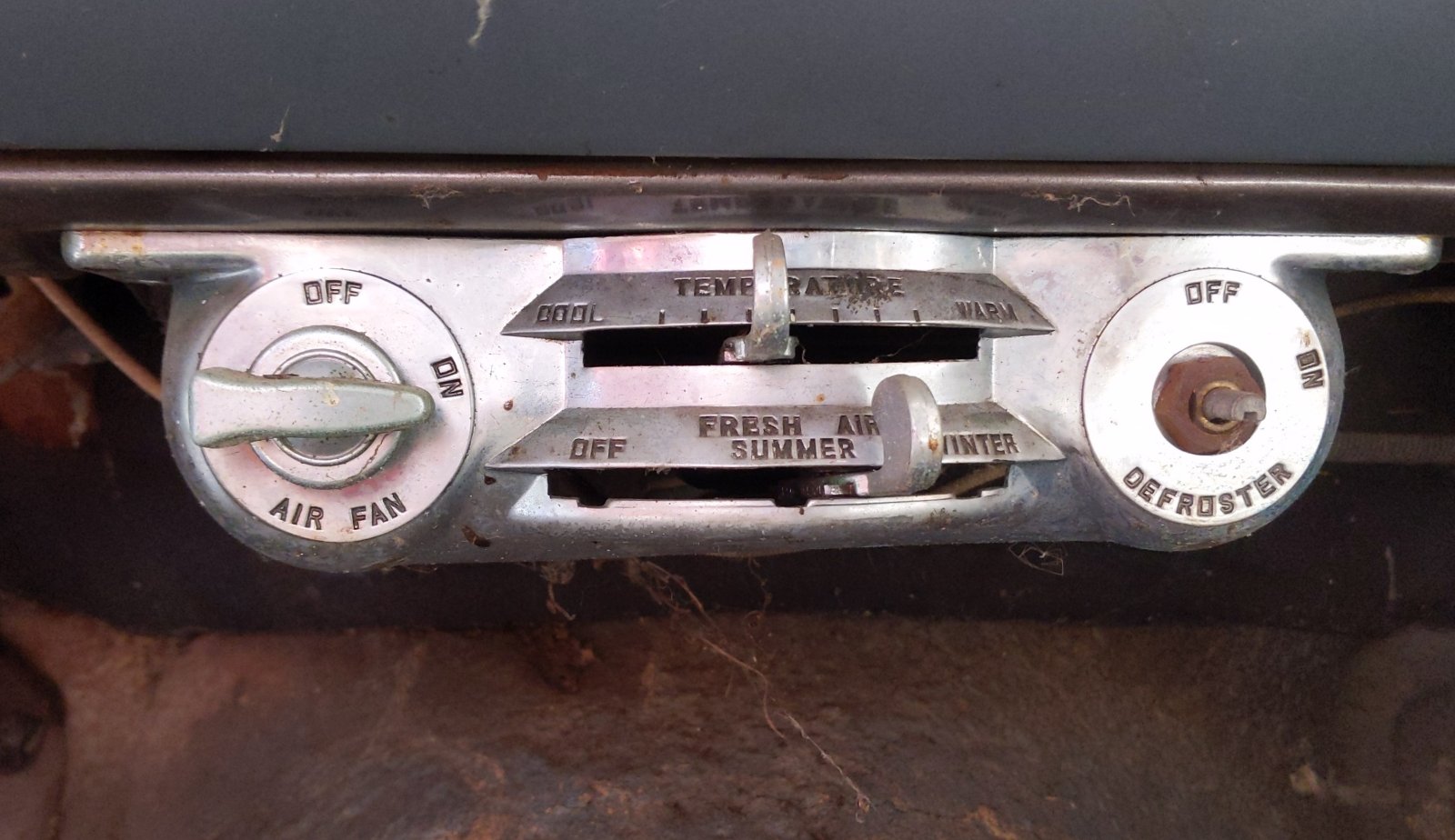

    Speaking of that '63 LeMans, it had and interesting under-dash mounted parking brake:
    I like the fact that it's neither floor nor kick panel mounted, so I'll keep it in mind. Running both cables (no equalizer) aling the trans tunnel would work in the Nash, too.

    I actually like that steering wheel/horn ring shape. I do think iffen it was mine, I'd waste a little(lot? :D ) of effort doing a re-cast on it. There are few threads on here about that, but I think it could be a showpiece. Have seen "jigs" that are unbelievably rough, get nice results. Might require a bit of creative-adaptation(copying via silicone-molds from some-or-another-wheel rim-shape). Anyone for, say, a chromed oem wheel-ring, coated in translucent color-of-your-choice & clear plastic, maybe w/metalflake in the casting plastic? :D . A good start: Smooth-On.com.
    Also like the htr controls in the last pic, nice & compact.

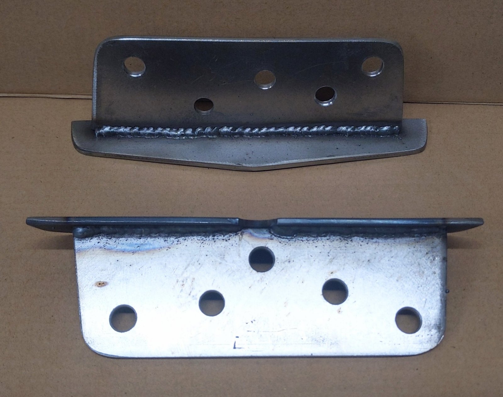

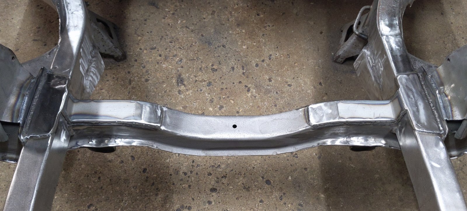

    I wanted to tie the front crossmember to the frame rails a bit more, both between and above them, at the spring tower/upper control arm braces, to strengthen everything a bit, so I made and welded in some brackets and straps. The spring tower areas are a bit funky in shape, so I kept it simple using mostly flat pieces and focused on good weld penetration and strength. I re-welded some of the gaps and welds on the crossmember, too, so it only needs a skid plate welded to it for oil pan protection. Some welds are nice to look at, others a little less so, but most of them got kissed by the grinding disc anyway.
    The brackets which tie the spring towers to the framerails holes for plug welds:
    Next, I have to finish boxing in the LH frame rail, then make the engine mounts, which will be welded to the just-added straps on top of the crossmember.

    Engine mounts are done. I don't love them, but am glad they are finished, as it was not the most enjoyable thing for whatever reason. I used a few random pieces of tubing, 3/16" plate, and two brackets, which I had laying around, and good weld penetration was achieved, so they should do their job well. I didn't want to add any additional bracing yet, at least not until the steering shaft route is finalized.
    As shown above, I put the block, bell and trans cases into position, then took some measurements and pics.
    Ground clearance is not going to be an issue. :) The drivetrain height was more or less dictated by the amount of drop in the middle of the Corvair crossmember, so I was a little concerned it would sit too high, but the relatively thin front half of the oil pan doesn't need much vertical space. I need to modify the 215 pan I have, as the Buick 300 pan bolt holes do not all match, so swapping that over to the 215 is not an option. There is no way I will be able to drop the oil pan with the engine bolted to the mounts, but I'm okay with that. I'll be happy with no leaks, honestly.
    I placed the Chevy pickup trans cover in place again, too, to get a better idea of top and side clearances between the trans and (eventual) trans tunnel and floorpan. The trans tunnel/hump shouldn't be obnoxiously large, but I still think clutch fork clearance will be an issue. I need to research which shapes are available, and what length I need... soon.
    Now, to figure out the crossmember/rear trans mount...:cool:
