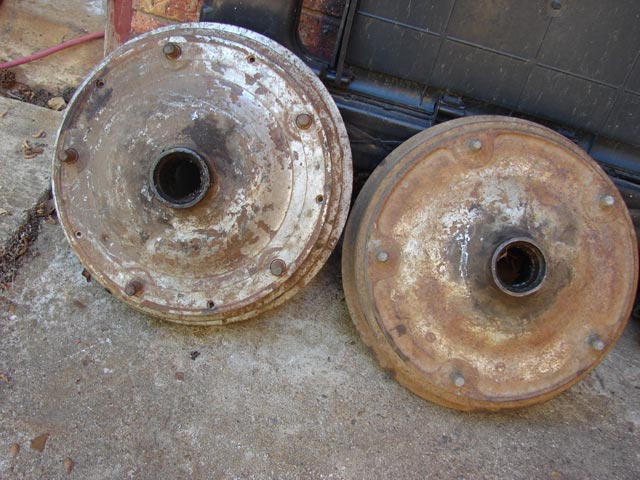

    Ford wide five hub/drums were waiting when I got back from a trip. I like the look, but.... UPS scale said they weigh 49 pounds! Seems like I read somewhere that one pound of rotating weight equals one horsepower. Don't know that the big six has that many to spare!

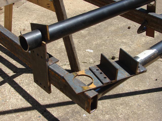

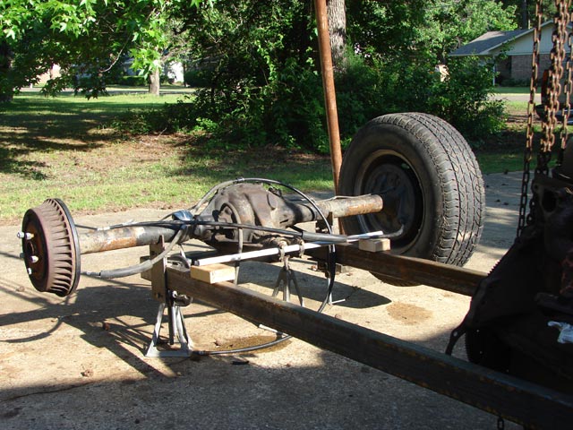

    Main crossmembers in place. Rearend mounts ready for trial fit.

    Setting rear axle in place was about all I got accomplished today. Had planned to set the motor between the frame rails..... but the **x decided to flop off the dolly instead... lost four hours, an E-coil, and an oil filter. Was going to take a picture of the five hundred pound pig lying in a pool of oil, but left that to your imagination.

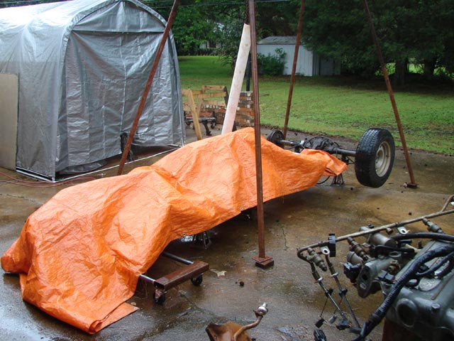

    Rainy day today, so not a lot is going to happen under the A-frame.

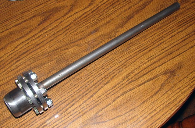

    But, I did overcome what I thought would be the biggest hurdle of the project. I spoke to the guys at Ron Pope Motorsports, and they agreed to provide a Vega pitman arm, remove the spline section, then machine it round... cheap! I may have lost my machine shop phobia!

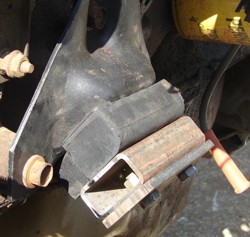

    Motor mounts were a puzzle. The Ford mount has a single stud coming out at some random, unusable angle. The stud is odd, having left hand thread on the inside end, RH on the other. Used a section of 1 x 2 tube to adapt from single stud to 3/8 bolts. Removable 1/4 plate allows welding wihout frying the rubber. Everything is squared, leveled and ready to tack, unless the short C4 changes everything!

    The RPM pitman shaft extension has arrived
