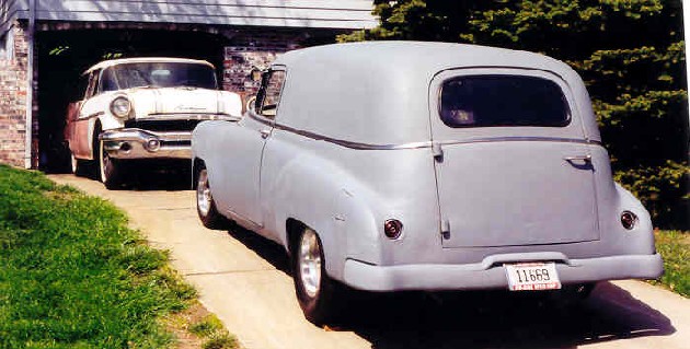

    I ran into the same problems when I traded my International truck for this 50 c hevy sedan delivery. Not only was the bottom 4 inches of the car gone, it'd had been hit so hard in the right side it buckled the floor all the way to the transmission hump! Not to mention it also got blasted in the left rear some time in it's life
    Took a donor 49 chevy 4 door, aftermarket body panels [which didn't fit right] and a lot of time and effort to get it back in shape. I had the local sheetmetal shop fabricate my inner rockers rather than trust that aftermarket inners would be right....none of the other aftermarket parts were right.
    Finally got it....mostly right.
