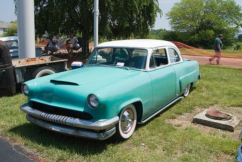

    The car had been lowered with 2" blocks and cut springs at some point back in the past - see the photos early in this thread which were taken long before I bought the car - but had been returned to stock height by the PO, a sorely misguided soul. It is my desire, while waiting for the fuel tank to be returned from being boiled out, to return the Merc to it's former stance...or some stance which enhances its truly sleek styling. Looks like a 4x4 the way it is now.
    I took an hour last evening and installed the 3" lowering blocks in the Merc. The blocks came from Speedway Motors, are of excellent quality and installed very easily. They are a little wider than the springs so I had to leave out the upper rubber pads, but I don't think that's going to be an issue.
    BEFORE:
    AFTER:
    3" is about the maximum drop possible with lowering blocks with the springs on this car without running into clearance problems.
    The rear springs are new, but I don't know if they are dearched or not. I suspect not, just from the way the car sat before I installed the blocks.
    The front end will get attention next. It's already got dropped spindles and disc brakes, along with new coil springs of some sort, but it needs to go a taste lower, probably so that the fender lip just touches the top of the whitewall. An inch or so...maybe more. We'll see.
    Trouble is, I want the car to look low...but not squashed. There's a fine line where it becomes too low, visually, and I don't want to cross that line.
    I've scoured the little books for examples of '52 - '54 Mercurys (which respond to lowering very differently than Fords of the same years, as I discovered, when it comes to the "ideal" visual height) and have found that most were over the fine line of visual perfection. In other words, too low. (I know, I know... Wash my mouth out with soap for even thinking such a thing!)
    The other big factor is skirts. I've got five sets of skirts of five different styles that I've collected over the years. Each design gives the car a different personality. (Keep in mind that I'm old, and come from a time when cars weren't just modified, they were given a new personality by their owner. Looks had meanings, and you had to be hip to that fact or you'd prove to everybody how square you were.)
    So...which skirts to use? I don't know yet, and since the visual stance is greatly affected by the skirts, I won't know exactly where I want the car to ride until I get the skirt dilemma resolved.
    Right now I'm tending towards the '57 - '59 California "Kustomland" look...without the scallops and goofy lakes pipes...which featured open fenders, low with a tiny forward tilt. Tony's (50Fraud) '50 and '56 are very good examples of new-built cars with this look and stance. Here's another example of the "look", taken back in '57...stolen from somewhere on the net. Rik, if it's one of yours, thanks!
    I'll put it there first, and see how it looks. I'm thinkin' it'll be good...but then what the heck am I going to do with all these skirts?
    Maybe I'm over-thinking it all... :confused:

    i really like the stance now, i agree about the front bering a tad lower. The skirts is a tough one, its almost like what cereal do you like, everyone likes someone else. Im debating the same thing, i have the 53 skirts that attach to the outside and ive been thinking about flush mounts but i have to buy them and see them on first. its looking really good.

    IMO, and this is a worthless one, save the skirts for another car. Thats again, just my opinion, but skirts were become p***e in socal in the late 50's, and I like the shape of the wheel openings on these cars, but that's my perspective.
    I do agree that Mercuries can look too low, but thats just because they're longer, you can slam a ford into the dirt and have it look proper (see slmlord).
    I dunno, I'm biased with this one (and its a bad shot), but I think this car looks proper (aside from the silly lakes pipes, but I might put some on my car even though I know that they're silly)
    I'll browse around to see if there are any side-shots of the car. It looked killer, and was completely static and rides like a log truck. For reference, it was about a full inch lower than my car.

  16. missysdad1
    Joined: Dec 9, 2008
    Posts: 3,307
    missysdad1
    You guys are brutal...
    CC:
    You make a very good point, that many heavily lowered cars ride poorly and, because of limited suspension travel, corner dangerously on uneven pavement.
    The main trick is to use lowering methods which allow plenty of suspension travel, but at a lower al***ude. Dropped spindles and rear c-notches are two very important ones.
    The other trick is to lower the car only to the point that it is at its visual best. Contrary to popular practice, this usually involves a relatively modest drop.
    A third trick is to use heavy duty gas-filled shock absorbers to slow suspension movement. The car still has reduced suspension travel, but the travel it has is used up more slowly.
    Thanks!

    I wasn't trying to be! More agreeing with you on a lot of things than anything. That green merc used to reside at my house, thats why I'm biased towards it on a lot of things. I know you've got good taste, I was just throwing what I think out there.
    Edit:
    Didn't see the rest of your post.
    Yeah, that car just got big blocks and worn out springs. It definitely needed a c-notch and drop spindles, I'm actually really considering those both for my car (It doesn't ride bad, I just wanna make some room to go a little lower).
    That merc rode baaaaaaaaaad, and it had air shocks in the rear that were pumped up. It was low though!

    Well, today was the day to install the Aerostar front coils. I got mine from O'Reilly's for $80 including taxes. They are genuine Moog coils, which I specified as they are a brand I trust for quality.
    The coils that were in the car were recent replacements, from the fresh paint on them, but I have no idea from what application they came. The car had a noticeable sag on the driver's side, due to the poor quality of the previous coils, which is now gone.
    [​IMG] [​IMG]
    The new Moog coils, #CC850 as recommended in several places on this site, were 1 1/2" shorter with .050" larger wire size than the previous coils, and approximately .075" larger than the originals. This may not seem like much, but in spring terms it's quite a bit. This is why our cars ride better, handle better and don't bottom on the snubbers quite as often even though the spring itself is shorter than stock.
    The result was a drop of 1 1/2" from the previous al***ude...just right! No problems were encountered in installing them. Keep in mind that this car has Fatman Fabrications dropped spindles already installed, which accounts for the really low stance. There is approximately two fingers of clearance between the unaltered original lower control arm snubbers and the frame as it sits now. I will probably shorten the snubbers by an inch or so to increase the suspension travel...or not, as the ride quality dictates.
    The car sits just where I want it now...low, but not too low, with a slight forward tilt, just as they were in the "olden days". I'm very pleased.

    Joined: Dec 18, 2006
    Posts: 9,665
    JeffB2
    from Phoenix,AZ
    That has a nice stance! :cool::cool:
  22. dwaynerz
    Joined: Nov 16, 2006
    Posts: 238
    dwaynerz
    i think you got the perfect stance.

    love the stance, and with no bags!...cool!
