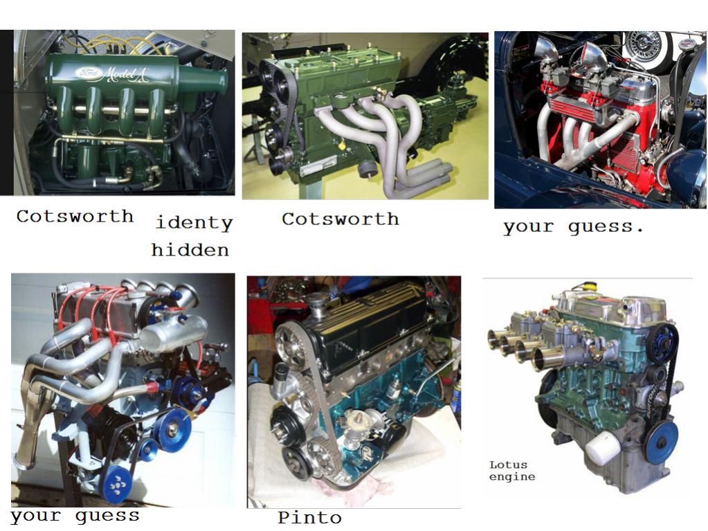

    :)New engine replacement ? one of these or an IRON DUKE ?:cool:
