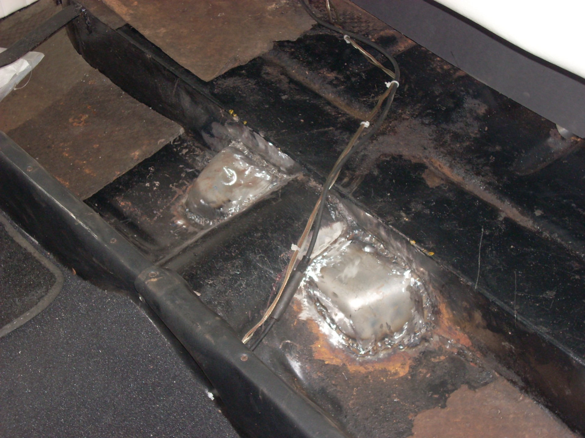

    I have one in my '47 coupe and I love it. I did have to notch the floor under the rear seat, it would hit on bumps, so I would imagine floor clearance in a '37 would be an issue.

    I went with the larger 36% and cable shift so there's a T handle under the dash. I have 3:78 and a tall rear tire but the healthy flathead pushes it along just fine. Cruises the highway at 70-75 all day.
    I just had to put a hump under the back seat. I fabbed up a little box under the back seat. Probably could do a nicer job now, I did this when I was 20, 20 years ago, but it came out okay. thumbnail_DSCN0133.jpg

    Those aren't huge big blisters, I appreciate the radiuses. Are you lowered? How tall are your tires?

    I've got radials, 225/75 15, which is probably close to an 8.20 15. My car has a drop axle in the front and a few leafs out of the back. If it was lower the blisters might have to be taller but it's plenty of travel as is for how my car sits.
