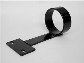

    A simple way is the loop that mounts under the ****** mount. simple enough to make with a 2" slice of pipe and a strap. You need 5" pipe to get >1/4" wall in sch 40. Any pipe in sch 80. A similar deal could bolt to chunk bolts on Ford rear. I plan this as driveshaft will be at my ribs.
    http://www.jbp-pontiac.com/products/dress_up_misc/dress_up_misc.html

    Spohn also makes one and says "Our loop mounts to the underside of the stock transmission crossmember. You simply place the supplied 7/16” bolts and washers through the driveshaft loop mount, through the transmission crossmember, and into the polyurethane transmission mount (required). You’ll have peace of mind, and you’ll be drag strip legal."
  21. IMCA used to say minimum 4" ID, 1/8 thick round tubing on their dirt modified cars.
    I have cut many s****s of 4.500 x .134 driveshaft tubing for this application. Fab from there.
