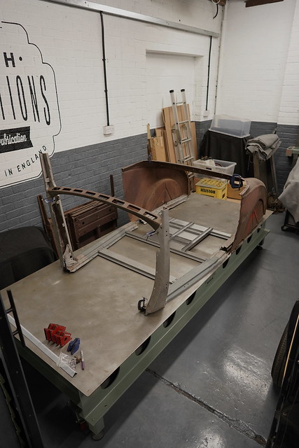

    photo of the mid section which was narrowed to allow for the shortening of the body
    [​IMG]14 by joe curtis, on Flickr
    close up of the doors plates on the inside before I cut it apart
    [​IMG]12 by joe curtis, on Flickr

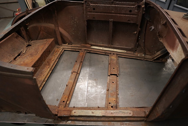

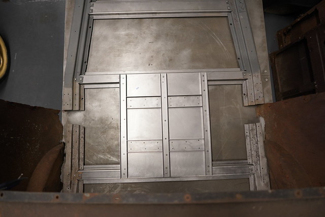

    and where im currently at
    [​IMG]8 by joe curtis, on Flickr
    [​IMG]9 by joe curtis, on Flickr

    The front cross channel looks to have 4 holes in it, that a tudor seat pivots bolted through...
    also the long sill plates indicate tudor, as coupes were only half as long...
    tudor, fordor and touring subfloors were shorter than coupe, sportie, roadster and cabbie as the body curled back under the rear window...

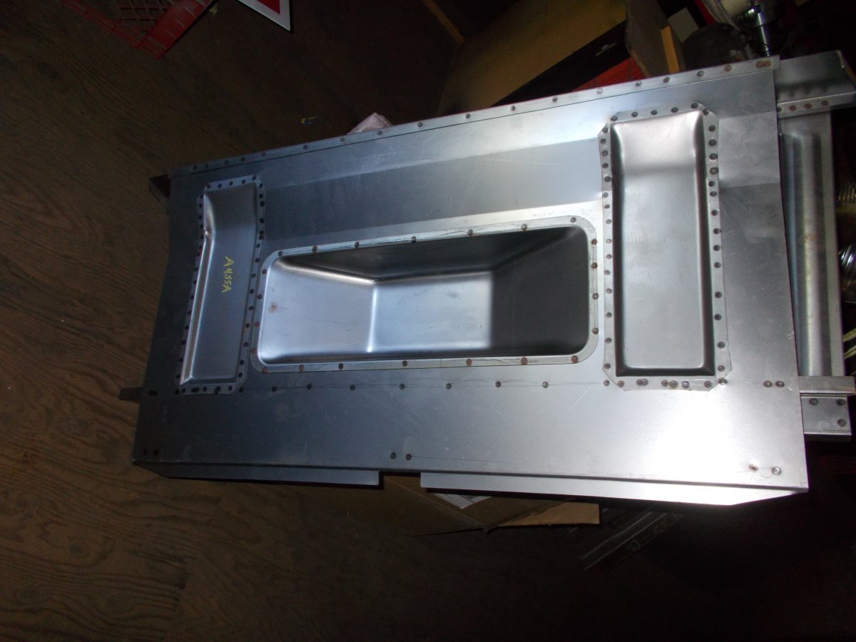

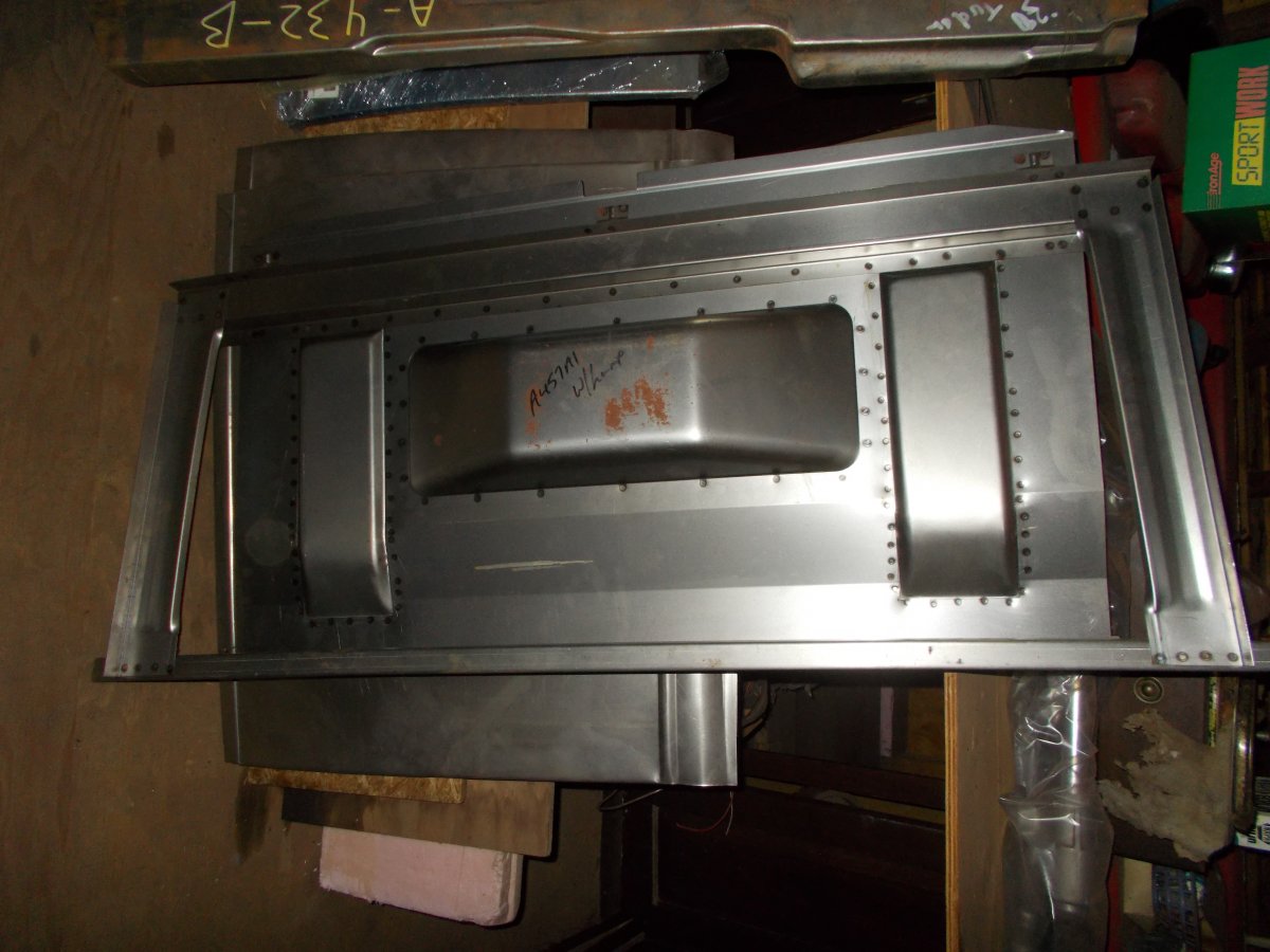

    I have a new pair of tudor rear subrails from the doors back... top of middle pic.
    also the seat riser / u bolt cover... pix DSCN3117.JPG DSCN3113.JPG DSCN3116.JPG

    I have a 'tudor sedan sub floor, and '30 coupe subrails only, leaning against the back wall of my garage...
    do you need pix or measurements and pix… they are toasty... LMK...

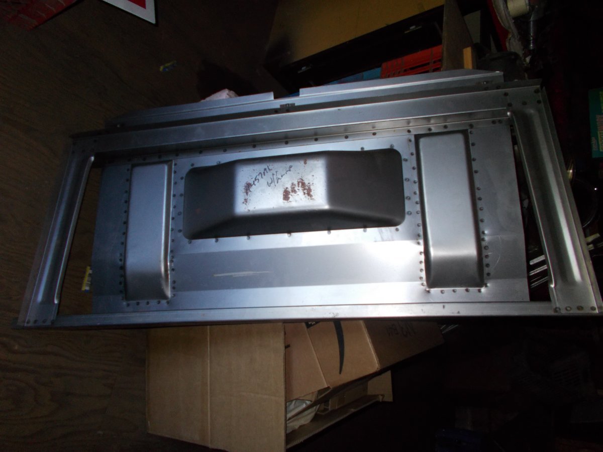

    Here's an older pic I found on my phone, Il'l take some more but this gives you the general idea. Johns phone empty out Jan 2019 057.jpg

    If you could get a couple over head shots and some dimensions from the inside of the rectangle openings where the floor panels go I can dimension mine the same. Thanks a lot
