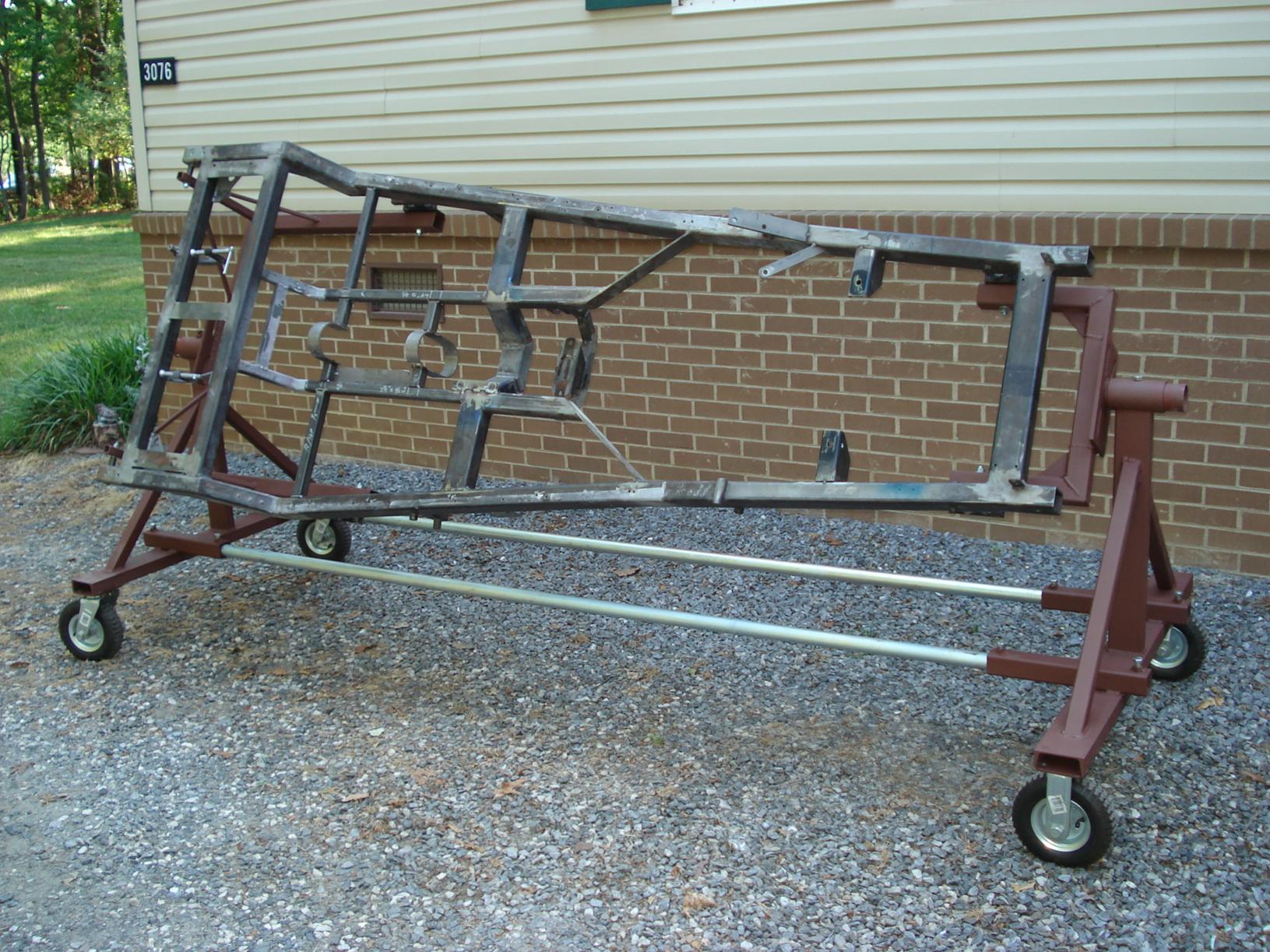

    This whole frame was welded with my 140 amp, 110volt Snap-On MIG. I used 2x3, 2x2 .188 wall mild steel tubing... I have a neighbor that welds for a national company. After I fitted and tacked all the joints ,he came down ,inspected it . He made me re-do and clean a few f/ups.. He then fired up my little pea-shooter and proceeded to lay down some awesome welds..I watched him closely and was really impressed with his skill...I have total confidence in his work.. He welded in the frt,mid x-members and the rear kick-up( all the really important ***-savin stuff. !..) The rest he turned over to me.
    So, for my $0.02 worth, will a 110 Volt machine do the job??? Myanswer is "yes, in the right hands...."
