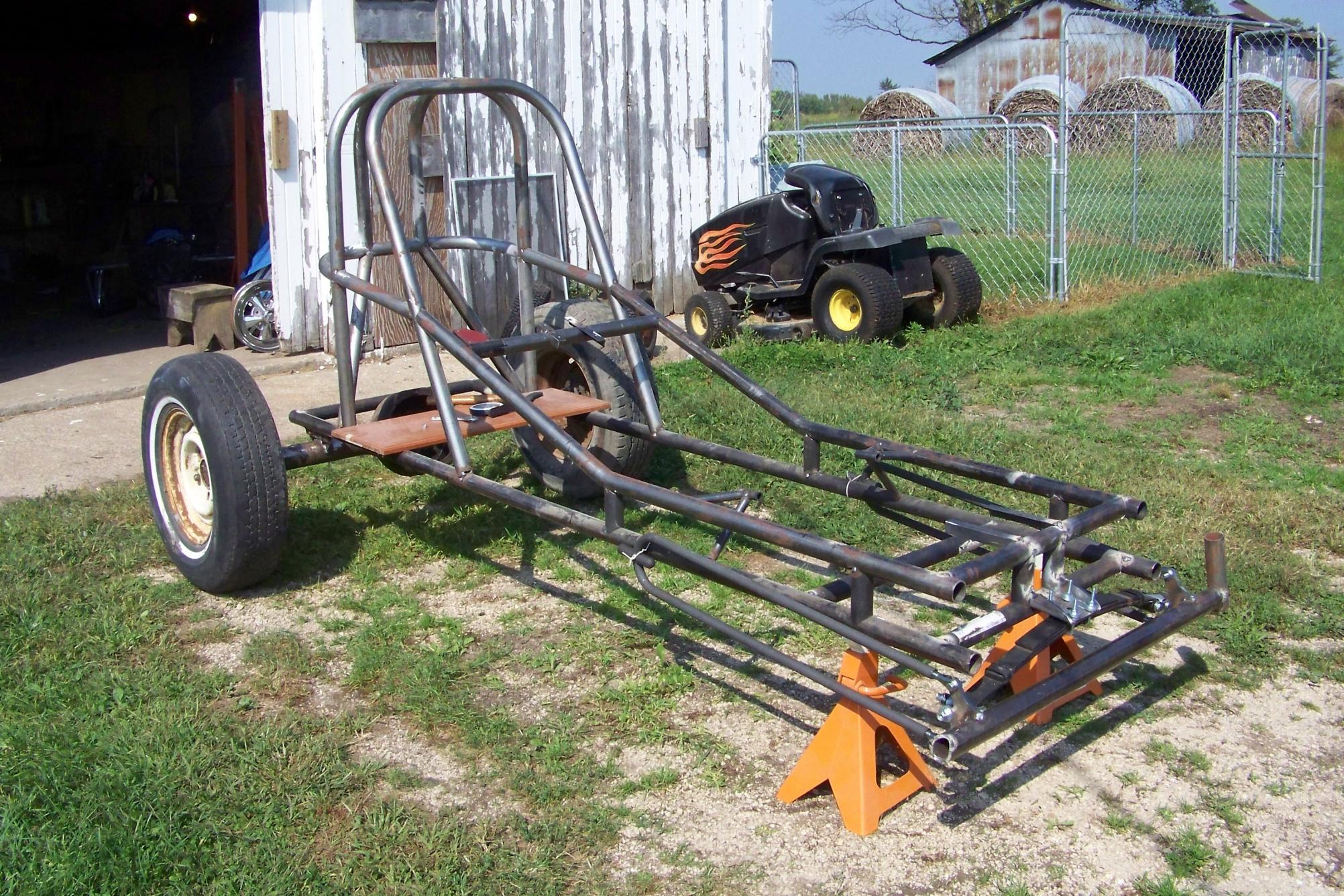

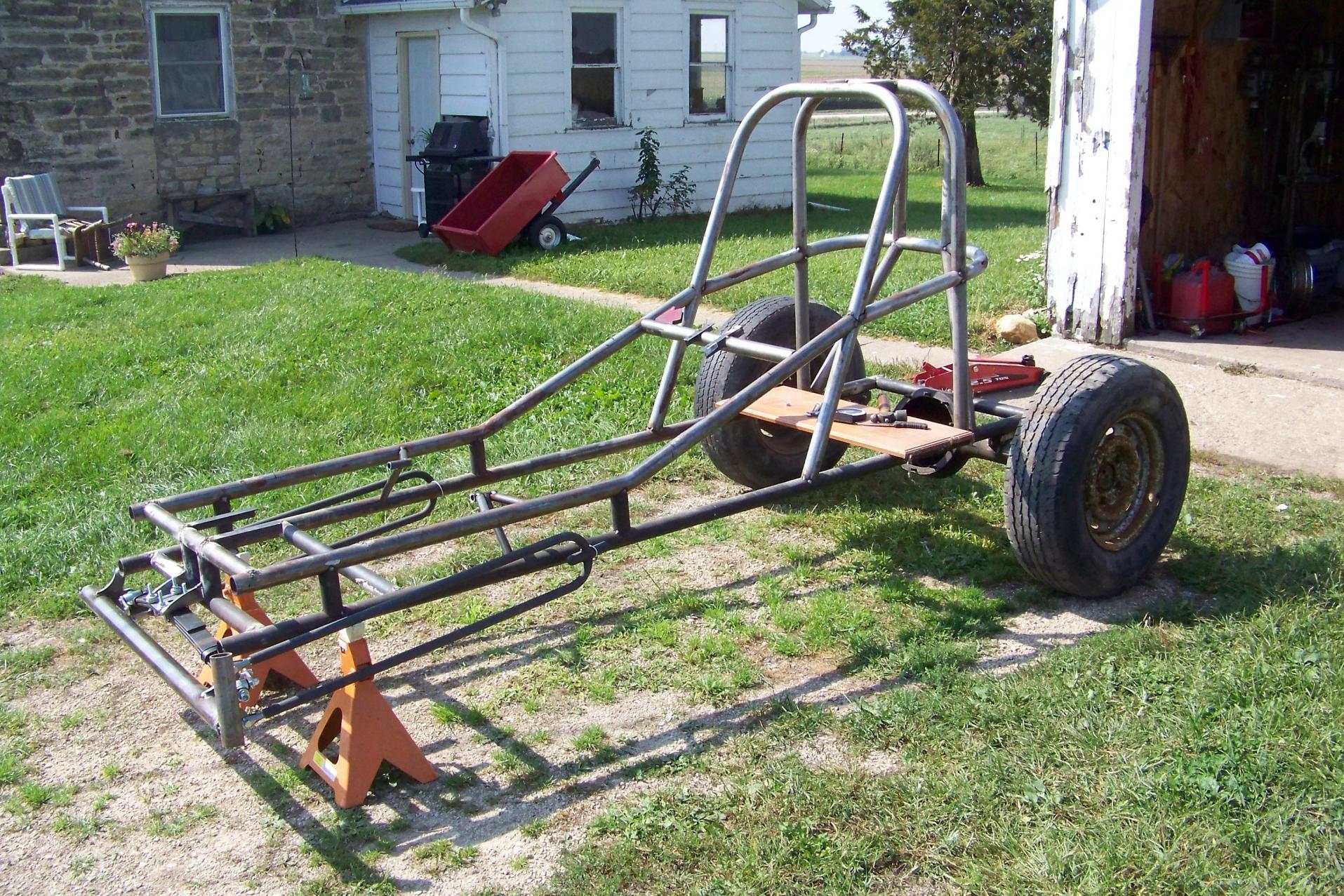

    I have questioned, I have looked and I have researched... Then I jumped off the deep end. I have striped and layed out gaphics for a bunch of folks and never charged for my services... Till now I went back to all those folks and here's what I got...
    27 T Speedway body, 9" rear, powerglide(broken), headers and the guys help to bend and weld the frame...500.00
    15X4 Crager SS 100.00
    tubing for the frame 260.00
    al kinds of brackets and hairpins and tank from sppeway 600.00
    Couple weeks of work and here is what I came up with... Everything is tacked and ready to go back this week for final weilding
    Engine will be normaly asperated SBC on racing fuel
    trannsmision will be 3 speed using top 2 gears

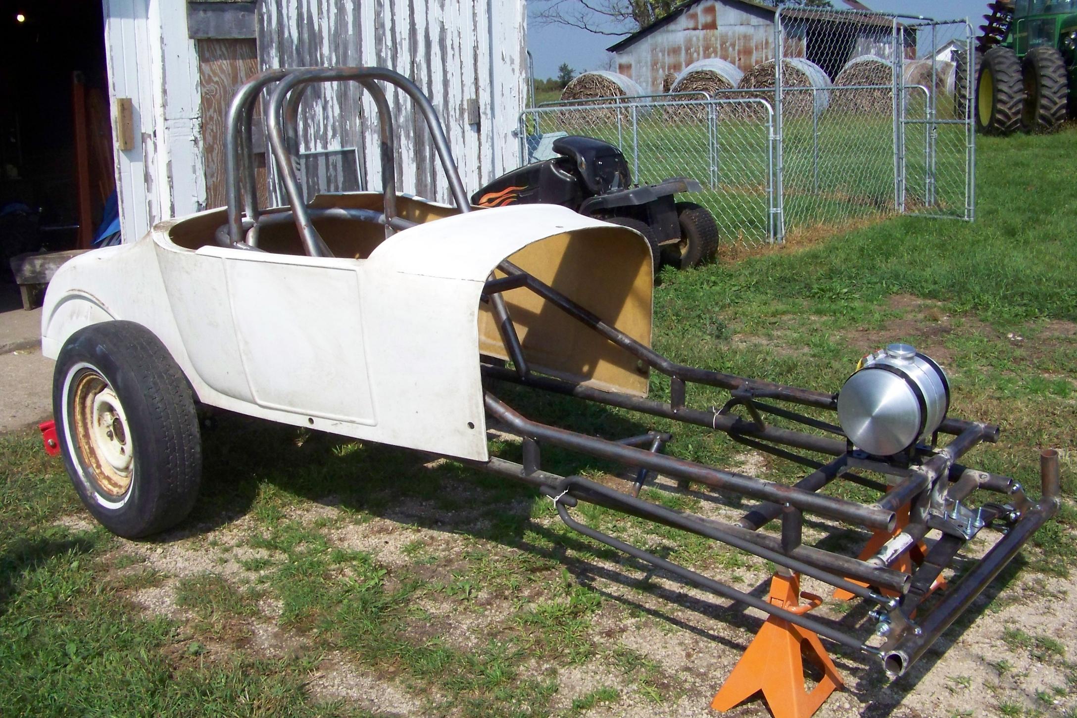

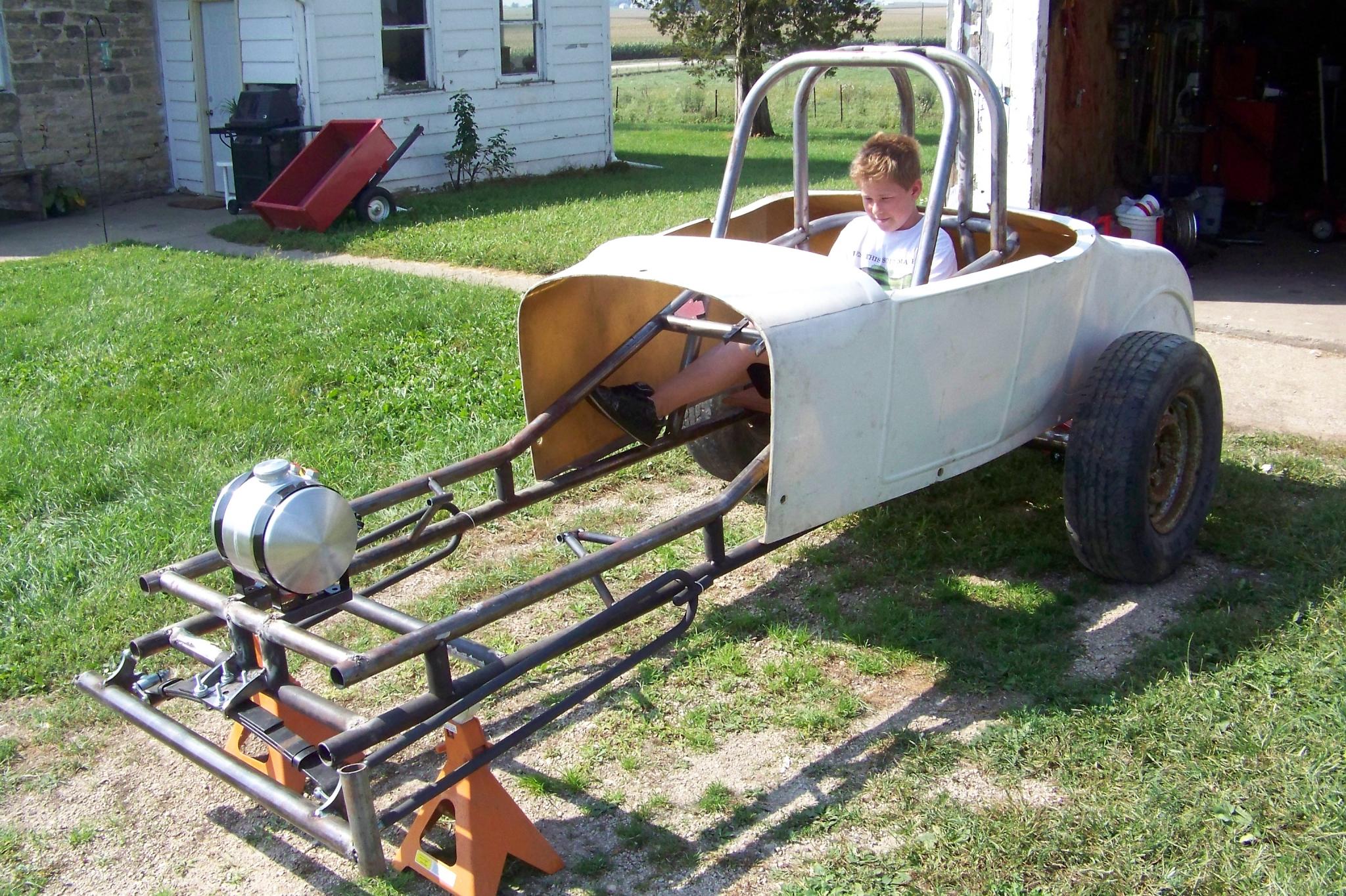

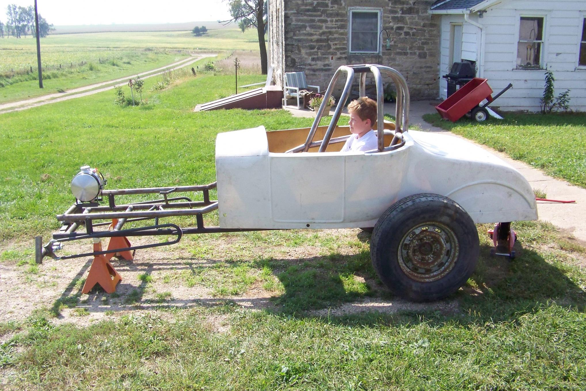

    A few with the body

    Have you ever built a drag chassis before? Did you work from a blueprint? I've done a few and don't want to hurt your feelings nor dampen your enthieusasm but it don't look right to me

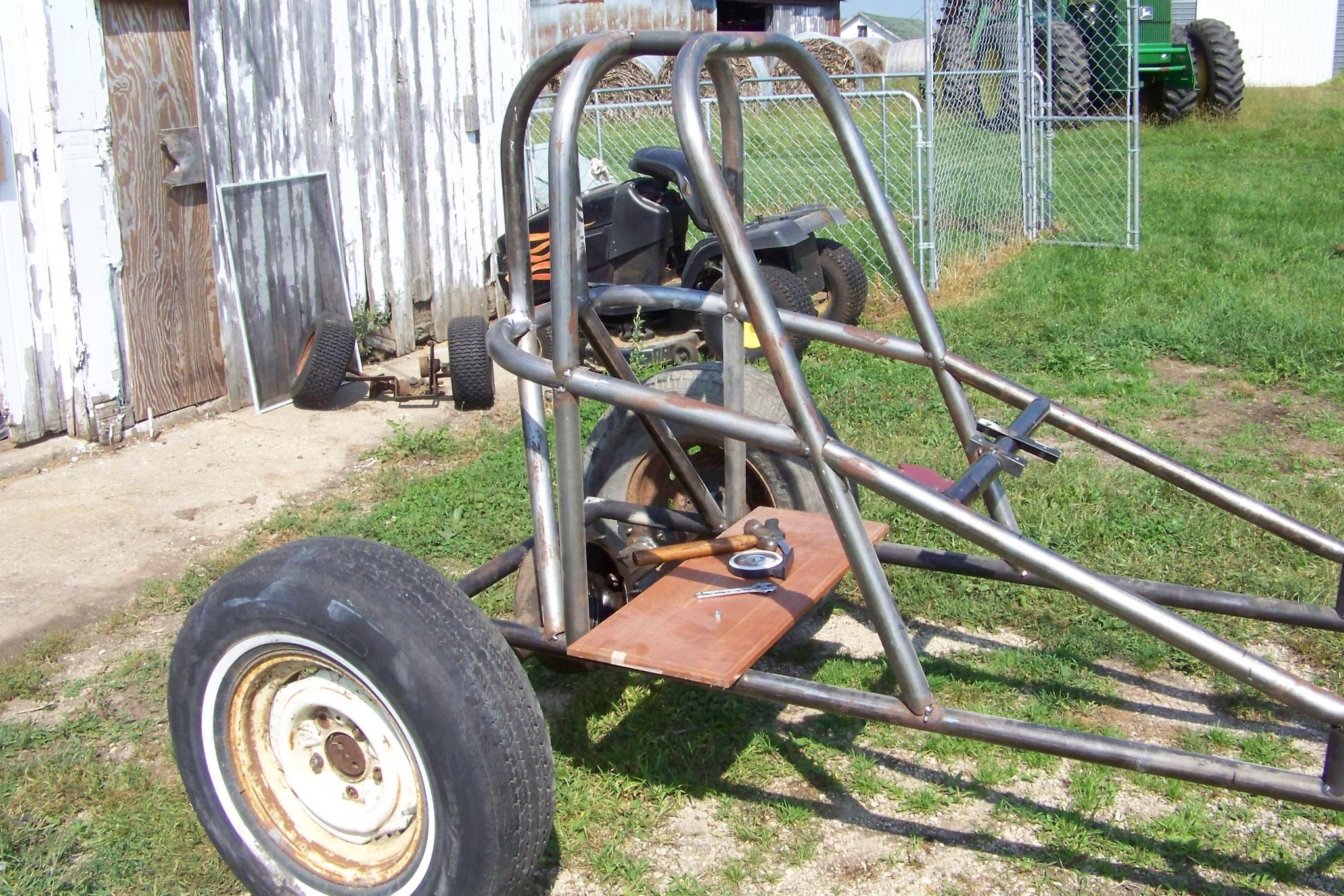

  6. It looks very 1963 to me, but that's not going to get you past tech in 2010. At a minimum the roll cage will need to be much narrower, so you head is within 3" of the side and top bars. It will probably need additional diagonal braces.
    Not trying to pick it apart, just trying to keep you from finishing it and then having to make wholesale changes. At this stage changes can be made so much easier.

    Well what don't look right to you? I know I have
    to add
    more bracing but was waiting till I got the tranny that I am goin to run(3 speed manual) that way I can work my brake and clutch into it.
    And yes all I will probably be doing with this car is bracket racing. The three tracks that are around here are all nhra tracks.
    To get my big ass in the car we had to go wide on the cage... I'm 6'4" and close to 400lbs.
    No I had no drawn out plans just looked at the post here and there and came up with this. It is only tacked to together so if I have to blow it apart and start over a little advice would be appreaciated. So let it fly you ain't gonna hurt my fellings.

    Your issue is going to be with that upper framerail. I don't think there is a tech guy alive who is going to let that run the way it is. The upper rail must be a continuous run from the motorplate upright to the shoulder hoop. Two splices (sleaved and rosette welded) are allowed, and even required when you get to SFI specs. They would be between the seat upright and the front hoop of the rollcage. If you search the net, you will find a bunch of pics and illustrations showing the standard configuration for an altered/funnycar chassis. Use those as a basic guideline. If you think it will help, you can call me (send a PM and I'll shoot you back my number) and I can go over the whole thing with you.
