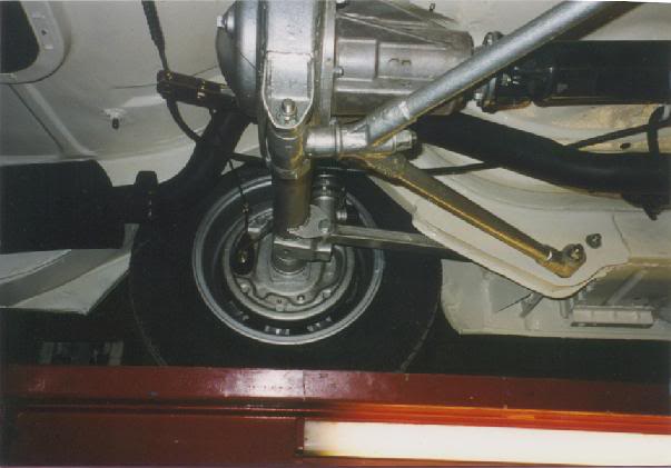

    With that minimal space that'd be a good candidate for Jag IRS.

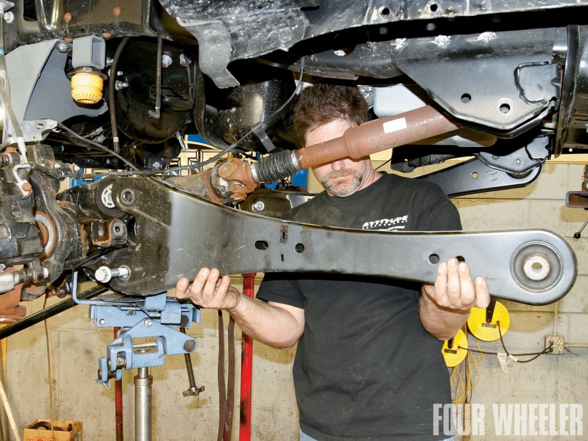

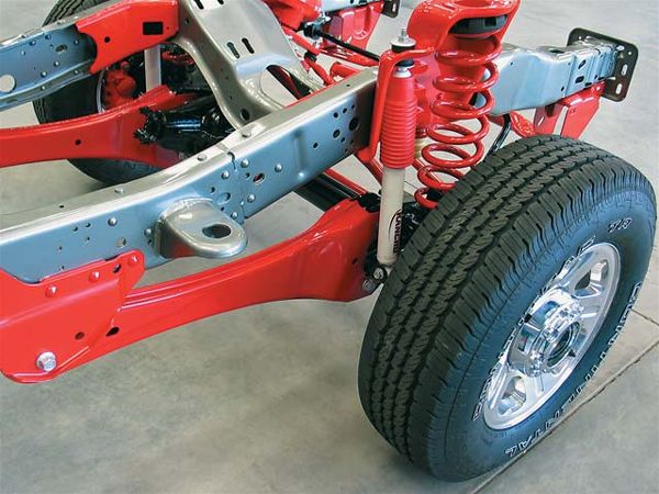

    Oh look...a formed steel parallel ladder bar setup with compliant bushings...on a solid axle.
    On a PRODUCTION truck.
    All Ford Super dutys are set up like this, and have been for the past 10 or more years.
    2racer likes this.

    I thing those big bulges on the front of the arms contain rubber bushings to allow articulation.
  19. Yep. Real big bushings at every point.
    Just like the rear of my motorhome. Even shorter arms. But mounted with huge bushings at frame and three at axle.
  20. Yep, that would hold up in your hot rod quite well
    pitman likes this.

    Yes...well the attempted point was that parallel ladder bars with compliant bushings would give plenty of articulation for a street driven vehicle...as proven by OEM useage.
    Landrover also used a similar setup with inline bushings on arms that ran under the axle tubes...both front and rear axles!
    1st series Ford Bronco used something along the same lines with a rear bushing to the frame and a front cushion that wrapped the axle tubes. All of these vehicles have proven themselves quite capable on AND off road as well for at least two of them!
    There are many ways to skin this cat!
    If you feel that particular arm itself is suitable for the job then....knock yourself out!
    I certainly wouldn't run it! LoL
    It's made the way it looks to allow it to be punched out simply and accurately in large numbers.
    Attractiveness was never a consideration!
    A regular ladder bar setup with sensible sized rubber bushed inserts would be fine for our needs.
