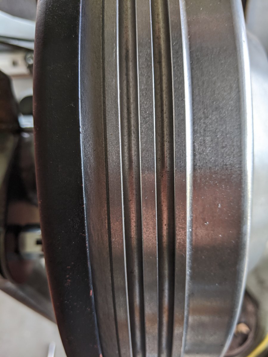

    To fix it I cut 0.100" off the OD of the drum lip. I chose to go further than necessary and creates a sort of third "rib". This was primarily an aesthetic decision. To hold them I made a mandrel that had a pilot. By cutting this in the lathe before mounting the drums it eliminated any run-out or dialing in. IMG_20200523_100909.jpg IMG_20200523_103226.jpg IMG_20200523_103232.jpg IMG_20200523_103245.jpg IMG_20200523_103317.jpg IMG_20200523_103337.jpg IMG_20200523_145733.jpg IMG_20200523_145738.jpg
    The two shots above have clearance even though it's hard to show in a picture.
