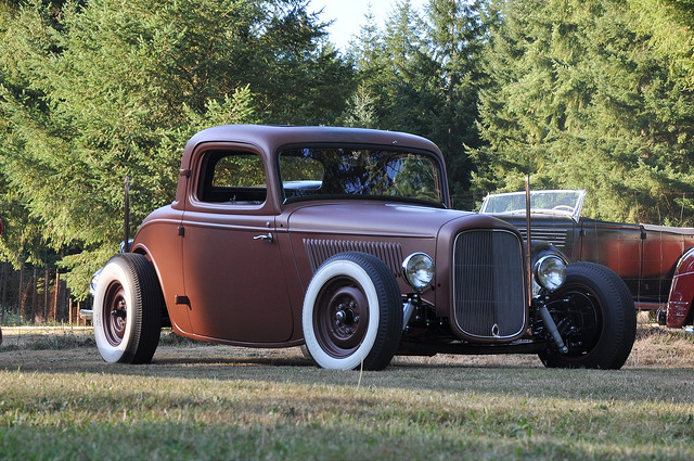

    My coupe has early Ford running gear in a stock frame with a '57 Chev 283. It is channeled 6" at the cowl and 3.5" at the rear with no chop. No real tricks on the build just a good heavy channel to get it low.
    verde742 and falcongeorge like this.

    check his avatar. Mad034's dads car third down :) I am hesitant to post pics and bump the thread, but here goes.
    -Brent-, 29EHV8, Jet96 and 5 others like this.

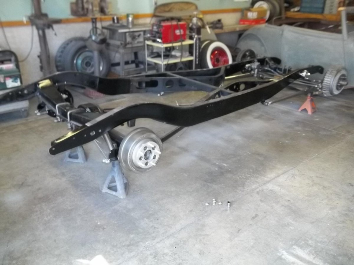

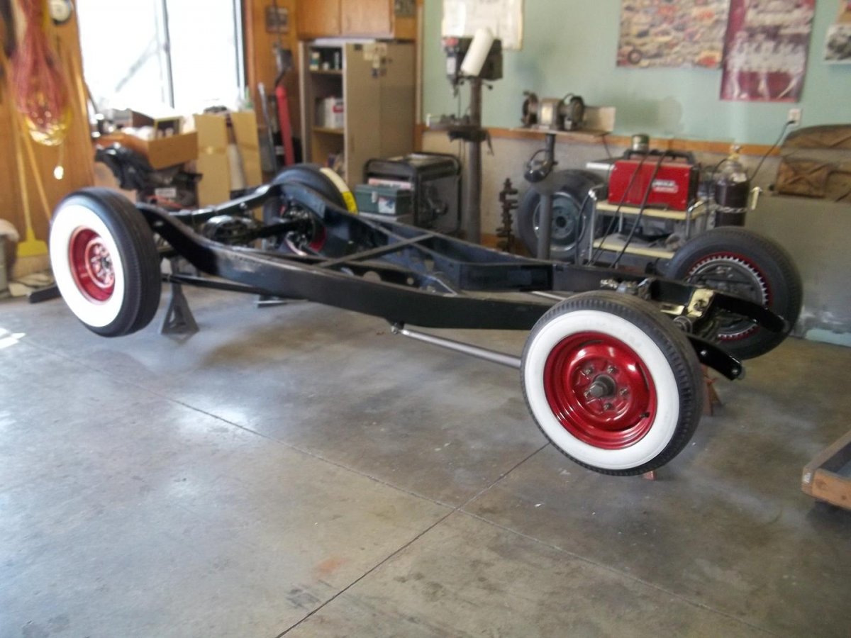

    001.JPG 002.JPG Here's mine, in early early '14. Shortened 5" and no rear horns to accommodate the sectioned body.

    Wait... Holy ****... is this the same car being restored or a clone? In either case dear god yes please start a build thread!
    What are you running for a rear end? Rear Spring? BIG SMILES man...
    ABSOLUTELY LOVE THIS ROADSTER:
    Tim did you shorten the wheelbase 5"? Just curious because there is a big difference between deuce and 33/4 wheel base- 106" Deuce and 112" Model 40 and I was curious what the wheelbase was on Greispma's coupe... I feel like it looks more like a deuce wheelbase.

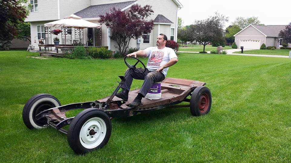

  19. Tuck

    We always used a pickle bucket :)

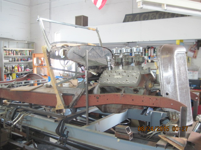

    Tech Editor
    from MINNESOTA
    What's the story on this? It's really neat-!!!

    so long as its a wooden one, and not one of those damned plastic things!:D

    I don't really know, its been in my photo files for years.
