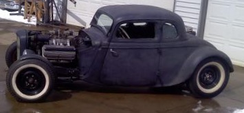

    The purple coupe was built by Allan Hare in New Zealand, the year was 1971[​IMG]

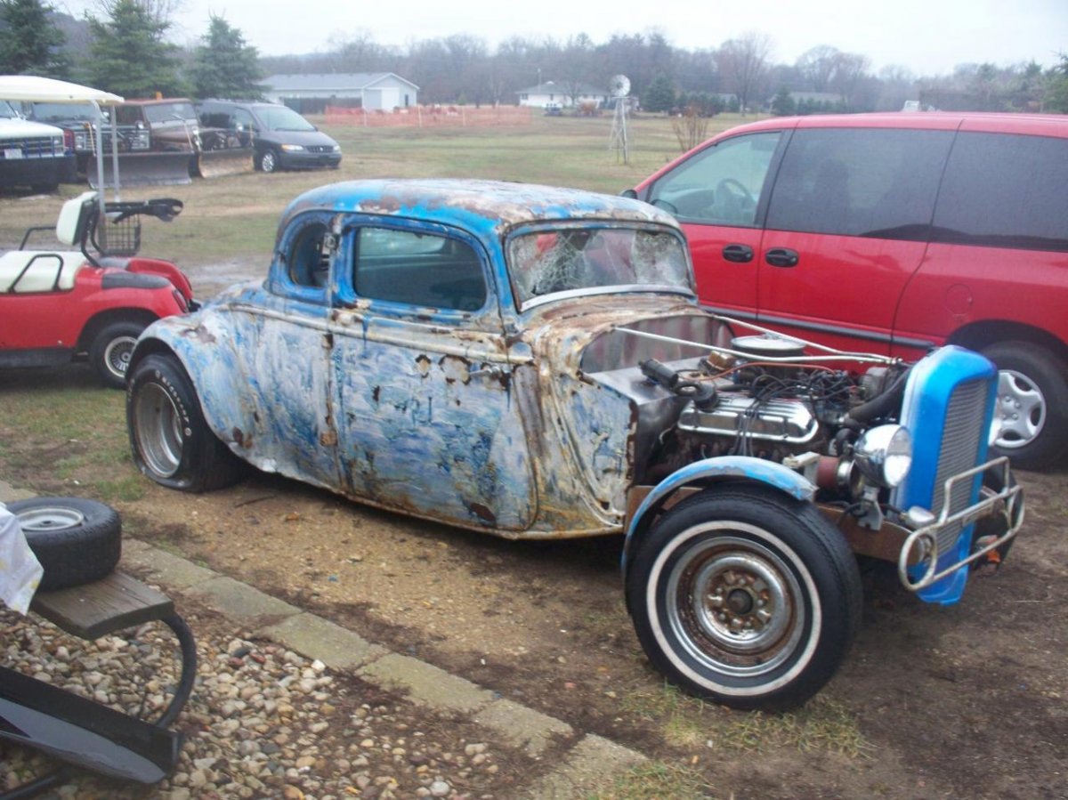

    That car belongs to @***us maybe he can post more pic's of it - another one of my fav's... it was a car @Marcy found and bought I think and ***us brought it back from the dead with an early hemi with Edmunds heads and valve covers- super COOL.

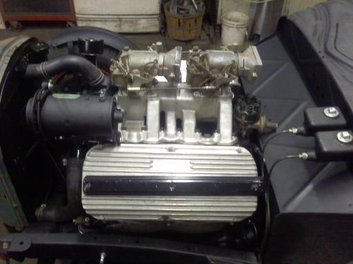

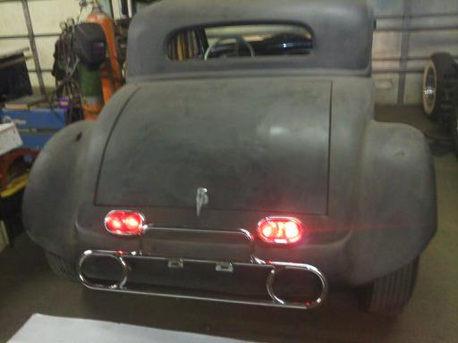

  7. Tuck,
    Here is a couple pictures of my ride
    50 Cad 331
    Old speed Queen trans adapter to Ford Hogs head
    my own adapter hogs head to T5
    S-10 T5 4wd
    T5 trans adapter to TT
    34 frame, Z'd 3 inches in the rear
    stock front cross member
    Model A rear cross member, flattened
    Model A rear spring for QC
    36 rear with QC
    36 radius rods
    34 front axle dropped 2 by Sid's ( my buddy Andy Kohler wasn't doing them at the time) Stock axle height shown in pictures.
    Firewall relocated back 1" for Cad motor
    X member pushed back 1" to maintain pedal to firewall geometry
    stock 34 pedal reworked for hydraulic
    Since these pictures I have moved the front radius rod inboard to triangulate them on the transmission cross member.
    If you need more let me know, I have lots of pictures to share.
    29EHV8, Rusk, Surfcityrocker and 6 others like this.

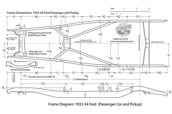

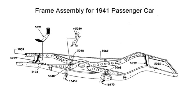

    Totally talking out loud here... but I was looking at the bad spots on my frame and thinking about the 40 style rear cross member flattened mentioned above. I have a 41 ch***is and the frame rails are identical (or close to) in the rear only wider. I think I can just use the rear section of the 41 frame to replace the rust while creatively cutting and narrowing the rear section and you would hardly notice especially in a channelled coupe, and gain some kickup.

    i cut up a 1941 ford frame, i will graft on model A front 36" or so... the rear kick up is 10",
    rugged frame, too much lift out front for the A subfloor...

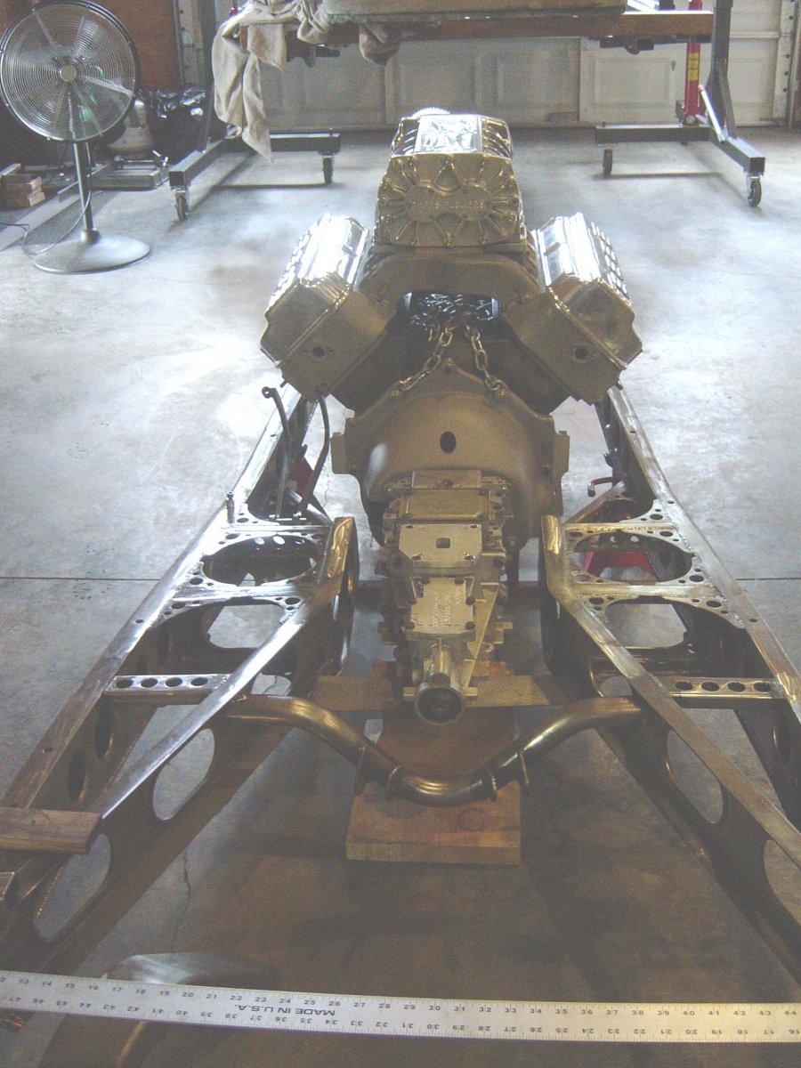

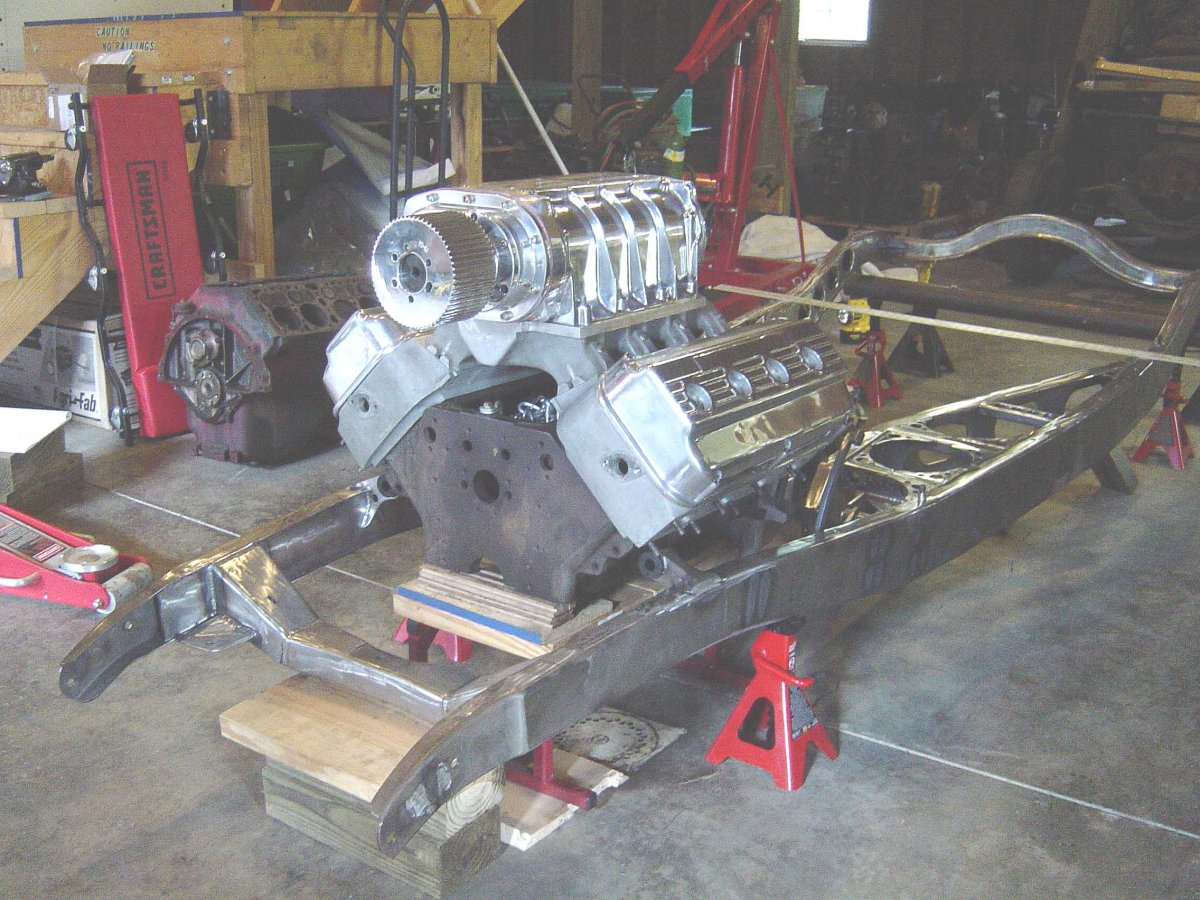

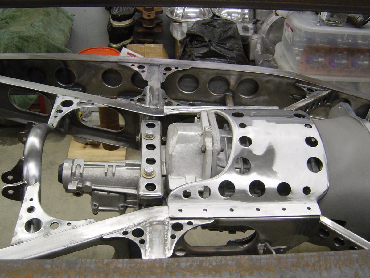

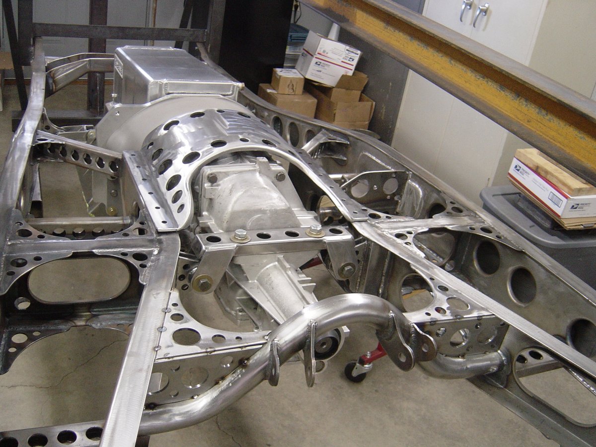

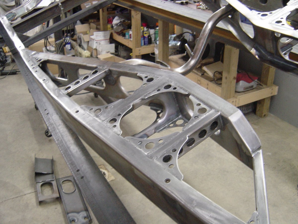

  21. I'm in! I'm finally back at working on my 34 five window again - has been in "mothballs" for the last 7 or so years (got busy with the FlatCad for Bonneville, then the FlatCab and other damn projects). I've committed to getting the rolling frame, engine and body to Flop late Spring or early summer - so I'm back in the saddle. The following are pictures from when I was building the frame. I'll post updates on the suspension stuff I'm currently building:
    1) 34 Custom Frame - I started with ASC Rails, fabrication a go-go . . .
    2) 392 Blown Hemi - about an 8" setback (as much as I can do and still have room for clutch/brake pedals). It is really a ******* to fit one of these beasts in - given the 3" blower drive in front, radiator location - etc.. Needless to say, there will be a LOT of firewall work (Flop should enjoy this - LOL).
    3) Tremec TKO Trans
    4) 32 dropped front axle and hairpins (making these as I write), Posies reverse eye spring
    5) Frankland Q.C. with big Q.C. bells, 3" axle tubes, 31 spline axles, DPI differential and Wilson Welding Lincoln brakes, Buick drums
    6) Flattened Model A front cross member (repop), radiator in stock position
    7) Model A rear cross - Posies reverse eye spring.
    DriversSide copy.jpg Rear copy.jpg RearWithGussets0.JPG PassengersSide1.JPG FrameSide.JPG
    rod1, alfin32, john potter and 9 others like this.

  23. Rocky
    Posts: 17,630
    Rocky
    Classified Editor
    Holy ****! You could hit a peterbuilt head-on with that ch***is and never even scratch it. Must be anticipating mucho torque from that blown hemi. Very nice.
    Tuck likes this.
  24. Didn't know there was such a thread . . . but I guess it qualifies . . . LOL! I don't know - - - I just love holes and french curves . . . preferably on the same girl. :eek:
    Yeah, given the weight of the Hemi, the potential HP of it (notice the Top-Fuel Donovan 417 heads), wanted to create a frame that would "hopefully" minimize twist . . . as that just screws up body lines, gaps, etc.. Plus, I guess I like 'metal jewelry' - so this is a hotrod sculpture in my mind. I'm geeked about it once again - can't wait for Flop to get his mitts on it and do his magic . . . I just want to drive the ****er.
    slimcat7m3 and Jet96 like this.
