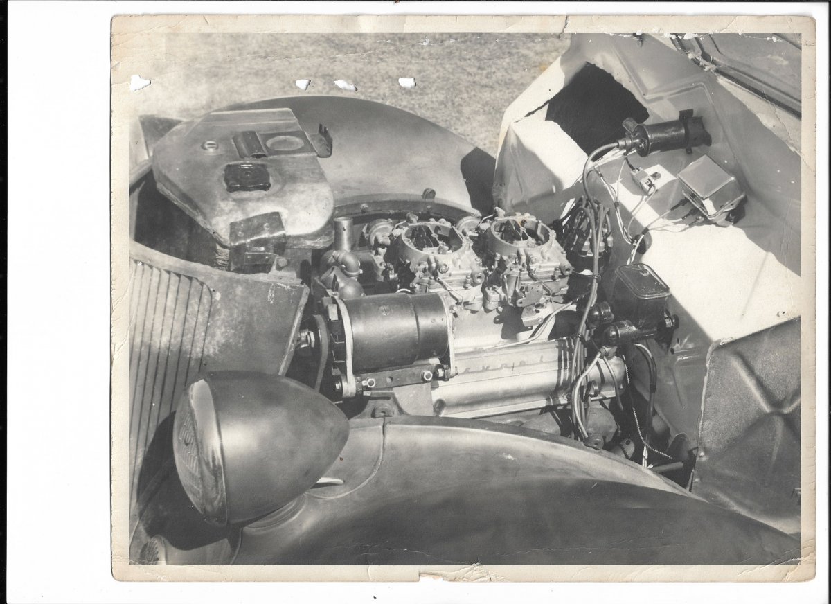

    I had that setup on my T bucket with the 283, power pack heads and 098 cam and it ran pretty decent.
    I'd go with a good hydraulic cam though, lifter rattle and adjusting valves on Saturday mornings is over rated.
    1975 photo

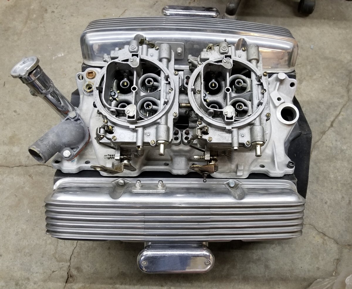

    A 220 hp 283 is a 245 hp with dual quads. A 220 hp 283 with FI is a 250 hp and was available with a power glide just like the 245 hp. Dual quads on any engine, stock or not, car I p*** at a gathering will always get a look.... an LS did at one time now, never.
    I’ve run dual quads on a stock, no cam/head change non-GM engine for 6 years and have no reason to remove them. GM perfected the progressive d-q set up on the 265-283 and I guarantee it works on other engines just fine. 82035F1B-E675-4488-9EF0-1A5E3B0136BA.jpeg

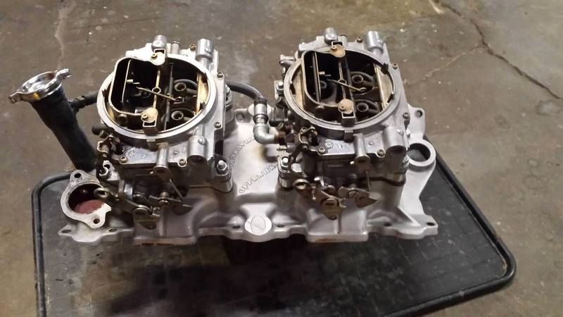

    Here's just a couple more photos showing the difference in carb spacing between the Edelbrock C26 vs. the Offenhauser, something else to think about if you don't use that stock GM piece.

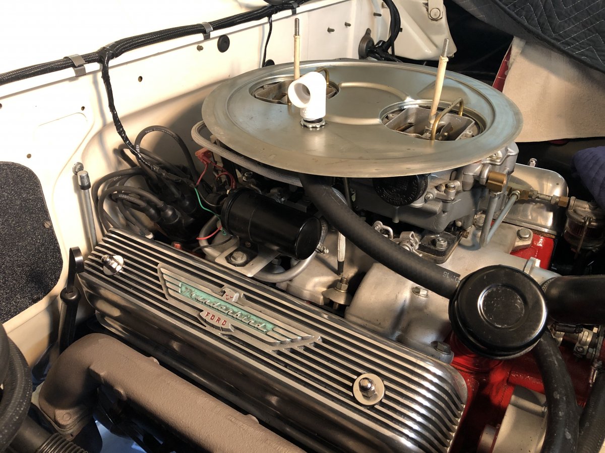

    On the Corvette/Chevrolet 245-270 you don’t need to run the individual air cleaners if you don’t want to. The 1961 had a single base with properly spaces holes and. GTO filter also fits if you want a taller filter element. My base had a Danchuk sticker on it when I bought it off e-bay. The spacing of the stock Chevrolet and the Edelbrock Y-Block are within 1/16”.
    The repo small air cleaners are way to much $$$. Charlie Price offers the top adapter and an EMPI VW air filter fits. I used aluminum pan lids for tops. I posted a photo of them earlier. This photo is of the 1961 Corvette base; the pvc elbow is part of my PCV system. C68531EE-2383-4983-B500-98D07833E284.jpeg
