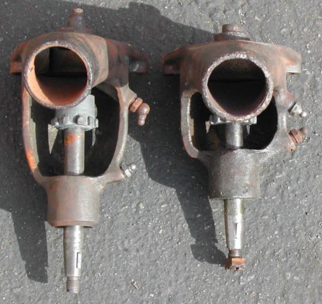

  19. Phil Brown
    Joined: Jun 24, 2022
    Posts: 37
    Phil Brown
    Found a pic of the differences in the water pumps, note the spacing between the grease fittings.
    How thick is the radiator core ? Heavy duty radiator ? Card1 043.jpg Card1 043.jpg

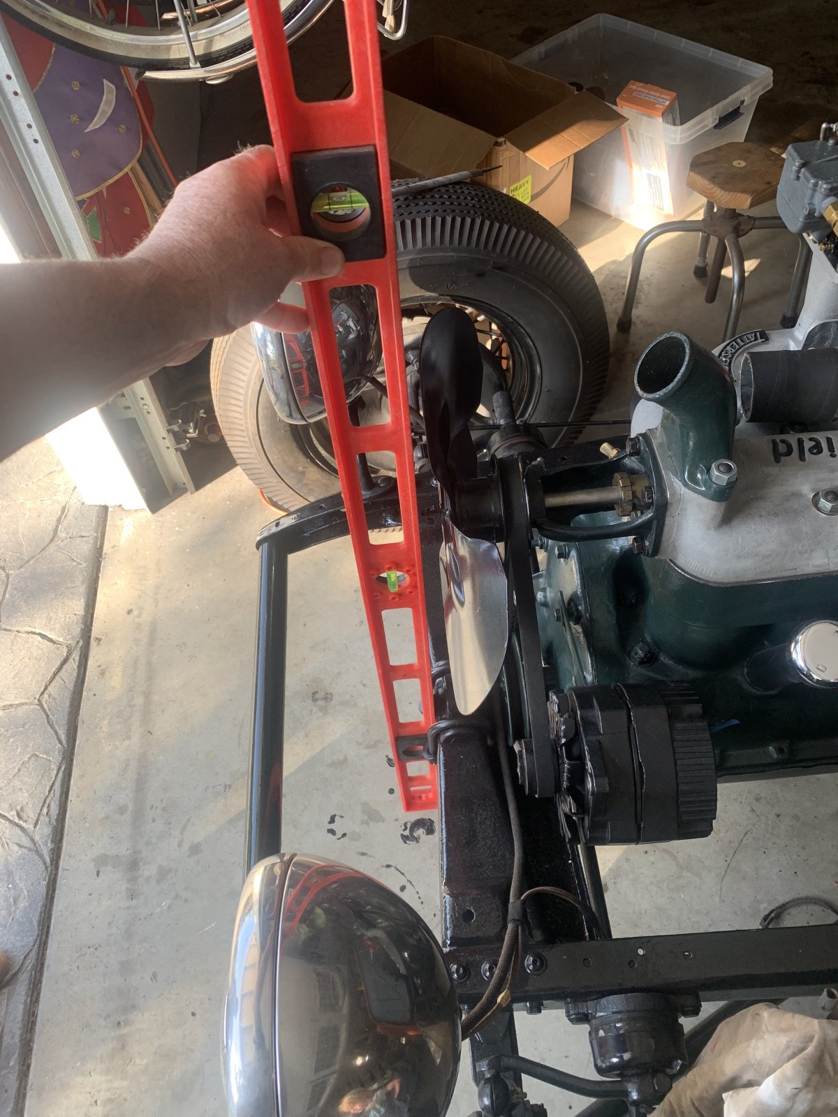

  28. DreamerJ
    Joined: Oct 3, 2021
    Posts: 134
    DreamerJ
    Sorry, I’m travelling this week and slow to respond. It’s an aftermarket 4 row, 2 1/2” thick aluminum radiator
  29. X38
    Joined: Feb 27, 2005
    Posts: 17,498
    X38
    Ah....well that may be significant
  30. DreamerJ
    Joined: Oct 3, 2021
    Posts: 134
    DreamerJ
    WOW!! My water pump is way longer. I just found this photo on my phone which I think tells the story of my problem. With the level vertical, on the front of the cross memeber, there is a very small gap between fan nut and level.
