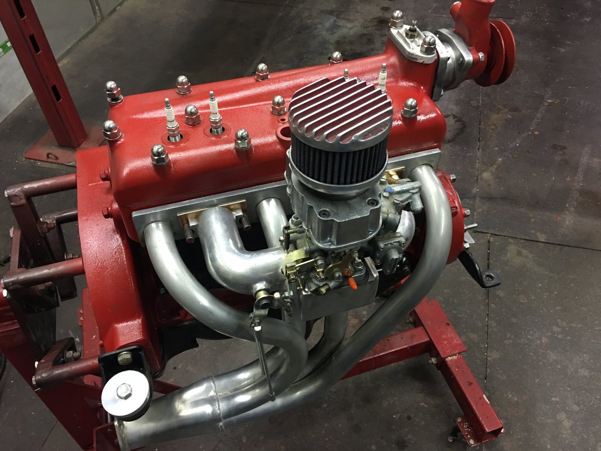

    This engine put out 60 HP at the rear wheels with a single Stromberg 97 (photo shows Weber 32/36). To put things in perspective, you can buy two SBC crate motors for the price of a building a good Model A engine. Go to something like a CRAGAR OHV head and you can buy a third crate motor! However, there is a certain satisfaction in doubling the HP of an 80 year old engine IMG_0062.JPG

    Obviously, checking the want ads here and over at the Fordbarn will give you an idea of costs. New, a Weber carb with intake, linkage and air cleaner will run $665. The FS complete distributor is $310 (an FS kit for your stock distributor runs $175). High compression heads range from $295 to $450. Headers are priced all over the place. Finally, you need to determine how deep you want to go into the engine. Inserts or Babbit? Probably the best money spent would be for balancing the moving parts and lightening the flywheel. Oh! then you need a V-8 clutch and on and on and on.
    I think that I would make sure the engine is sound first, balance it and then add the speed goodies as you go along.
