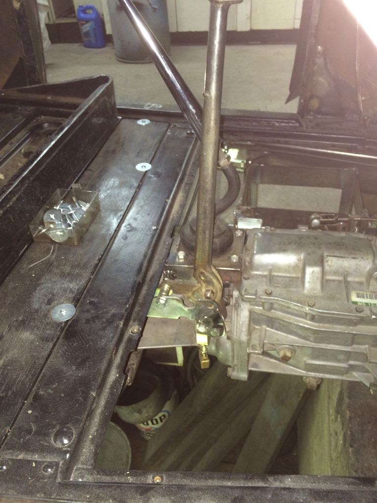

    @manyolcars It doesn't get into the seat but it came too close. I had to bend the shifter a bit to get it to work. I also moved my seat back 6". Fabbing a new shift lever would be necessary for a stock seat. A jeep T-5 is a bit shorter than the S-10.
