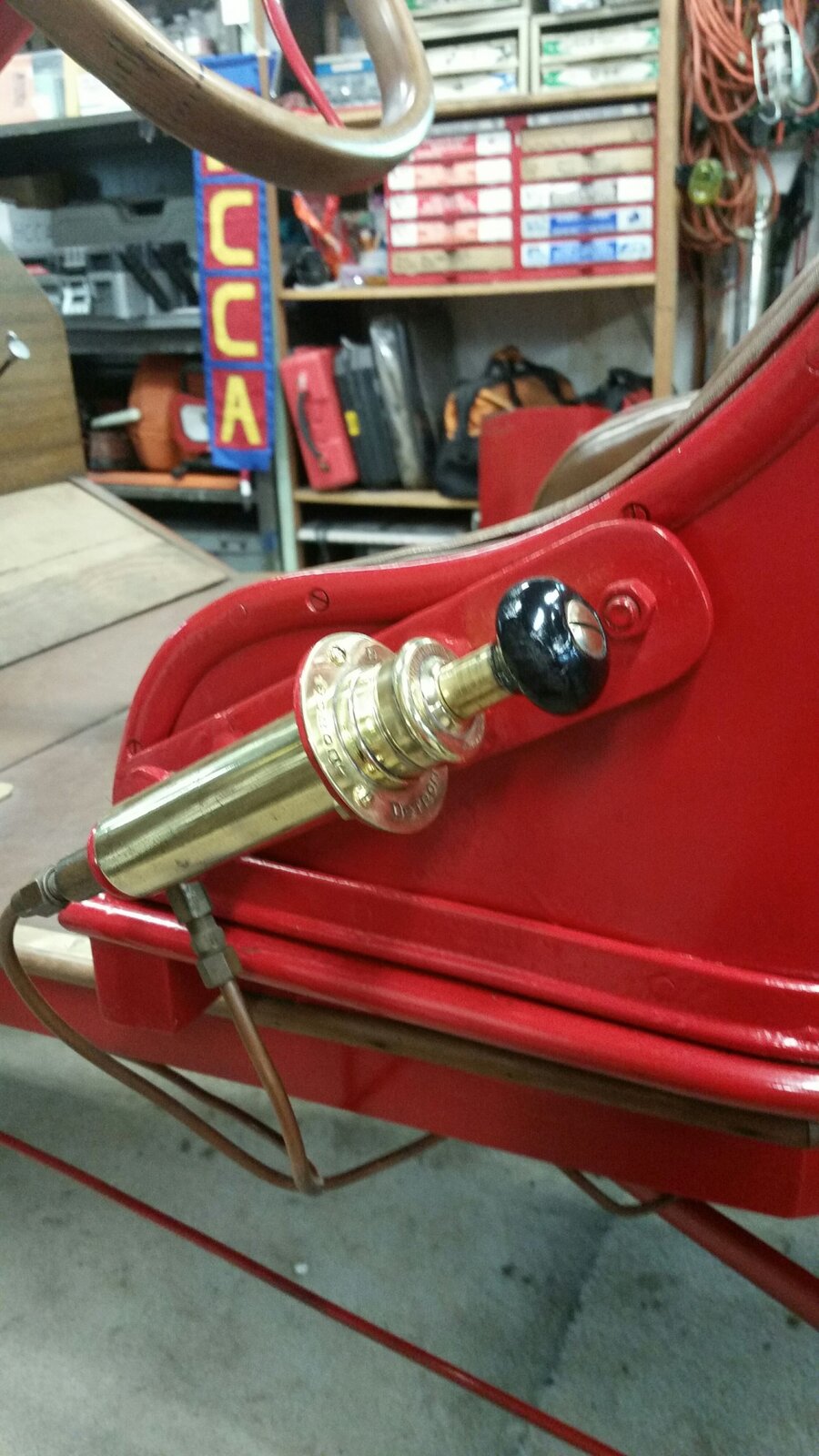

    speedster11.jpg Most sprint cars and hot rods from the 1930s use hand pressure pumps. A lot of cars from the 1920s and early 1930s use vacuum tanks. I am using vacuum tanks or hand pressure pumps on my cars. I do not own any cars with an electric fuel pump. I drive my cars in all conditions- 100 degrees, up hill, down hill, at speed and in traffic. Reliable, simple and you can fix them on the road if you need to. Hard to fix electrical stuff on the side of the road. Gearheads fix things and non gear heads replace things. When in doubt, K.I.S.S. always applies.
    Just did a 100 mile speedster endurance run in the 1915 Model T Ford-Rajo Speedster with an updraft, barrel valve Winfield carburetor. All I had for fuel delivery was this simple, 100+ year old primitive, old br*** hand pump. The outside temps were in the upper 90s all day and I ran the car at 50+ mph and very hard.
    Vapor lock? No.
    Hot start/Cold start issues? No.
    Fuel flooding, spark plug fouling? No.
    Fuel starvation? No.
    Fuel delivery problems? No.
    Time on the side of the road? 0.00 minutes.
    Some of the speedsters had electric fuel pumps and their results were significantly different. They were a blur when I p***ed them by.....
    At the end of the run, a few people asked about what kind of electric fuel pump I was running.
    K.I.S.S.
