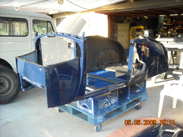

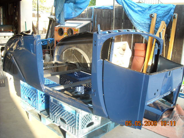

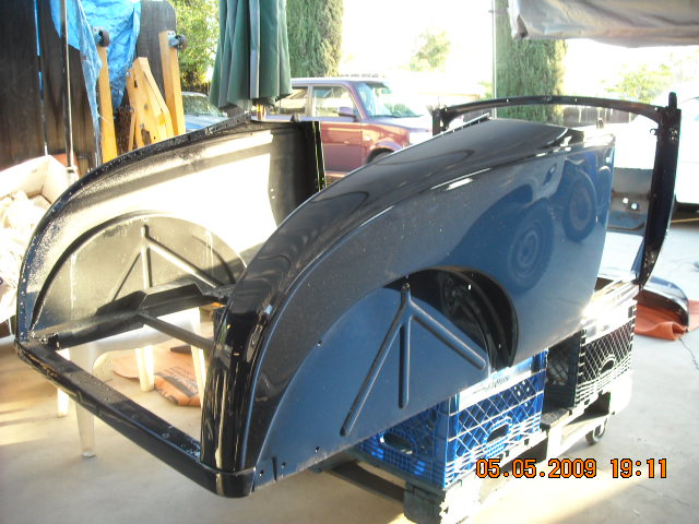

    Got the body back today :)
    Blue, blue, and more blue. The "other" Black!

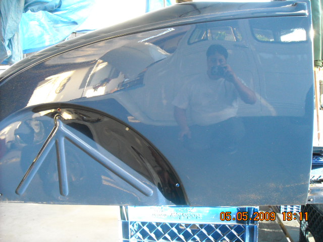

    For my 5000th post.... Back to the top, color sanding begins :)
