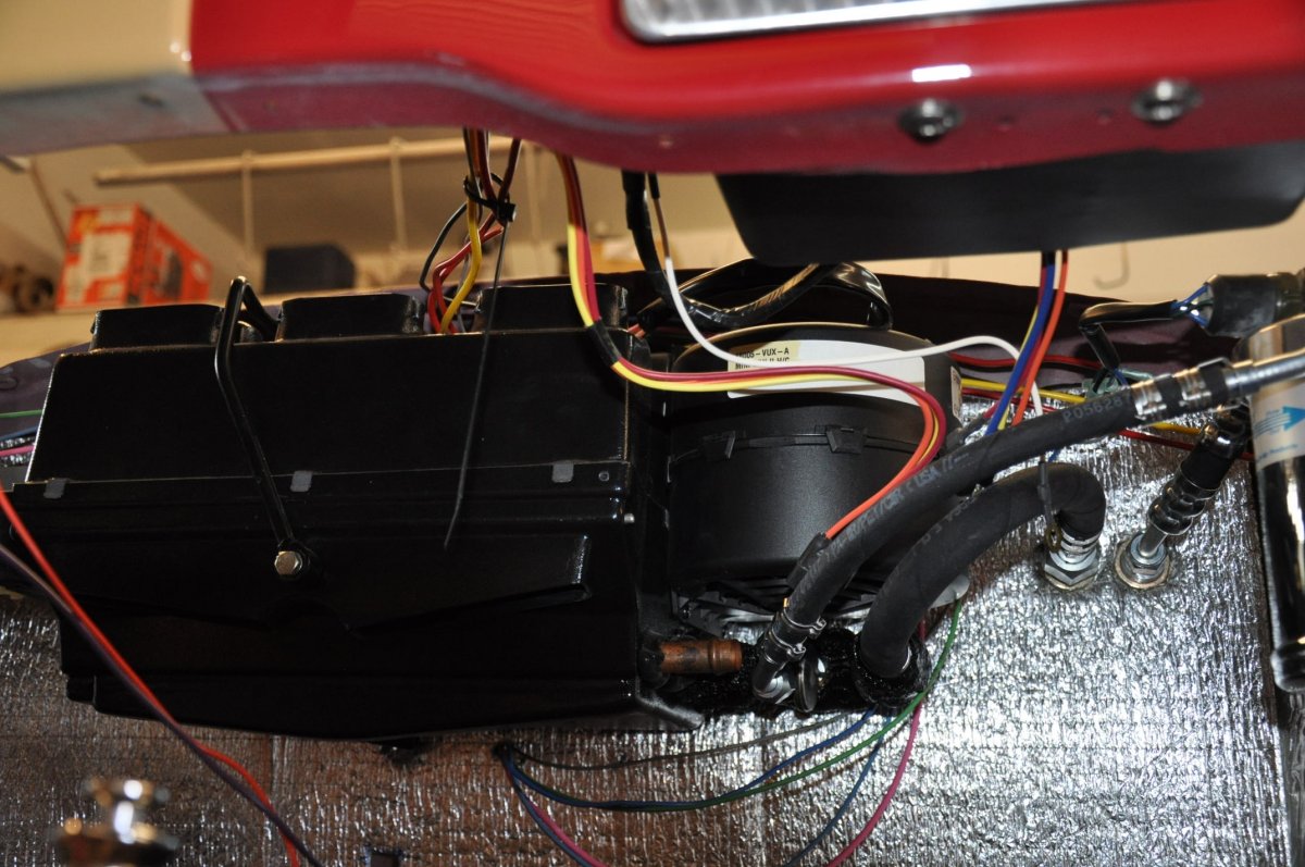

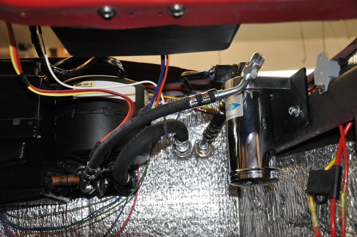

  19. fitznstartz
    Joined: Nov 28, 2012
    Posts: 21
    fitznstartz
    from mesa az
    I used a vintageair mini in my 30 pickup. Have a walker rad with condenser. Works great even in those 117 degree days we have here in Mesa Az. Mounted the compressor down low on my 302. DSC_0010.JPG DSC_0009.JPG DSC_0015.JPG
    AHotRod likes this.
  20. oldsman41
    Joined: Jun 25, 2010
    Posts: 1,556
    oldsman41
    Fitznstatz if that will fit in a pick up I’ve got it made in the coupe
