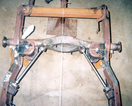

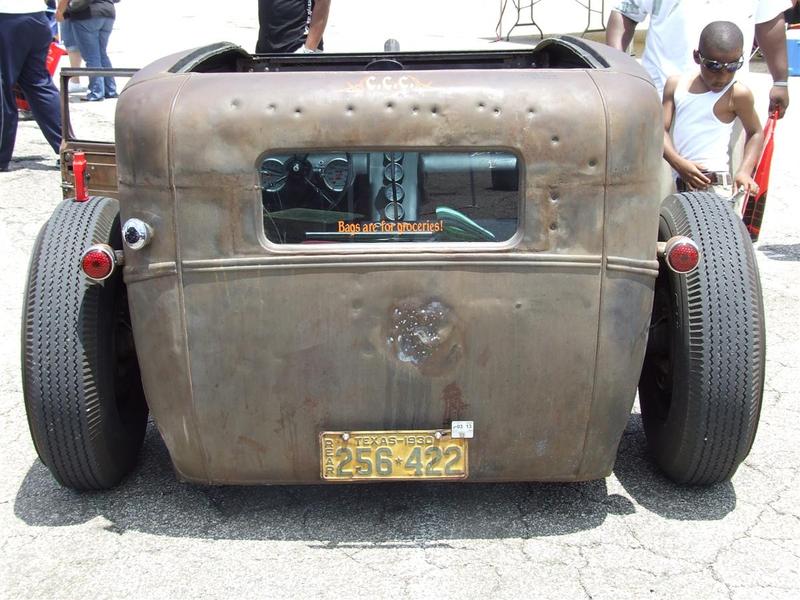

    Von Rigg Fink: Here are some photos.....
    On my '27 RPU I put the air bags in front of the rear axle and built a triangulated 4-bar set-up. This gives a very clean look from the rear of the car.
    The first photo is a build shot where I was mocking / fabricating the rear suspension.
    The second photo is of the finished set-up. You can also see the sway bar in this picture. I used sway bars front and rear. The car handles very well.
    I agree with Ned Ludd about air bags working well on a light vehicle. Since my roadster is very light the air bags work very well. As I stated earlier I also have a Model A with coil overs, The Model T with the air bags rides like a dream compared to the coil overs.
    I hope the pictures help.
    John

    I'll fix this for you:
    Look in the small lower corner,and if you need to,click on the image,then enlarge it:
