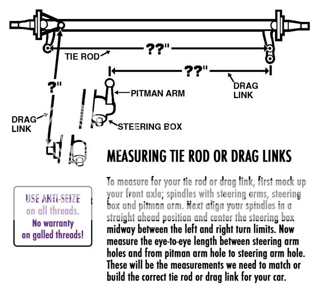

    You can get a litttle adapter that goes tapered end to model a style. i used a 42-46 tie rod as well i think.
