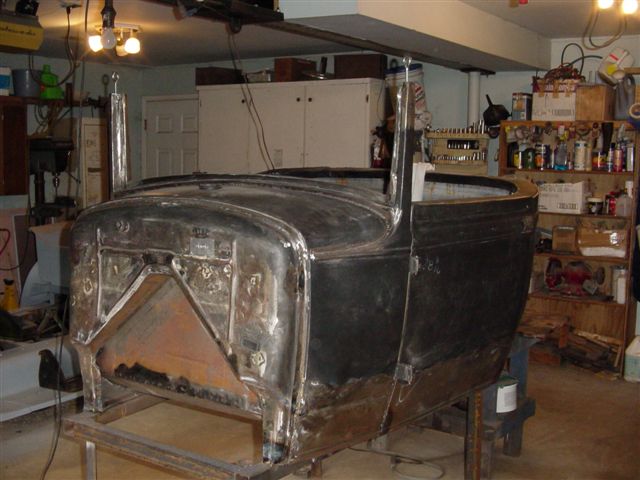

  5. I am not sure what you do and do not have with your model A cowl. When I built my steel bodied model A roadster pickup (by cutting down a 2-door sedan body), I too had to figure out how to attach the cowl/body to the frame and to securely attach the rear portion of the body to the frame so it wouldn't flex and pinch my arm at the juncture between the top of the door and the rear of the body. The body has a set of sub-rails that the actual body panels all attach to, and the sub-rails bolt to the frame. On mine, the sub-rails were very rotten, and the cowl-posts were rotted off and not attached to the sub-rails anyways. Also, when I shortened the body (moved the rear of the body up to become the rear of the cockpit), the attachment to the subrails was "iffy" at best. To address all of the above, I made a pattern from heavy cardboard, and cut out a full floor from 3/16 steel plate. I then bolted what remained of the tortured sub-rails to a perfectly flat framework which I had built, at a comfortable working height. The steel plate set on top of the subrails, and extended all the way to the front of the floor where I wanted my toe-board to start,and all the way to the rear of the moved up back-section of the cab, and all the way to the door sill on both sides. I squared up the body, shimmed the door-gaps to where they should be, braced everything, then fired up my trusty mig, and welded the whole damn thing together. (stitch here/stitch there/move around. I then built a toe-board and did the same. I then built 2 humongous gussets to run from the rear cab section down to the floor/door-sill area on both sides and stitched them into place. I drilled thru the floor plate and the sub-rails at the 4 corners with a 5/8" drill,(2-places each corner) and inserted a peice of hollow tube which was 5/8" outside x 5/16" inside thru the holes untill it stopped at the supporting frame below. I cut them off flush with the inside of the floor plate and welded them into place. They became my "bolt thru" tubes for two 5/16" bolts at each corner of the body that went into the frame mounts on the model A frame.

  9. tock
    Joined: Apr 24, 2005
    Posts: 24
    tock
    Maybe this pic will help.
    You could use 1x3 steel tube instead of purchasing the sub-rails.
