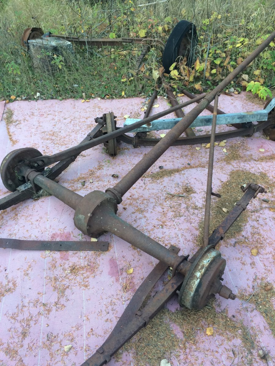

  24. Wrench666
    Joined: Oct 26, 2017
    Posts: 212
    Wrench666
    IMG_0331.JPG well we got a bunch of snow last nite so it took me awhile but I found this pic on my comp
    Any thoughts on what it might have come out of
  25. Off somebodies trailer, they added the leaf springs and that's a pipe added to the torque tube for the tongue. Bet you, there is not much good left in there.
    Blues4U likes this.
  26. Wrench666
    Posts: 212
    Wrench666
    Ahh. That makes sense. Thanks
