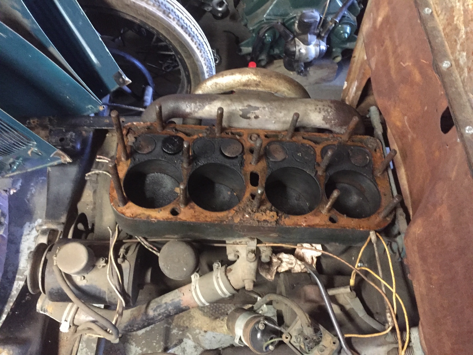

    Finally got some more time to work on it. The head was really on there so I made a puller
    I smashed the ceramic out of 2 model A spark plugs and welded a carriage bolt to it. I wanted to put the bolt through the plug, but that ceramic is really tough.
    And the final result

    I like the head puller solution. I am thinking you had one of the old steel gaskets. They rust and stick like crazy.
    Did you get the dizzy out?

    Distributor is out. Still won't turn. Looks like I'm pulling the timing gear
