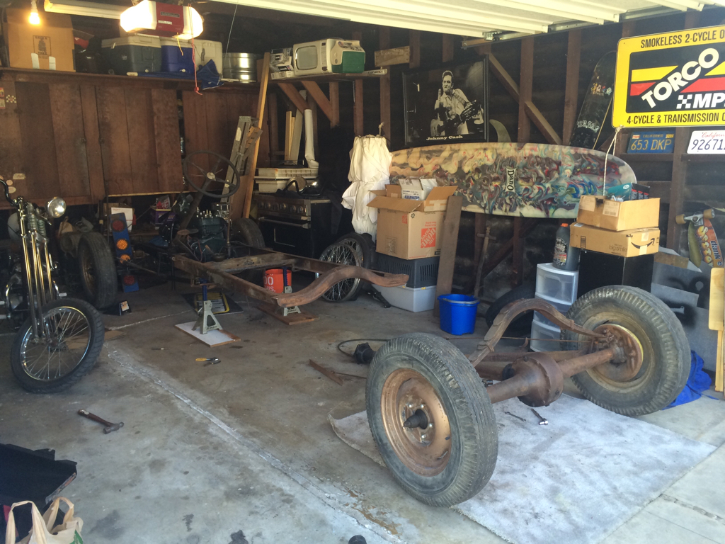

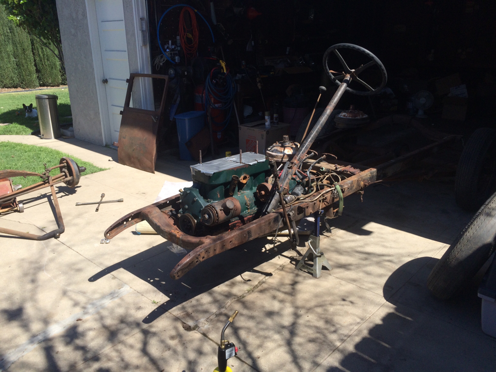

    Got the front end off today. Waiting until my patience comes back before I try to get the 4 broken head studs out. Been soaking them with PB blaster for a week. ImageUploadedByH.A.M.B.1426363669.470189.jpg ImageUploadedByH.A.M.B.1426363683.433483.jpg

    After many failed attempts it's time to take the old rig to a tap and drill shop. Will let you know the results. This weekend I plan on reassembling the motor so more pics to come. ImageUploadedByH.A.M.B.1427347545.258010.jpg

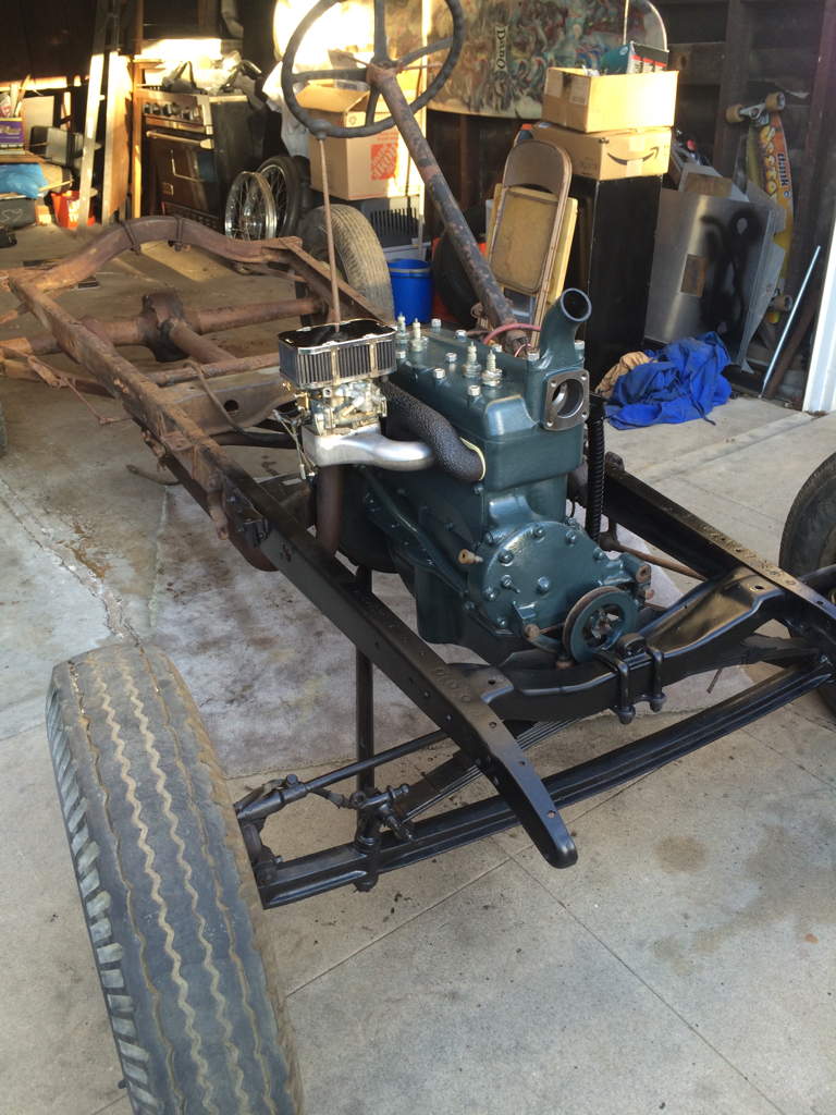

    Got some work done yesterday. Painted the motor, and installed the intake and exhaust. ImageUploadedByH.A.M.B.1428984816.449271.jpg ImageUploadedByH.A.M.B.1428984840.411718.jpg

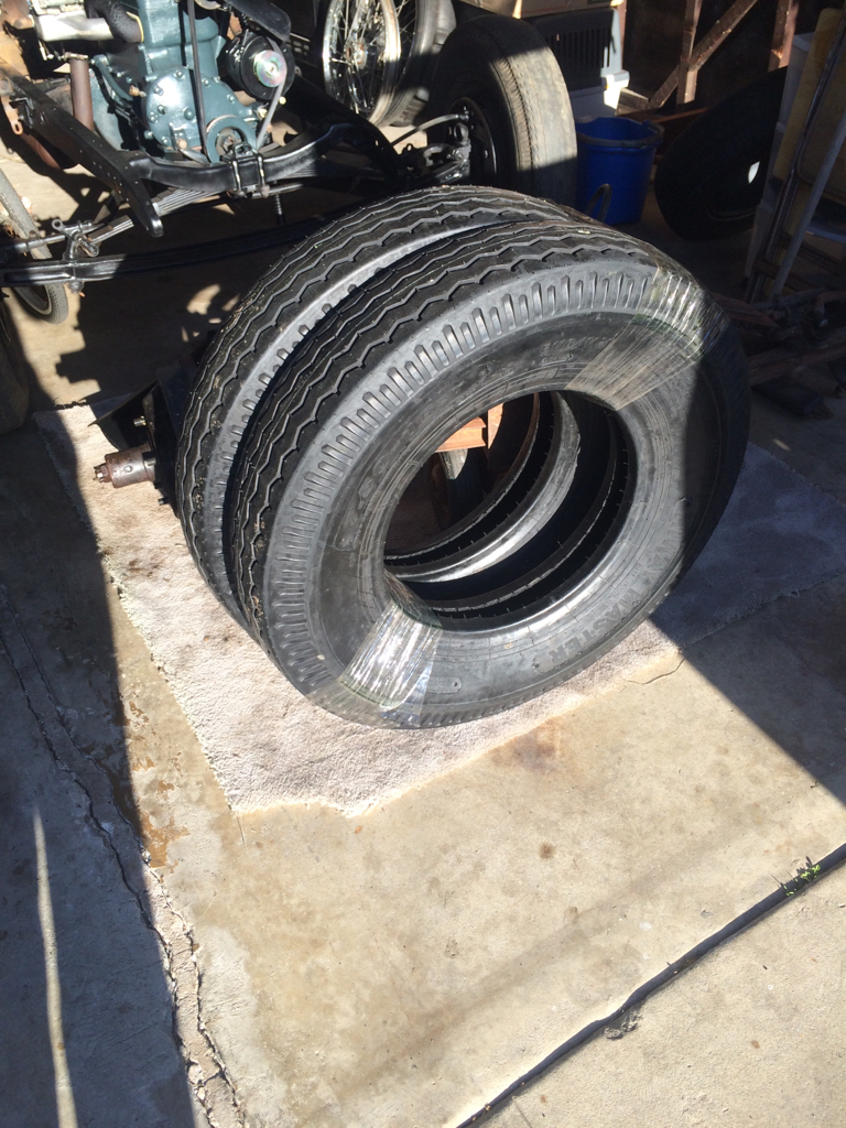

    Got myself a birthday present. Ordered a couple 7.50-16's for the rear. $200 shipped to my door. They are Hiway Masters. Hopefully I get my distributor back soon so I can get this baby fired up. Will let you fellas know how they work once it's on the road.

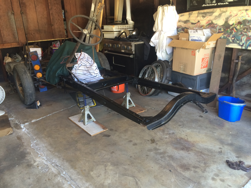

    Primed and painted. Now onto the rearend. ImageUploadedByH.A.M.B.1430600835.428718.jpg

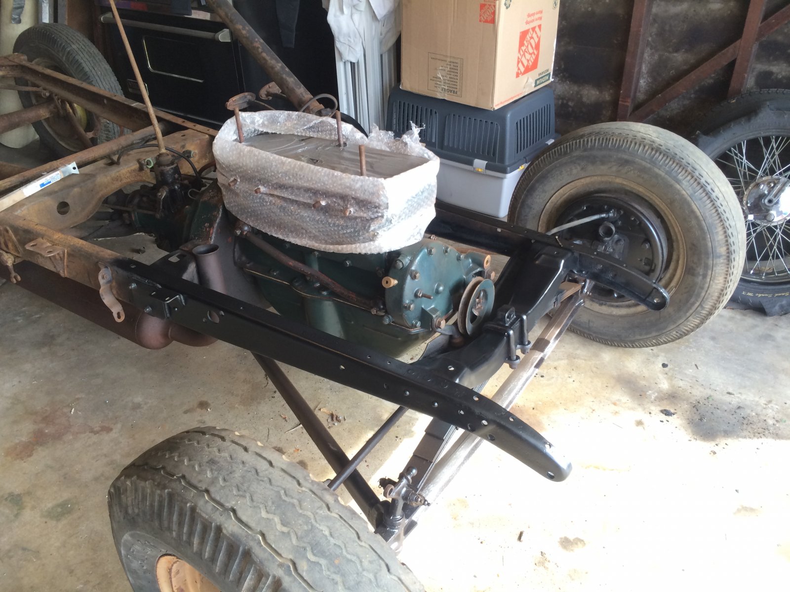

    Dropped the trans and pulled the flywheel to have her lose a few pounds and put a V8 clutch in it. ImageUploadedByH.A.M.B.1431572363.252309.jpg
    Didn't foresee myself doing all this work when I bought it. Might as well do it right the first time around.
