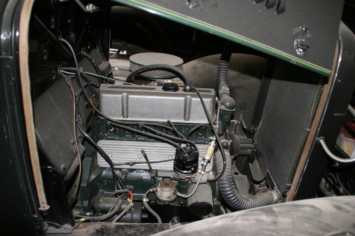

  1. Actually I was thinking about the hood sides. The manifold looks like it sticks out quite a ways from the block but it could just be the camera angle.

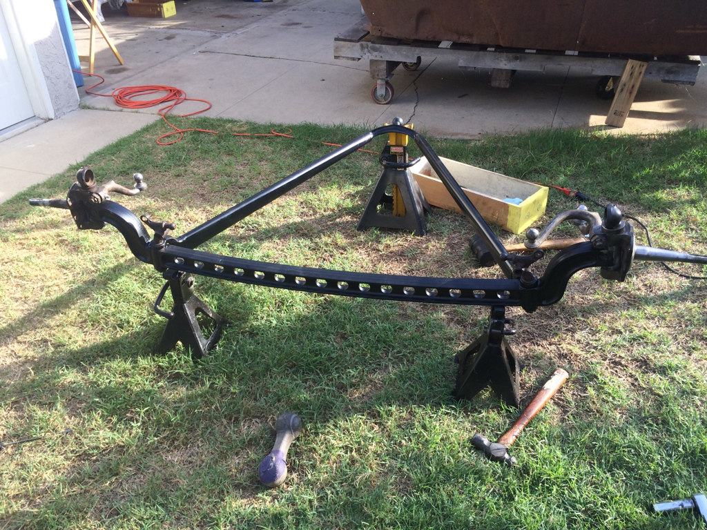

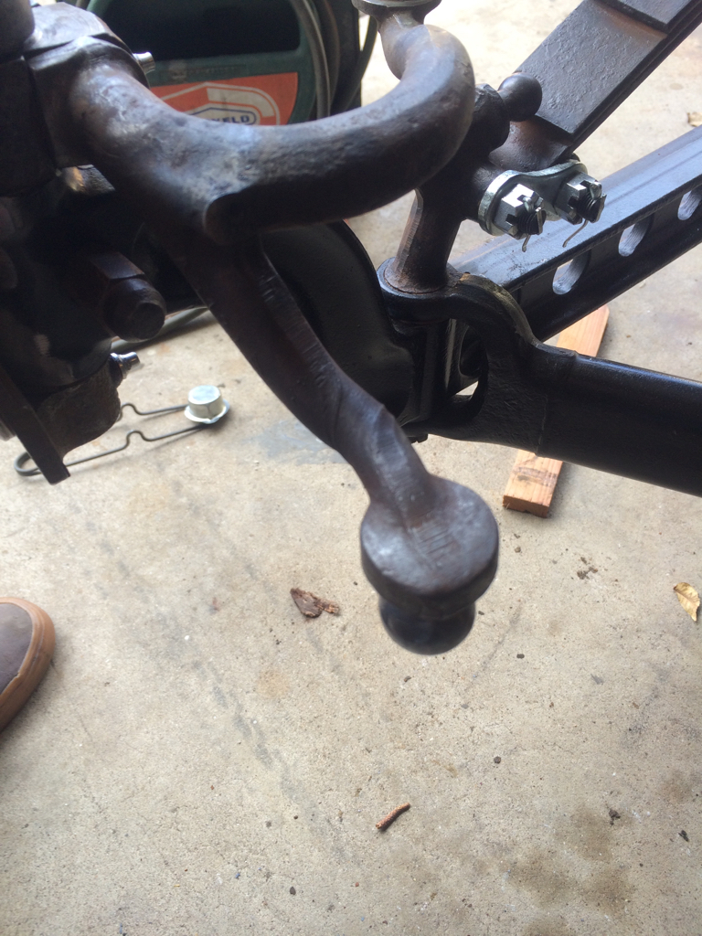

    Got the spindles all cleaned up. Took a few hours to get them presentable. ImageUploadedByH.A.M.B.1444671213.561662.jpg

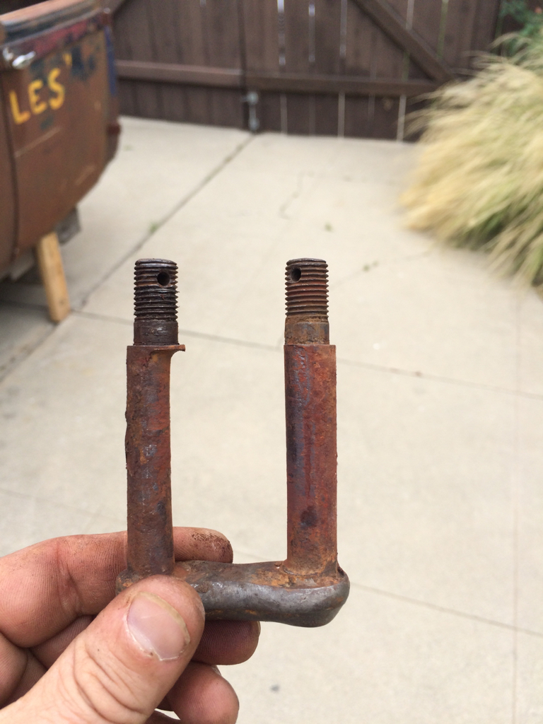

    There is quite a bit of talk over on Fordbarn about the spring shackles. Apparently the best LOOKING repro ones

    I bought mine from mikes-afordable in Georgia. They are they only ones I've found that are made in the USA and authorized by Ford. I hope they are better than the import ones!
    Edit: Just checked a similar product packaging in my garage, and they are through Snyders, and are an officially licensed Ford Product. They do not look exactly like the originals however since they are factory authorized, they should be solid. I will let you guys know if they break or start to wear prematurely.

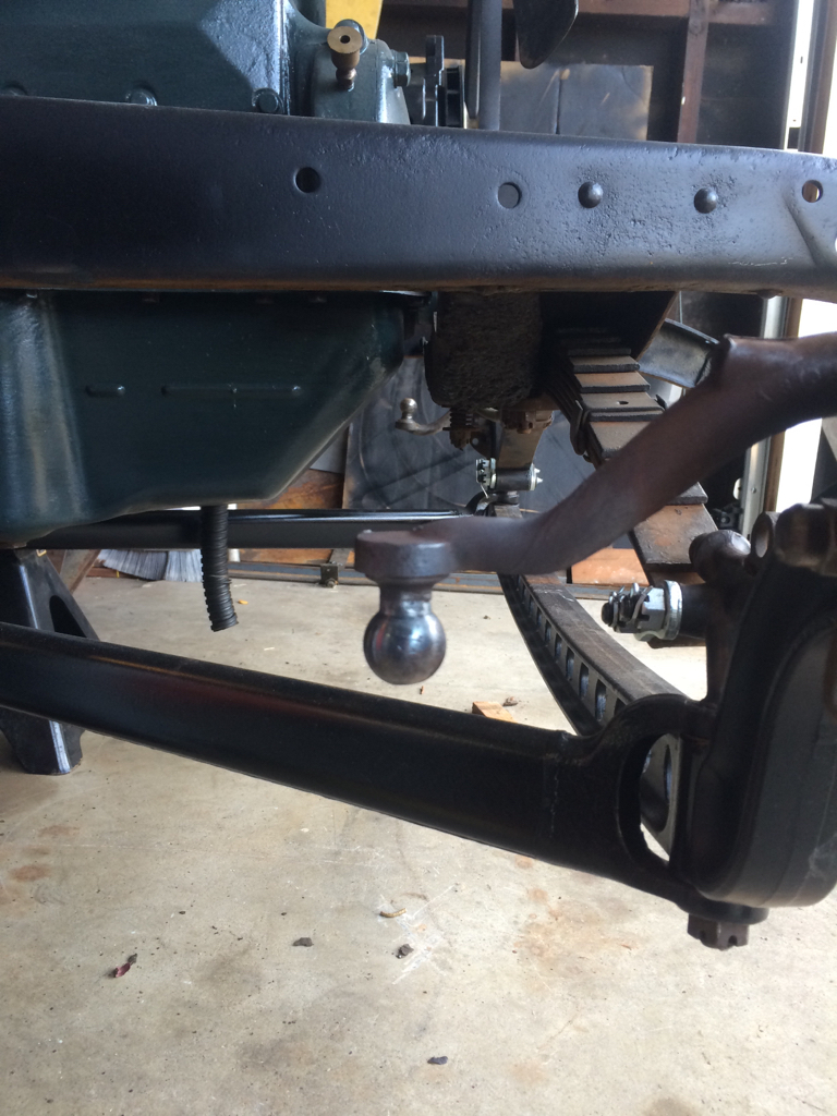

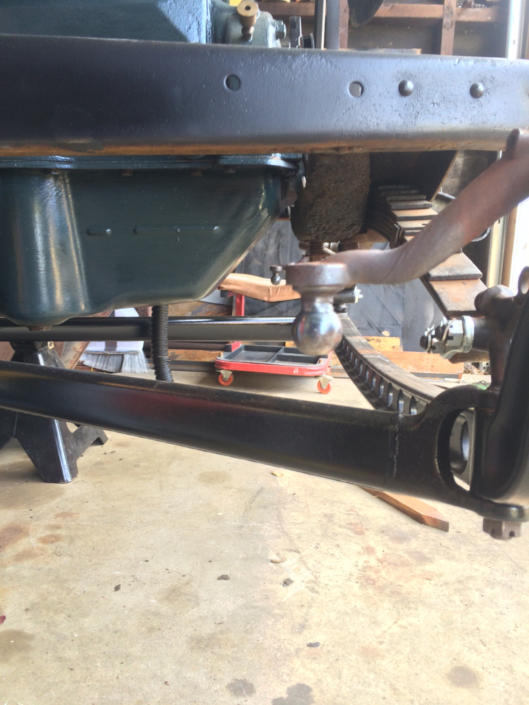

    Spindles on, nice and tight. It would already be under the car but I discovered late last night that I received rear shackles, not front ones in my order. Patiently waiting for the man in the brown truck... ImageUploadedByH.A.M.B.1445727977.171894.jpg

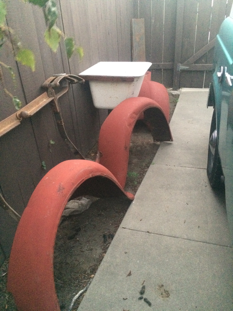

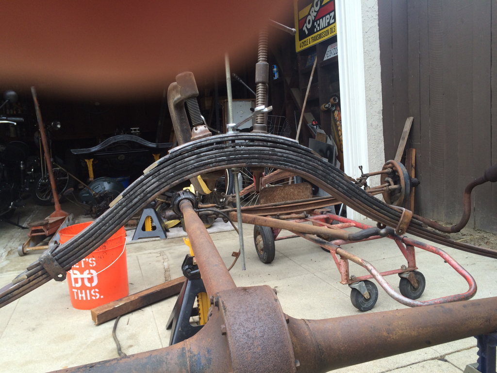

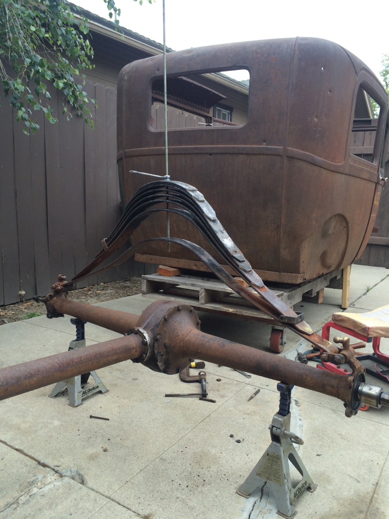

    Parts haul from yesterday! Looks like I will have a full-fendered rod. What do you guys think? Fenders or not? ImageUploadedByH.A.M.B.1447006590.004245.jpg

    I keep going back and forth on the fenders. Here is what I came up with, NO chop = fenders, chopped = no fenders. But then I seen Shanes '28 with the chop and the fenders and it looks awesome so I am still unsure. I know you don't really need that back seat either so I should come take it off your hands so you have more space in your garage.

    @ROCKER77 hahaha that back seat is staying with me, but thanks for the offer. I'm thinking no chop and fenders. That may change though, a 2" chop may look killer if I can get my car to sit low enough. @Charlie Stephens What motor is that? Pinto? It's a good looking roadster. I like the green.
  23. Motor in post #110 is a 181 cubic inch Mercruiser with a 153 passenger car head. Currently the GM Industrial engine. The is a lot in the archives on this engine. Bolts up to an early Ford transmission with a standard speed shop adapter designed for the SBC. Clears everything and won't tear up an original rear end. It is nice to have to use an extension on the fan to get it to fit instead of having to cut the firewall.

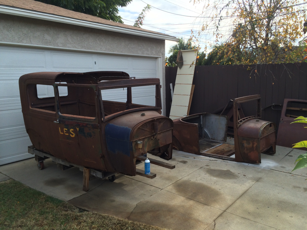

    Might need to change the title of my build... Picked up a really solid sport coupe body. I'm thinking I may chop the windshield and door tops 4" and I'll be on the road. I need to find the B pillars and rumble seat hinges because they are missing.

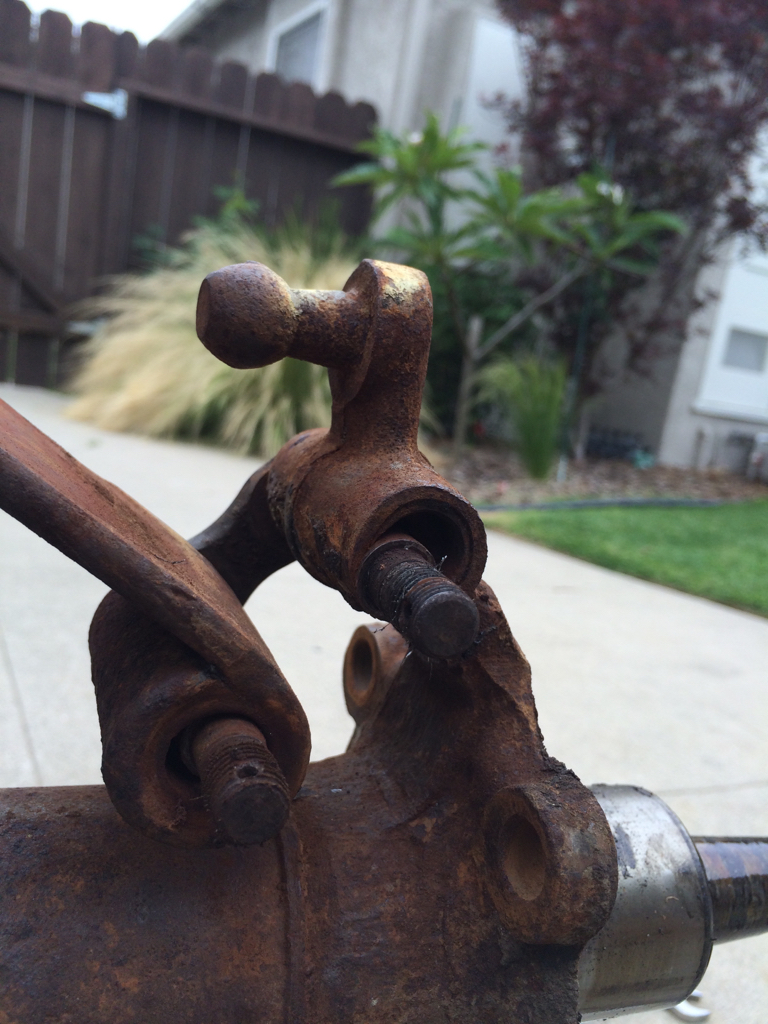

    Working on the front end completion today. Bent the steering arms down this morning. One done...
    Second one done...

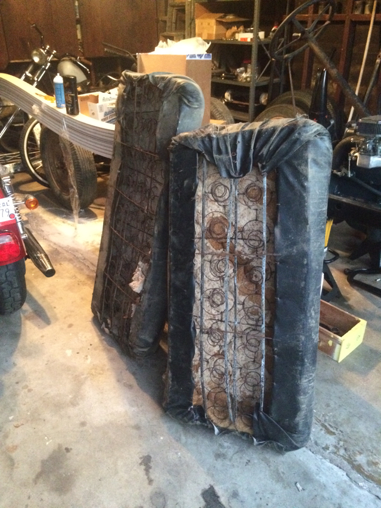

    Kevin since your gonna run the coupe body surely you wont need that rear seat anymore, You should let me help you clear some space in your garage and take that off your hands for you!!
