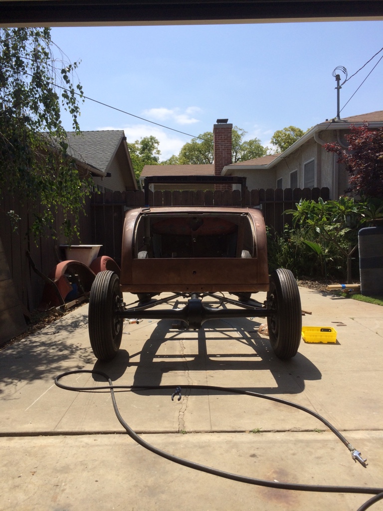

    She's in the weeds now! Feels good to see it back on its wheels. Plumb the brakes next and throw the body on it. ImageUploadedByH.A.M.B.1451262344.848690.jpg

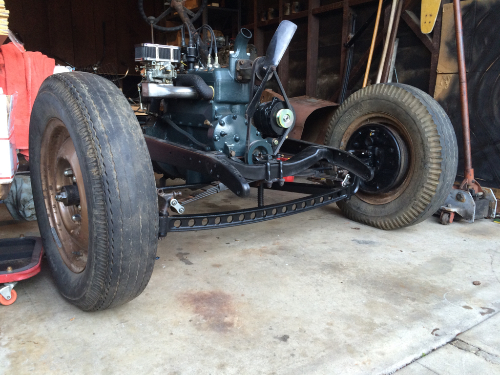

    F1 steering box and a VW bus mount mocked up thanks to @NealinCA

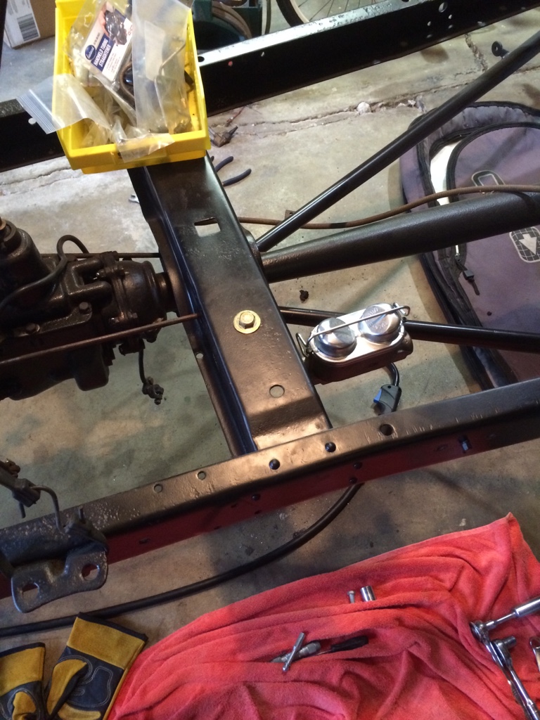

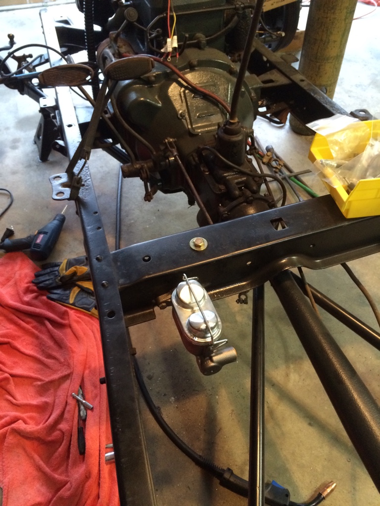

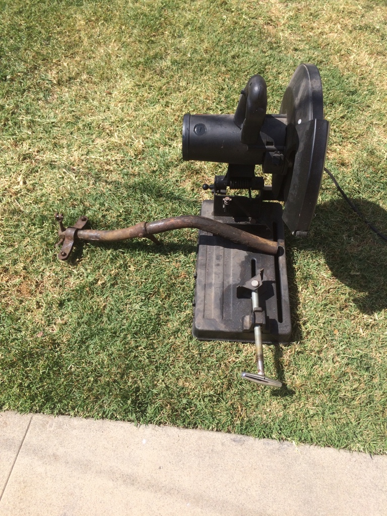

    Got creative with the master cylinder mount. I cut the end off a stock mechanical brake cross shaft.
    And it will be placed like so...
    Had to heat and bend the arms so the pins were parallel. Drilled a half inch hole to run a bolt through it.
    Mocked up with a simple support so it doesn't wobble.
    And voila!
    I had to move the master cylinder over so it wouldn't hit the trailing rod.
    Here's a couple of shots from underneath. I cut up the stock brake rods since they already have adjusters and I'm a broke. May be tech-week worthy...

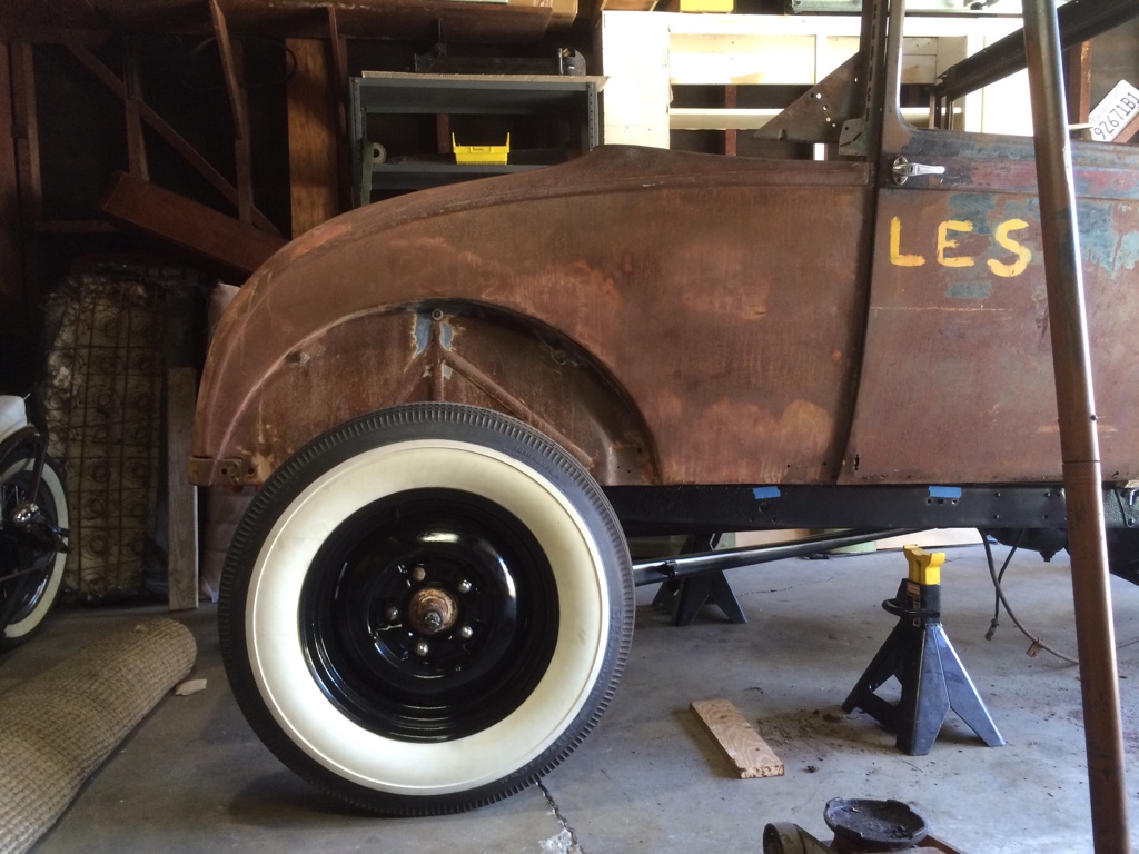

    The rear spring was so stiff that even when I would jump on the rear crossmember it would only compress about 1/2". It was just too tall as well. I cut a few of the springs a put them under the pack. Hard to tell from the pics but it dropped about 1 1/2" and now compresses enough to feel like a car.
    More pics of further progress tomorrow.

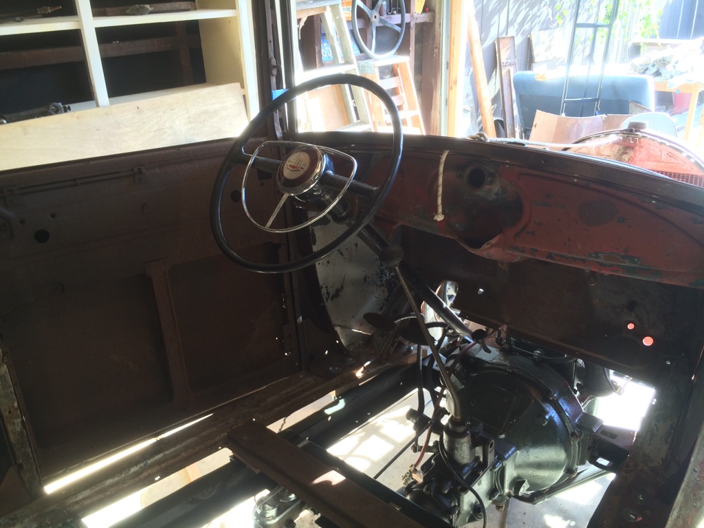

    Got the F1 box in with the VW bus box mount. Had to shorten the drag link an inch.
    Got the 31 A steering column bracket all dialed, and the '50 Ford steering wheel on.
    I will be getting the seat riser, visor and a few other parts tomorrow so there will be plenty to do this week. Stay tuned.
